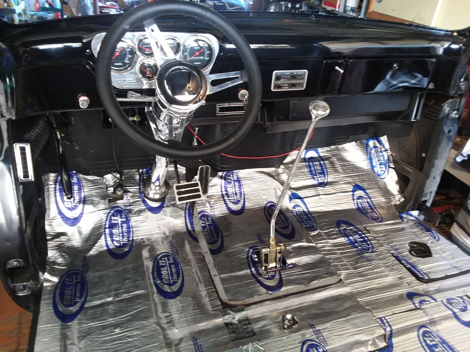

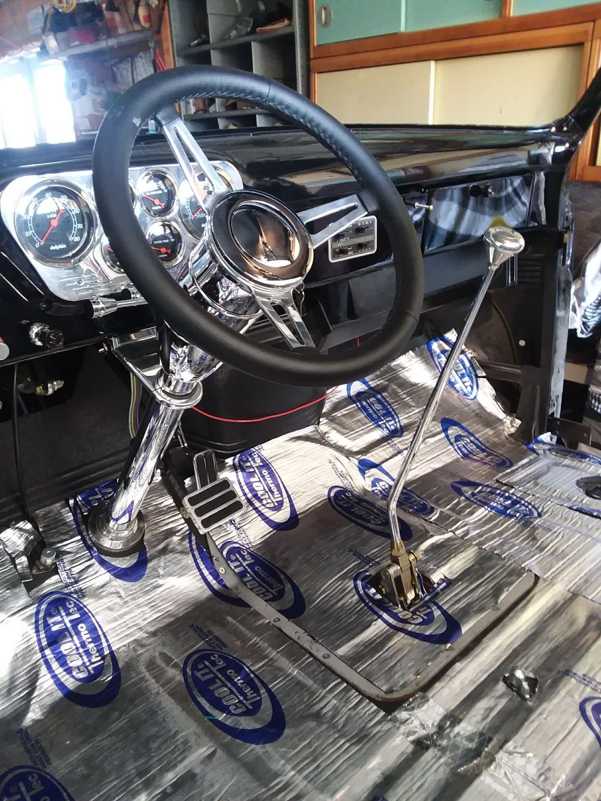

Shifter
I use them only thing I do not like is you cannot fell the detent in the shift-- here is the one I have installed now--

shifter
I think because the shift handle is so tall you do not get that CLICK--DETENT noise in each gear like a B&M shiftier-- will never miss a gear because you have to push the safety button in to shift--they do look good and are quality build--
