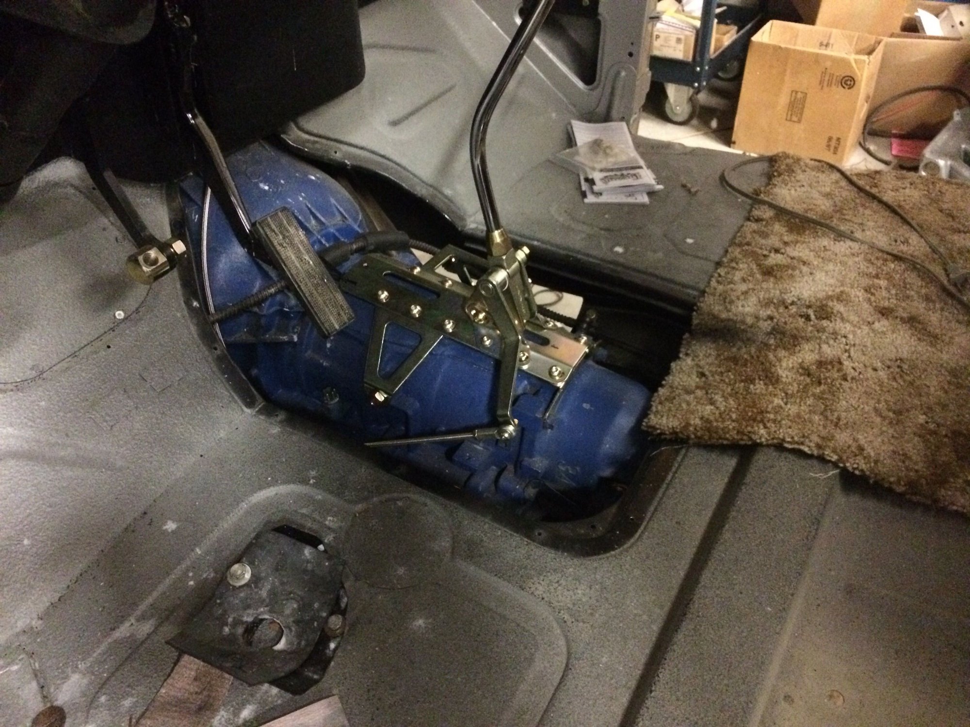

I went with the Lokar. Love it. Good luck!

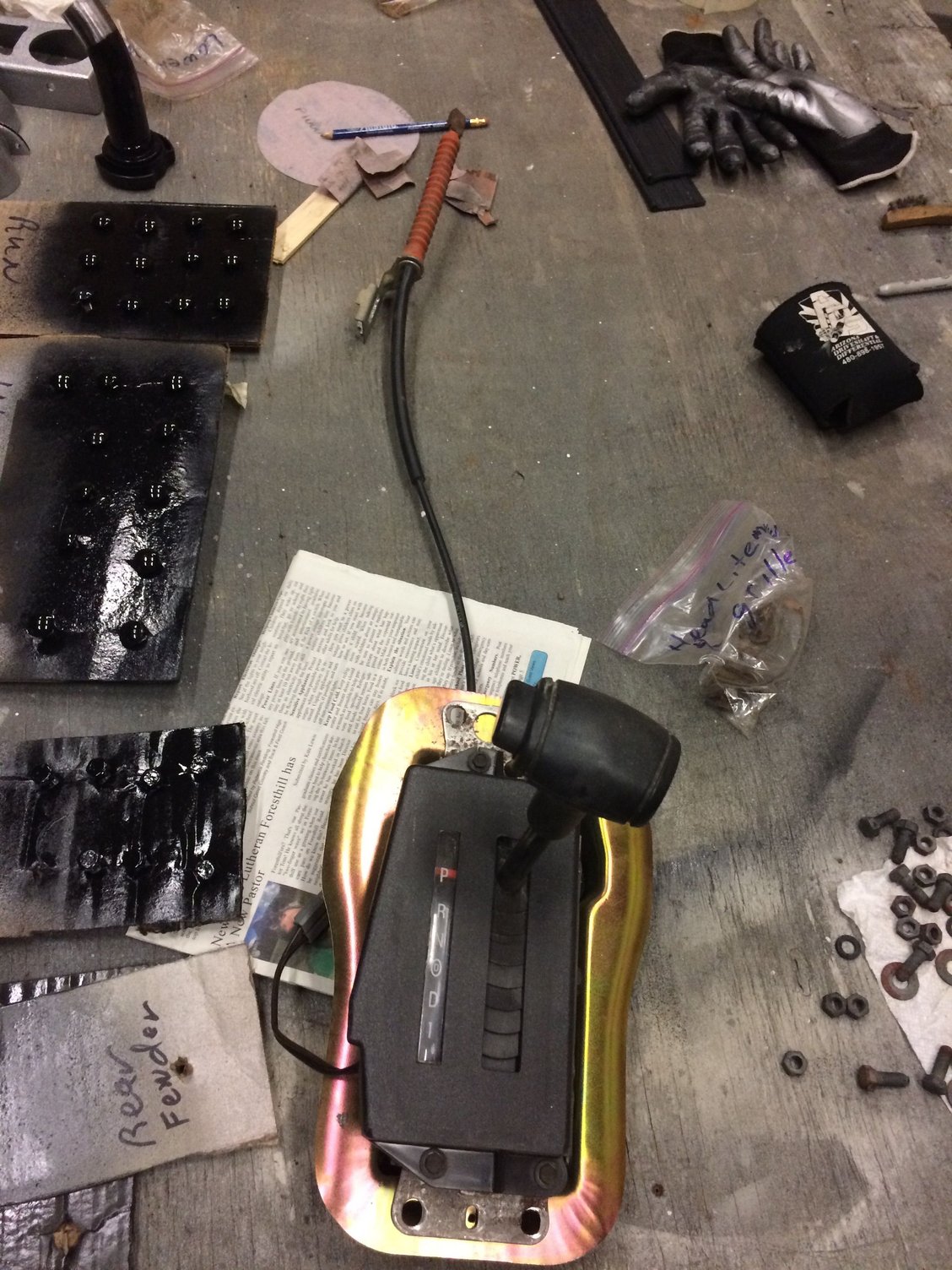

I should have said it's an aod and I have a shifter from a aerostar van which with a lot of modifying I think I can make work . But I am quite amazed that there are so few aftermarket shifters that will work and was just wondering if my searches have missed something or there are some other salvage ones that can be modified

Cool... My current on looks like Yamagrant... I also hits my bench seat when shifting into 1st (My trans is a Turbo 350)

Yes I understand that but my budget build is rapidly [ NOT ] . I have to continually make decisions on time needed to modify and make things work or buy stuff that someone has already done the work on and this is part of building anything custom . I really was just curious if I had missed any aftermarket options or someone had come up with a salvage one that is better than my idea . The aerostar shifter is already 12" high and I believe extendable without a great amount of fab work ,but needs to be modified form a 4 speed auto to an AOD shift which I have already done

Absolutely tip I have all intentions of trying to make mine work first but thought I would throw it out there in case there was something I hadn't thought of , in my short time on here I have adopted numerous ideas that the great people on here have been kind enough to share
