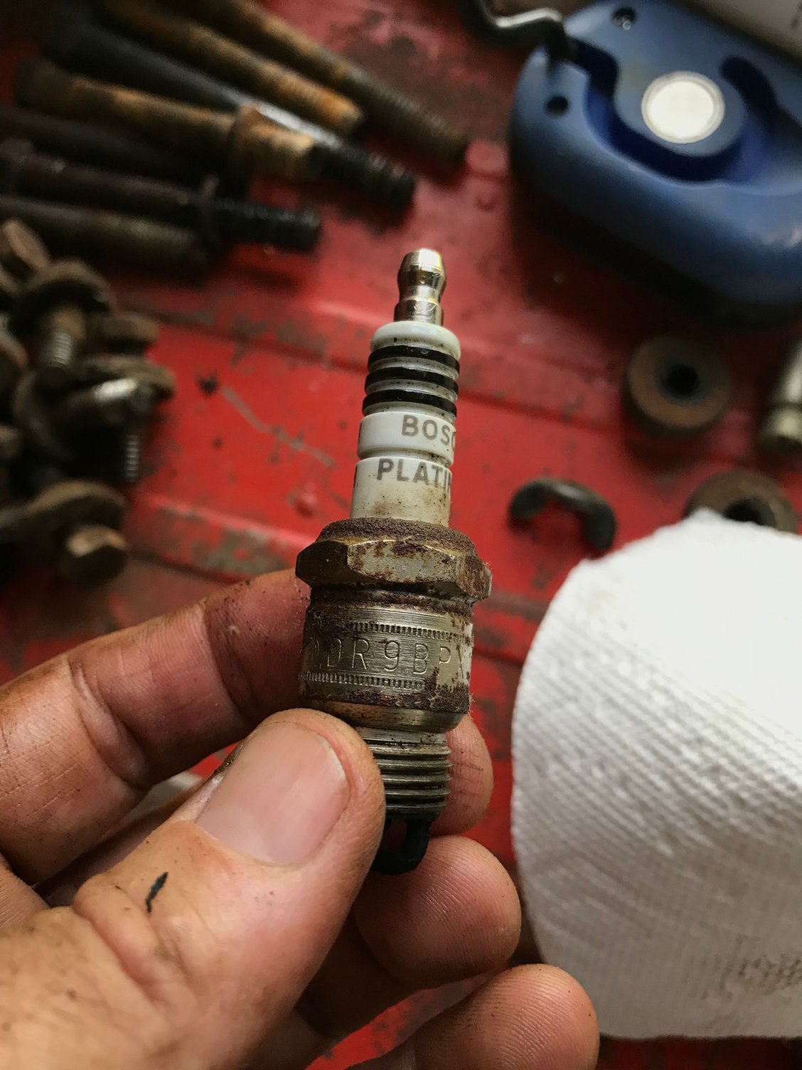

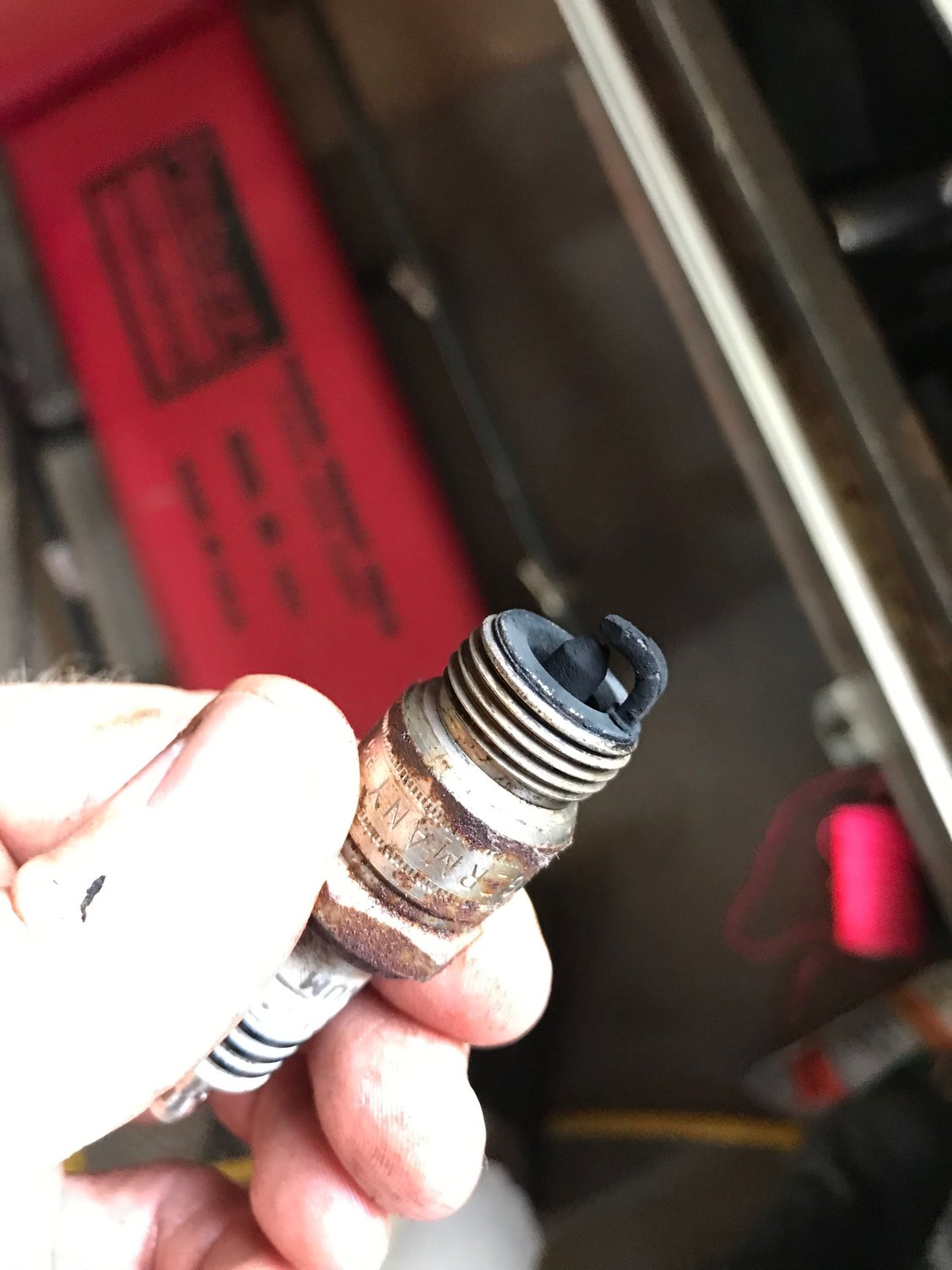

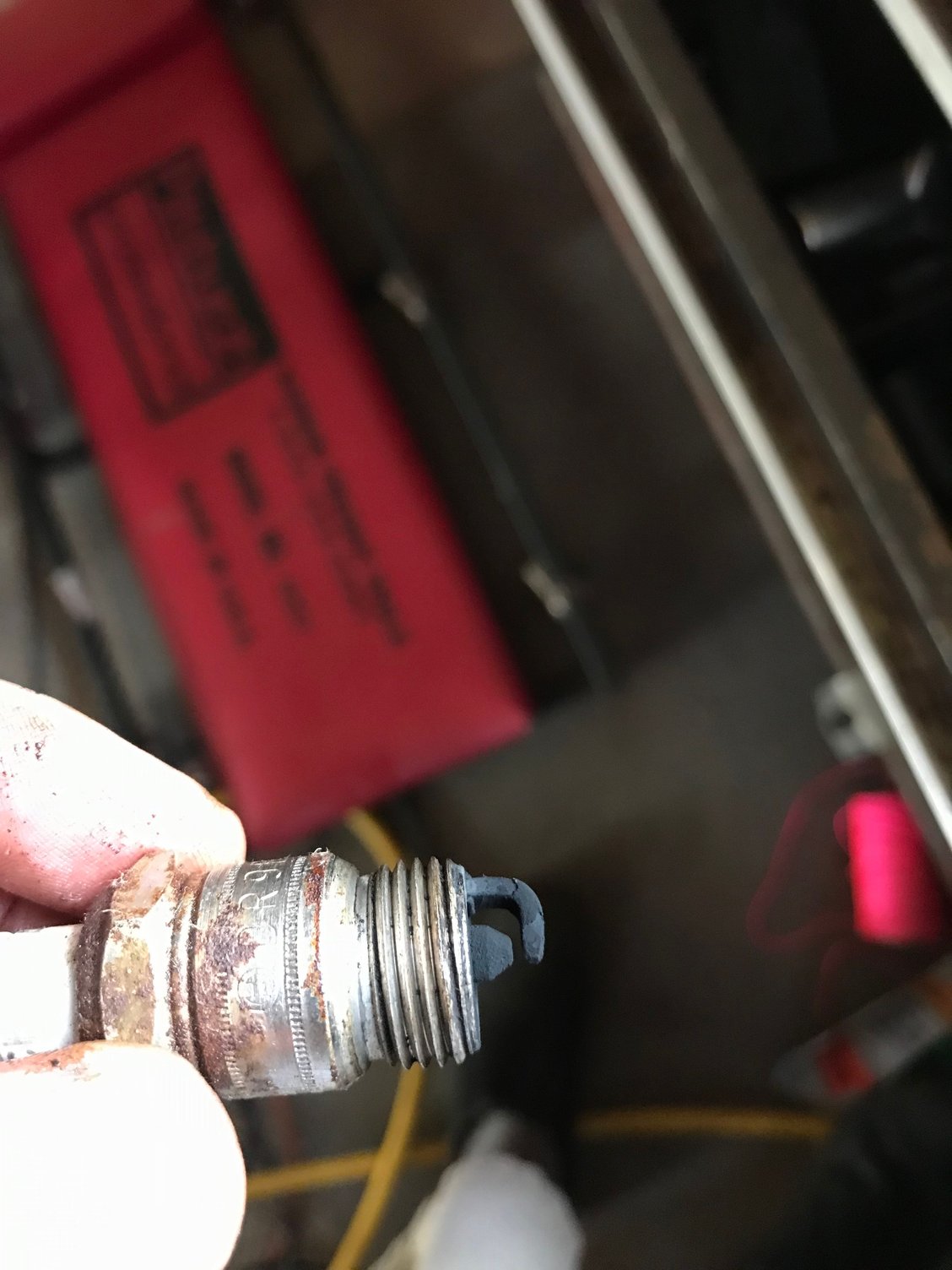

I poked around a little in the replacement engine. Below is a pic of the #1 spark plug. All six looked exactly the same. Running rich? Burning oil? Incorrect plug?

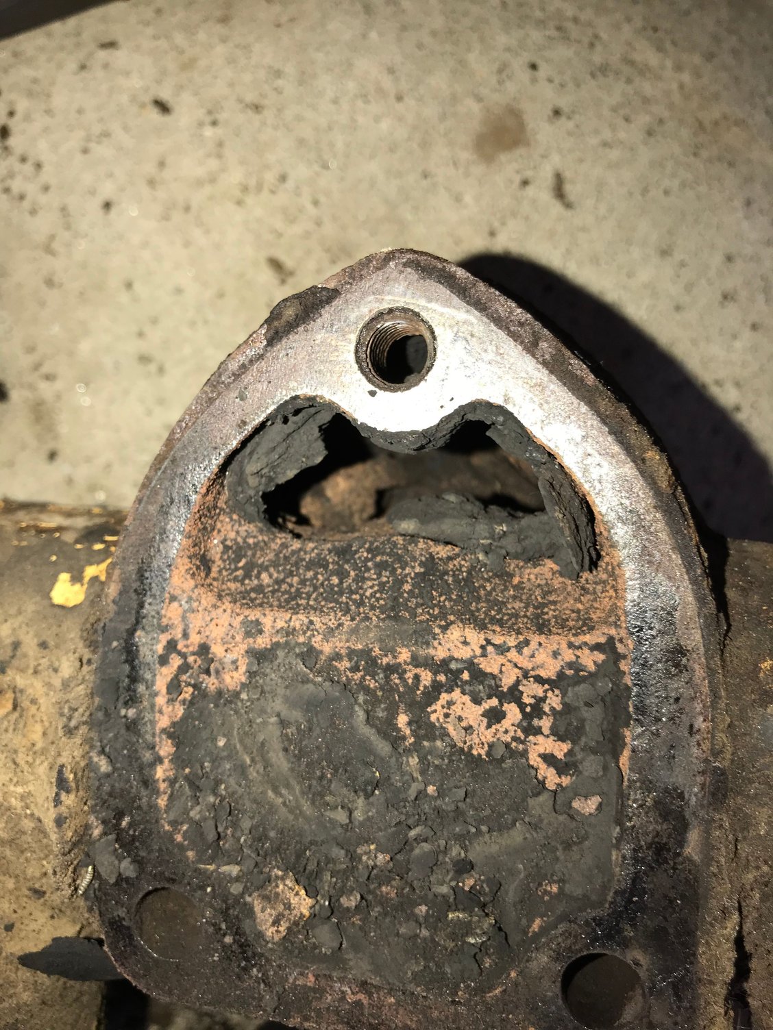

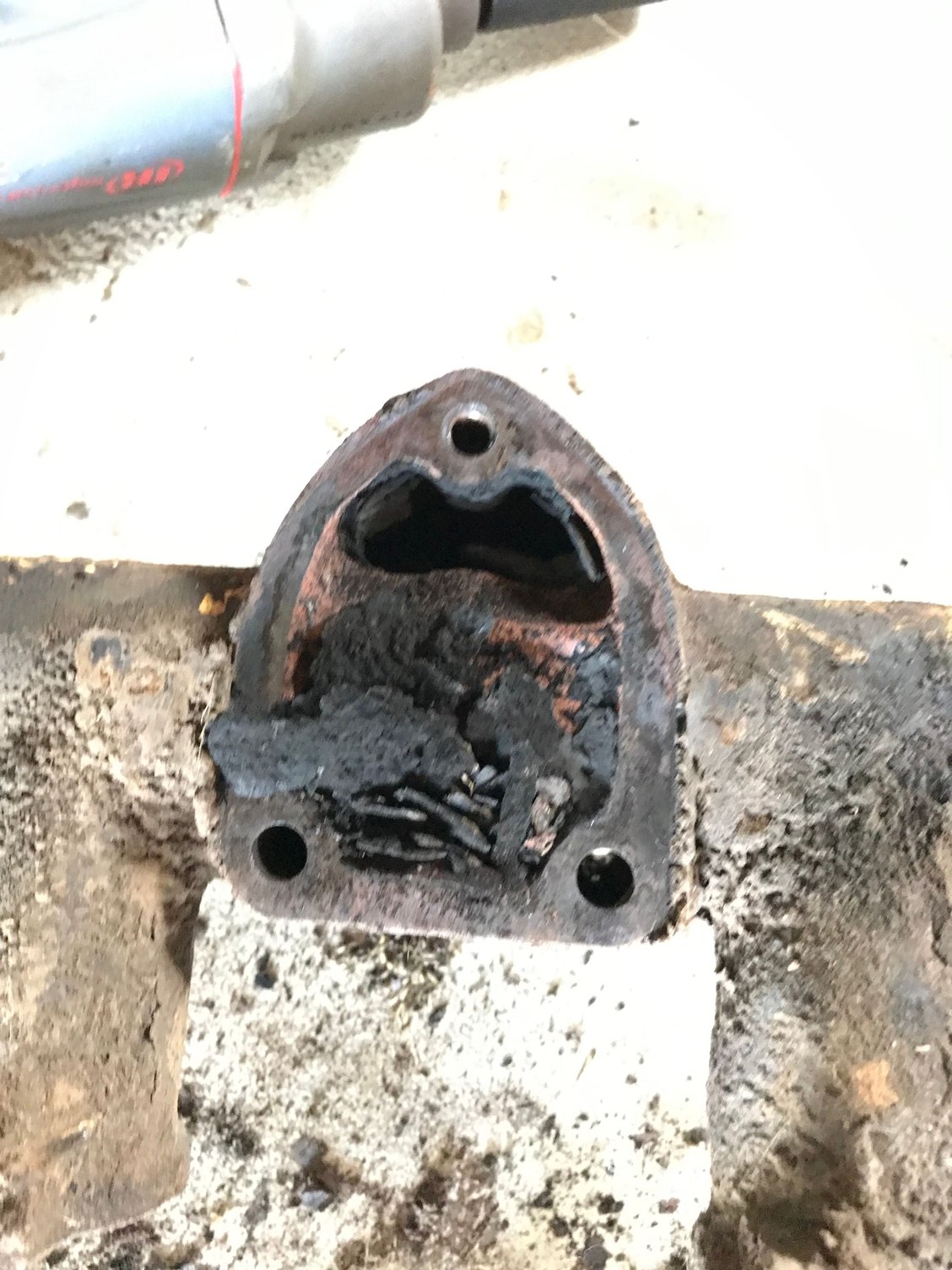

I took the intake and exhaust manifolds off the old engine. Even when it was running I doubt it ran very well. Look at all that carbon!

Definitely hardened seats or don't even bother with head rebuilding. Shop around for somebody interested in your old motor. They are out there. Rage and I can't even know if your motors ever saw unleaded fuel which would have eaten it alive. Lasting until they killed lead completely around 1973-74 actually would have been a good service life. Old Ford haters we are not. They did what they could with current technology. These old engines wouldn't last long on clean gas without help, and clean gas is what you are going to run her on.
Regarding the carbon. Sure it could have been running rich, or just running like trash for a year because valves and seats were at the end of their life and were leaking. Leaking valves = bad vacuum and a carb can't work properly. Add in chokes that open too slow, thermostat stuck open. This really is just speculative engine forensics because we weren't there.

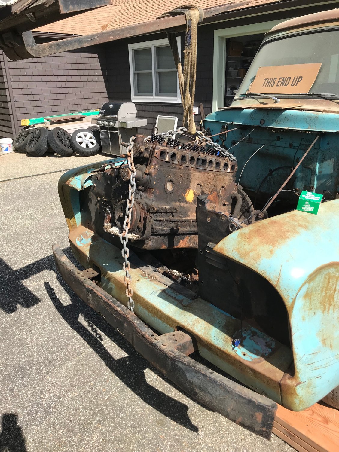

I don’t mind spending $500 to do the head over as long as it doesn’t lead to a $3k rebuild.
now the update that I am sure you have been eagerly awaiting.

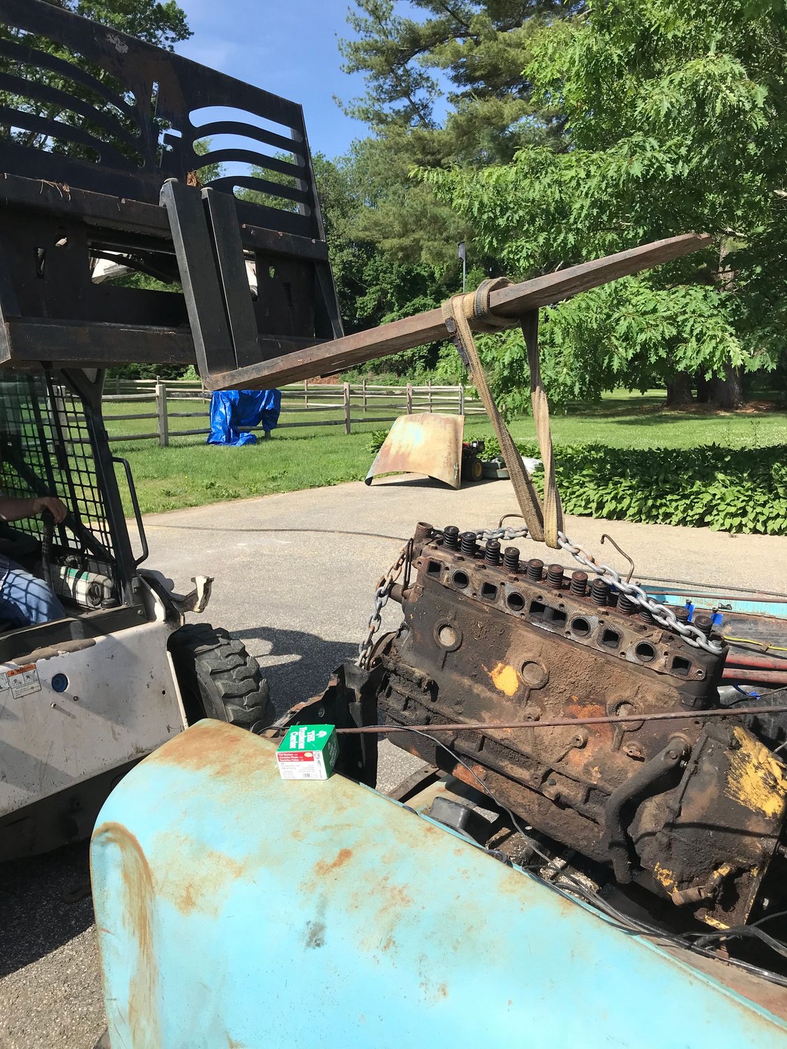

The engine came out without event for the most part. Got a little hung up on passenger fender well and put a slight bend in the lip but a little dolly and hammer and it will straighten right out. Some action pics below.

I assume that was a cold compression test? Those aren't horrible numbers for an old low compression engine. It doesn't have any valves completely torched out of it yet or you wouldn't have 100# compression. If it were mine I would pop the head as 'rage suggested. I would also pull the oil pan and look for surprises. I would probably end up installing rings and inspecting the main and rod bearings. Rings and bearing won't make it a rebuilt motor without machine work but it highly increases your chances of knowing approximately what you have and improving oil pressure. You don't have to buy parts before you give it a deeper look. I'd do this mostly because I would be afraid I'd get it all together and it would have 10 LBs of oil pressure. Yes any disassembly could open a can of worms and you don't have to do everything I say. Whenever you don't drive the donor engine around you are faced with choices. You could just bolt the head back on with new seals if it isn't cracked and drive the motor around. There is certainly a chance you'll end up pulling it back out but you might get some miles out of it and figure out what you have without dropping much coin. By pulling the head you can have it checked and get a good look at the cylinder walls. That's worth some peace of mind with no real investment but a little time before you make decisions.

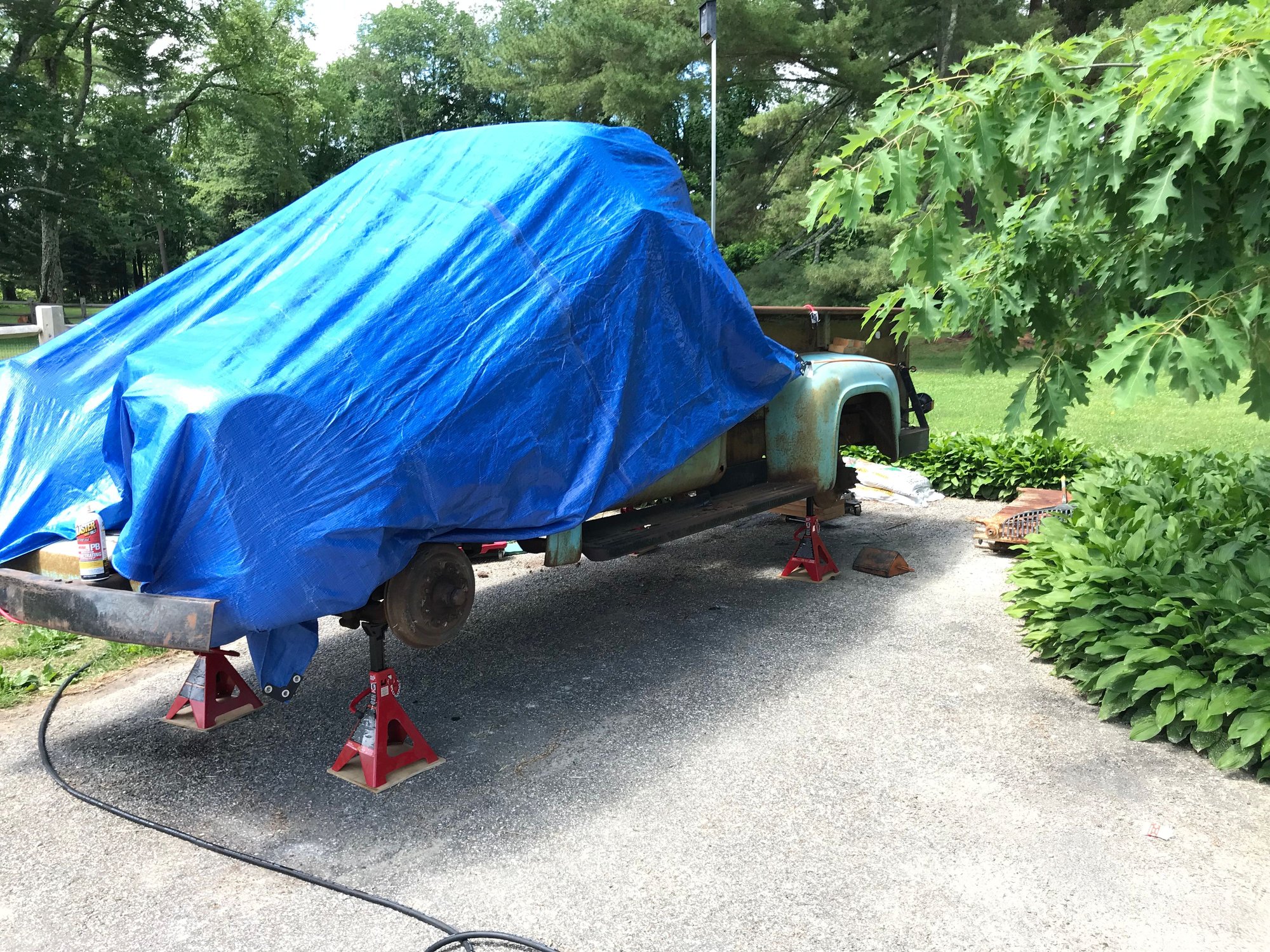

Progress staging for the next wave of work. Truck is outside and way up on jackstands for easier access. Plenty to do in the garage on the replacement engine when it is raining or too dark to work outside so I am in good shape.
starting to remove brackets and other items that will benefit from sandblasting or need some heavy duty cleaning. Also preparing to clean and polish the existing firewall and prep the truck for undercarriage sandblasting.
I am going to try something unconventional painting the undercarriage. I am going to use a Linseed paint I found online that looks very promising and easier to apply with the body still on the frame. This is also what I am going to finish my bed with when I replace it or maybe pine tar.
