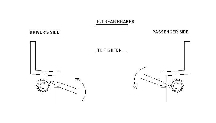

Originally Posted by 8pack
the wheels do turn freely but I suspect the adjusters are frozen!
Which way to you spin the adjuster in the event they are not frozen. Not even sure where it is as I never thought about that. I am done under the truck for the day but can look tomorrow.
I am going to go the patient work to get them off. I am not in a hurry as there are plenty of other things to do. Plenty, plenty, plenty.
I don't know it the F100 is the same but I found this among my saved pics
Old Jun 16, 2021 | 12:31 AM
8pack's Avatar
8pack
Joined: Sep 2018
Posts: 1,528
Likes: 534
Thanks!! Great visual.
