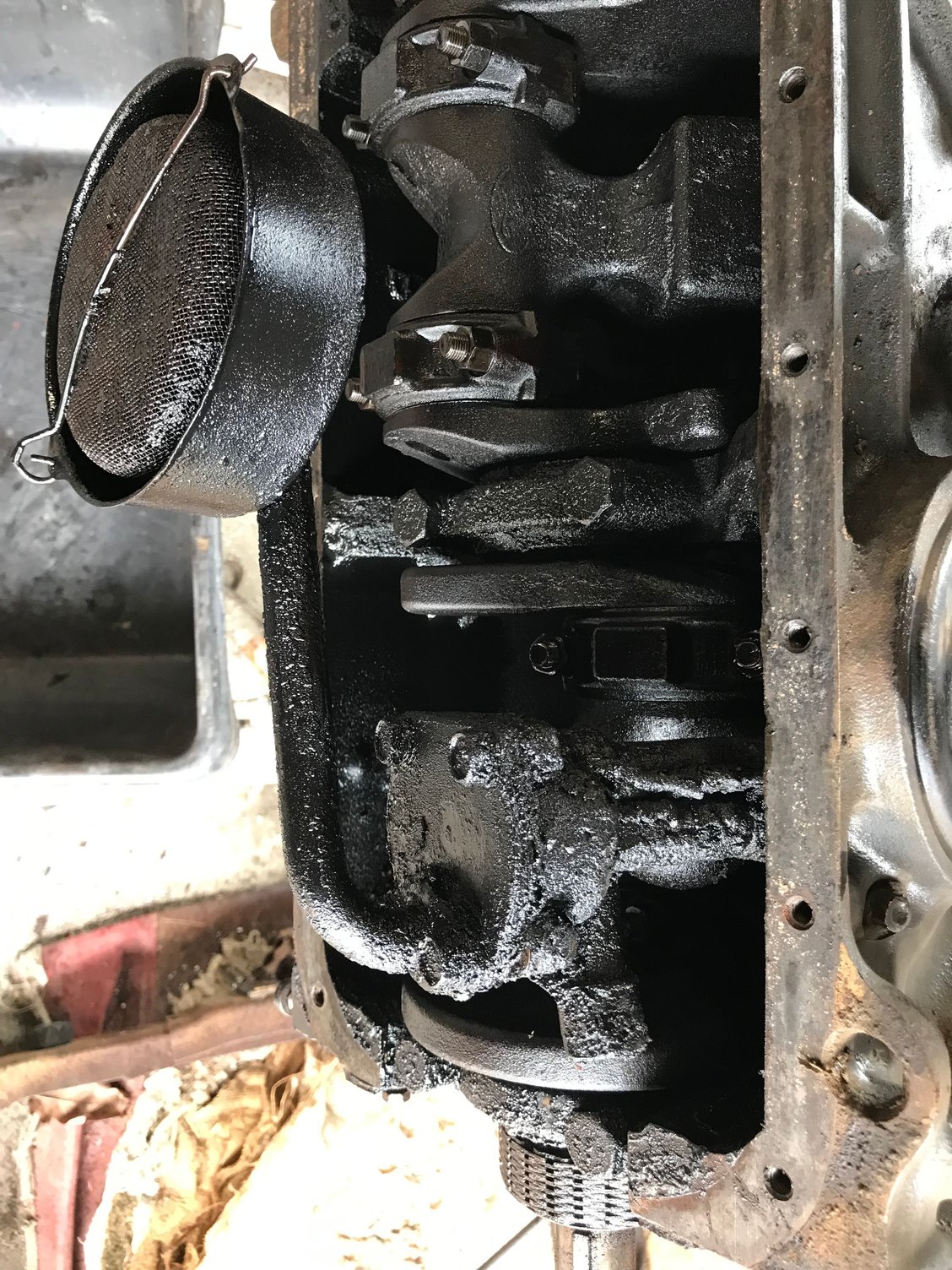

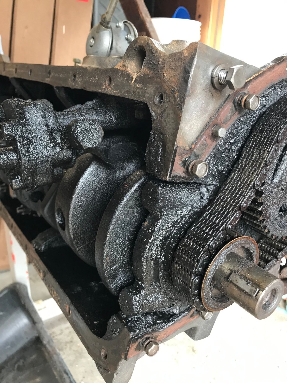

here are a few pictures of the engine prior to the tear down…
Some of the sludge around the crank.
Sloppy timing chain and all the oil sludge around it.
Sloppy chain 2!
Sludge around the oil pump.

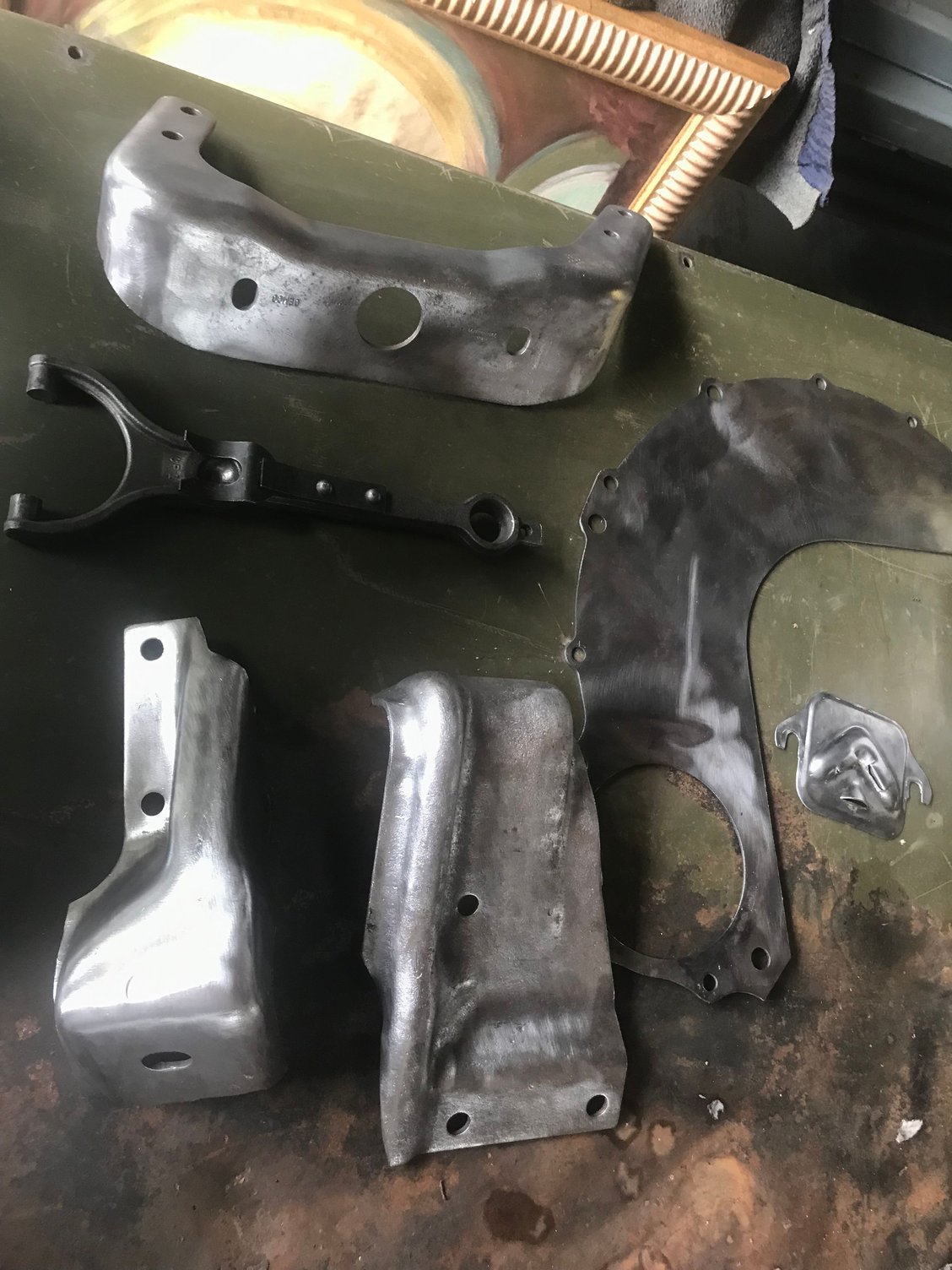

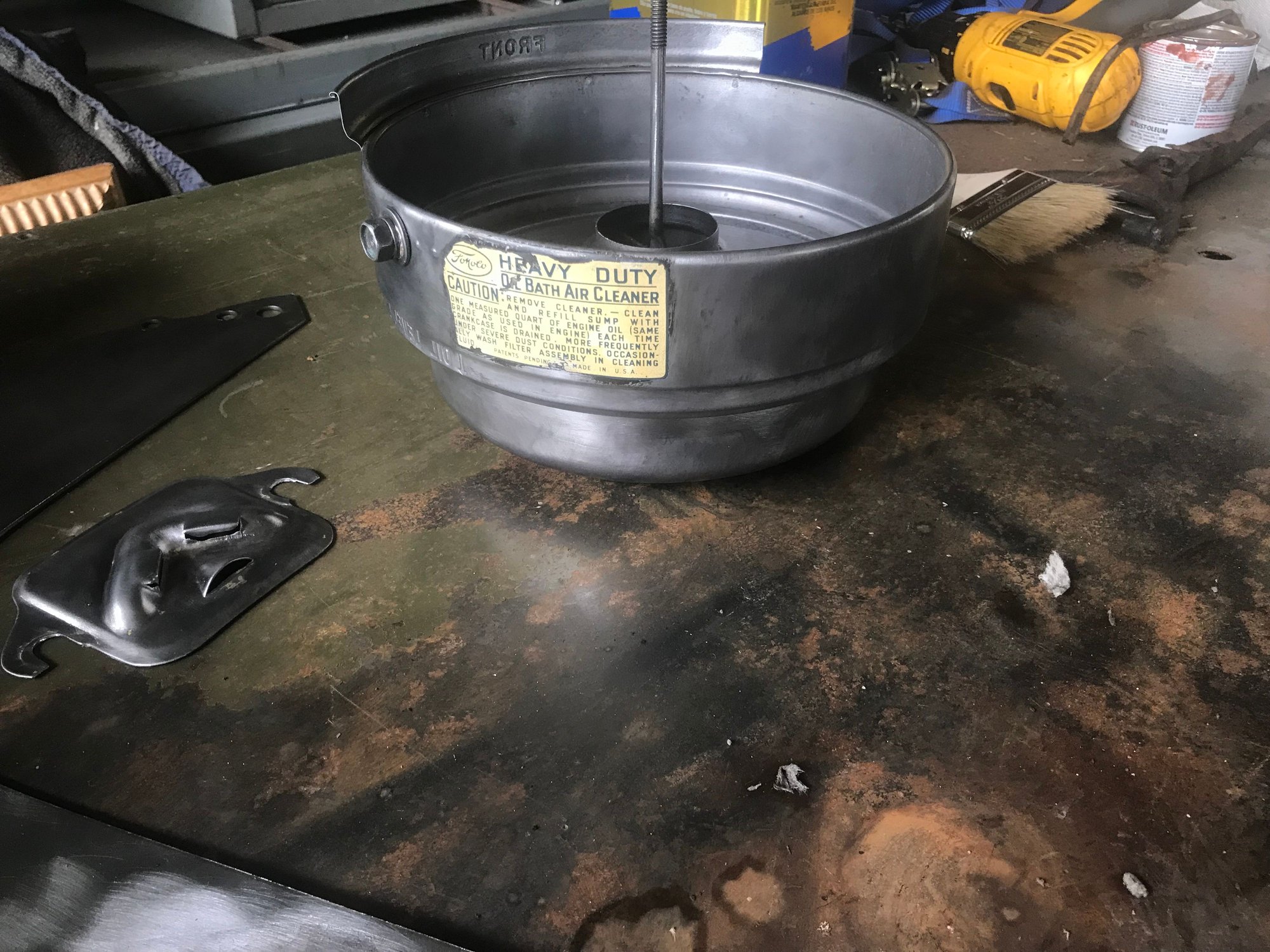

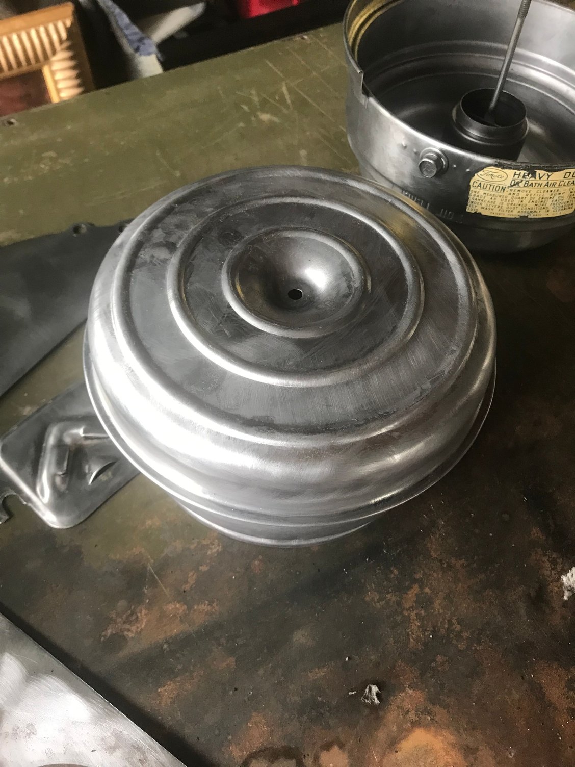

Only had a couple of hours to work on the truck yesterday. Got a bunch of parts cleaned up with the wire wheel and ready to paint. Motor mounts, oil bath, flywheel cover, inspection cover, etc.
Too humid to paint today. Hopefully this week. Did a little dermabrasion treatment as well.

I see you cleaned up some skin too!
Glad you could keep the original decal on the oil bath air cleaner. How are you going to mask it before you you paint? Will tape pull it off?

I taped it off. I didn’t get a chance to pull the tape off before I had to go in for the night. Hopefully in the AM it will come off clean.

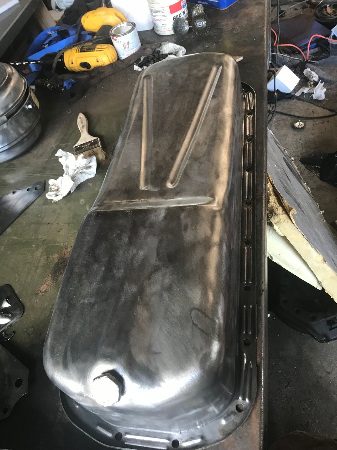

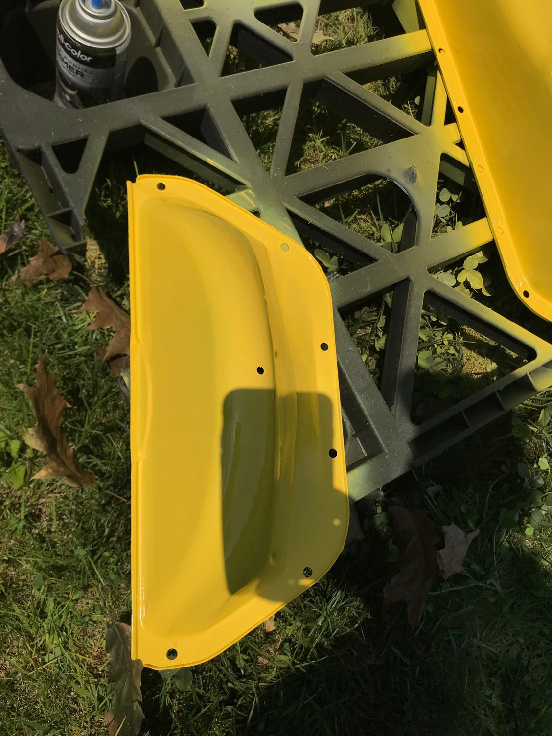

I also got the oil pan all cleaned up and ready to paint. I didn’t paint it because I ran out of primer.
Got some color on parts for the first time!

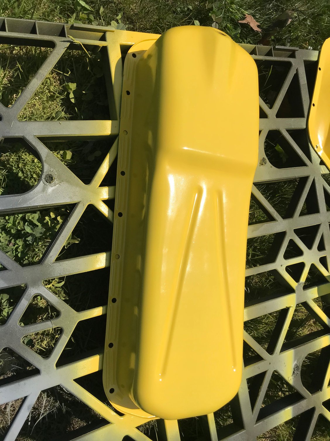

I painted the bell housing and the inside of the flywheel cover. I painted it all yellow inside and out so I could see any oil leaks through the inspection cover easier. The yellow does not cover that well, it takes a lot of coats to get it even and I still feel like it is not as uniform as I would like, but you really can’t see it so it is not a big deal. It will be more important on the engine when that is ready.

I got a bunch more stuff painted. My oil pan and clutch cover are done. All nice and shiny yellow! Painted my dipstick handle, the inspection cover for the transmission and the part of the brake assembly cast metal color. I also painted the engine vent tube gloss black.

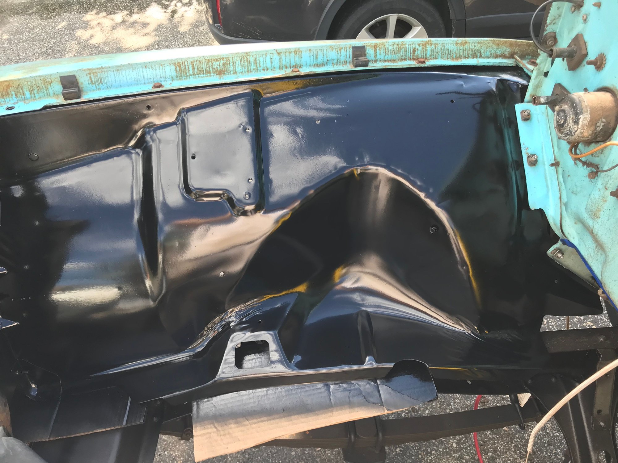

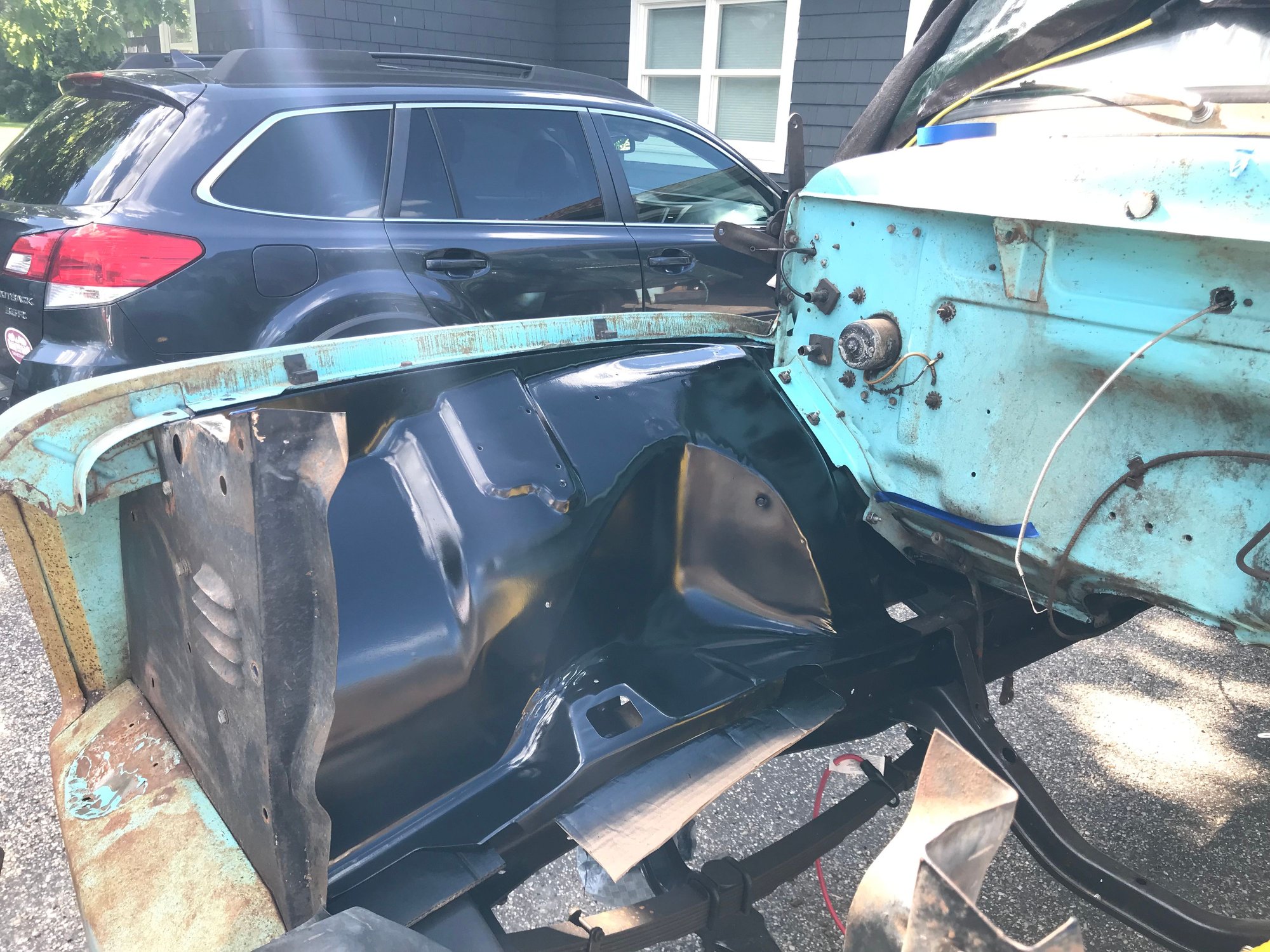

Below is a picture of the drivers side inner fender which represents the “before” and the passenger one stripped with a wire wheel and painted with POR Chassis black spray paint.
Drivers side next. Then will start to get the firewall cleaned up.

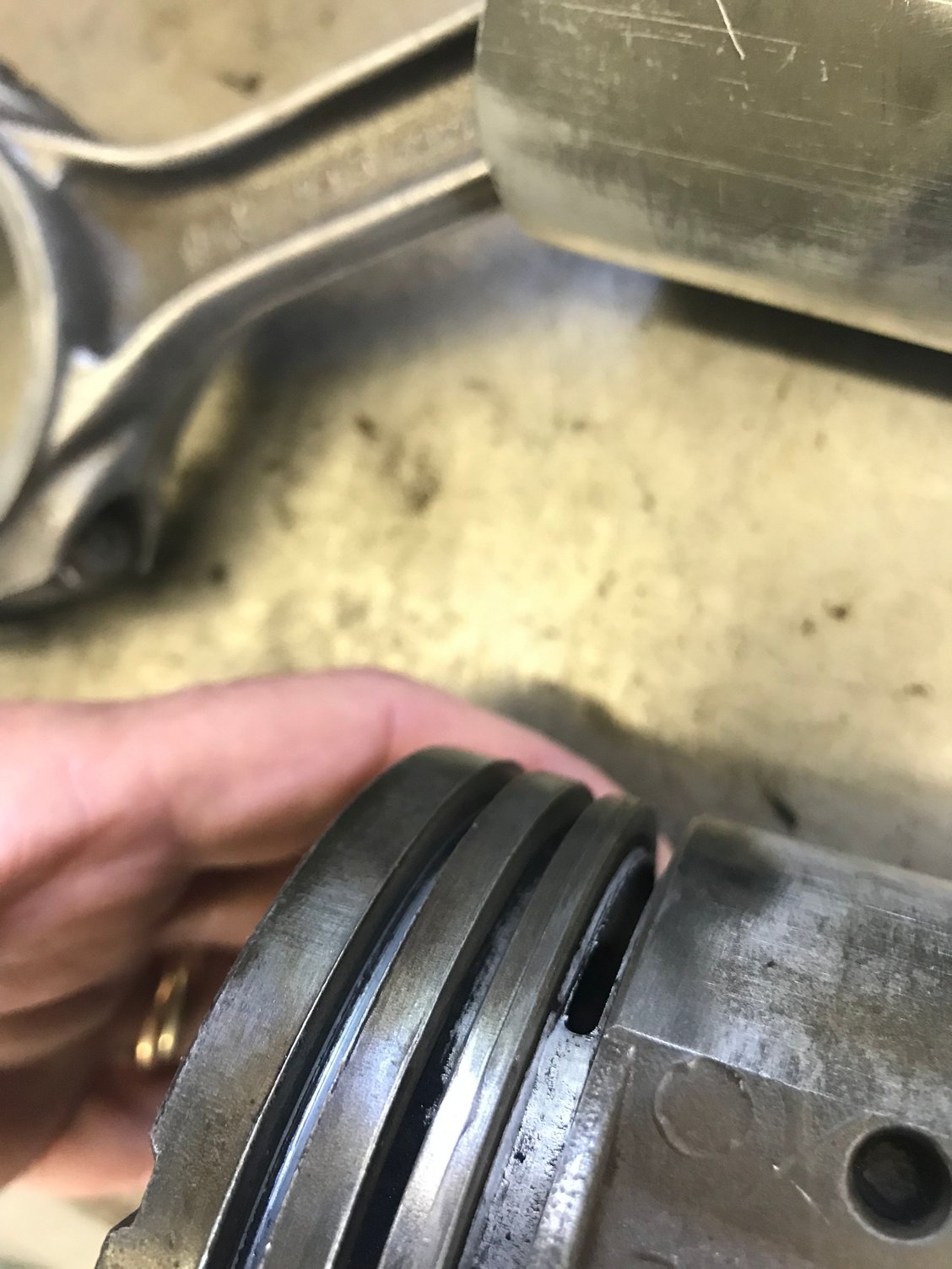

Also, there are some pictures of my pistons. The beat up one is the number 1 cylinder. Looks like someone dropped something in there! The machine shop said he noticed my head was a little marked up as well but no damage.
The other is the number 4 piston where the compression ring broke. You can see how it mushroomed the groove that holds the ring.

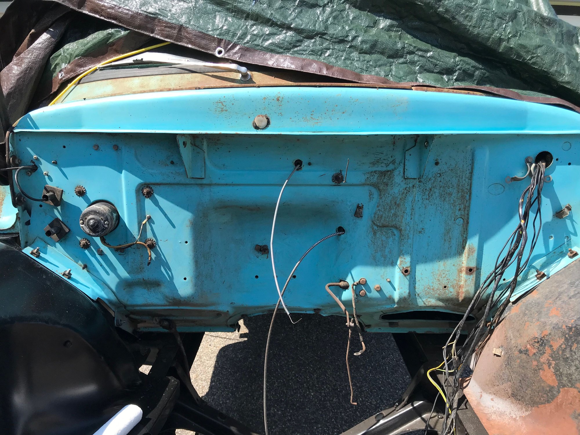

I did what I call a Stage 1 cleaning of my firewall. I wiped it down with mineral spirits to get the heavy dirt and grease off as well as the seam sealer everywhere. I cleaned the Speedo cable to get all the old oil and black tar off of it and it is pretty nice now.
Next time I have a full day I will get the drivers side inner fender done. It takes a long time to wire wheel all that. After that is cleaning up the firewall. I need to remove everything that is bolted to the firewall from the inside so I can get it nicely cleaned up.
