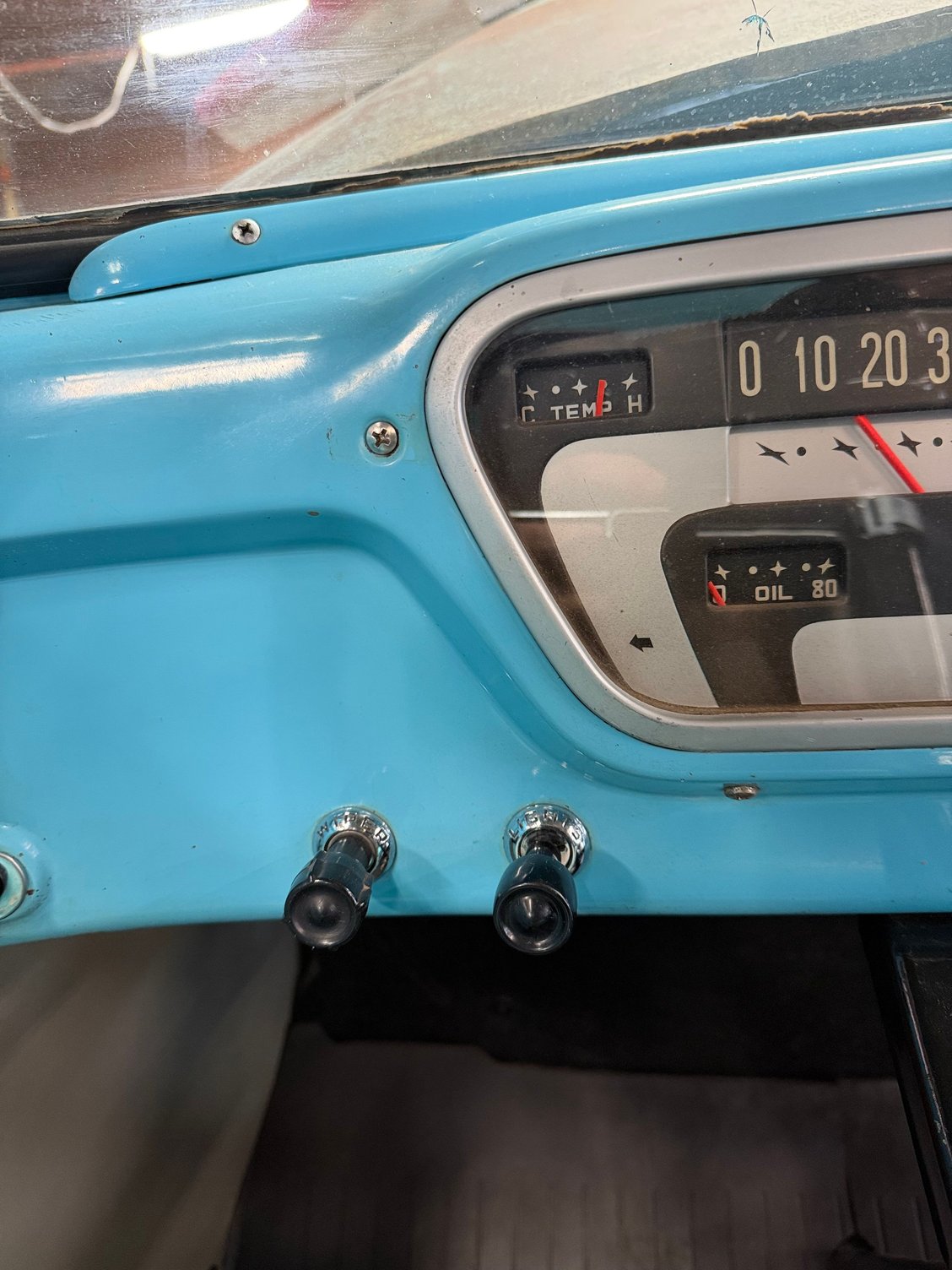

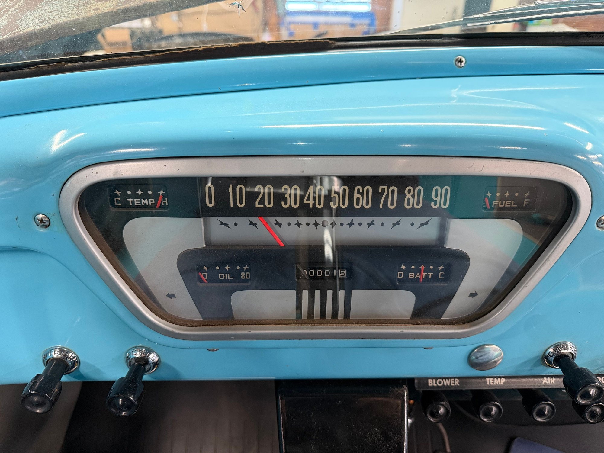

I re-did my gauge panel and put a new speedometer in. I got the speedometer from Summit as they had the best price but it sees to be the same one all the restoration companies sell.

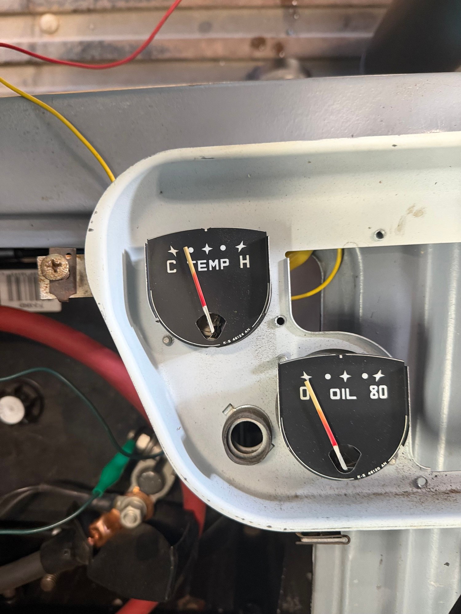

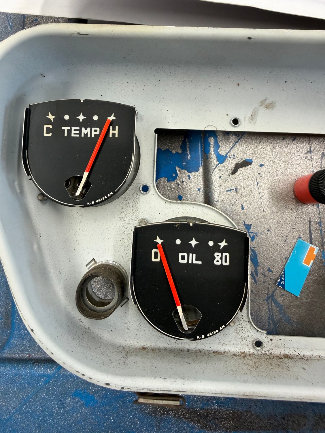

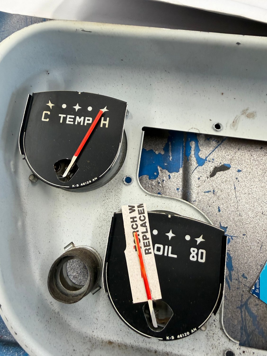

I painted the needles and am very happy with how they came out. I also painted the needle on the speedometer as it was a bit more orange than the other needles and since it is so big I wanted it to match. The trick is to load up the brush and drag it across the needle with the goal being to do it all in one coat and a single swipe. I didn't always get the single swipe but one heavy coat worked perfectly. It dries a matte finish pretty quickly.
I mounted them all back in and put a different temp gage in as I wasn't sure mine was working properly. I think it is working but am not 100% sure yet. I have another thread on it.
https://www.ford-trucks.com/forums/1...and-gauge.html
I didn't open the gauge cluster up and clean the glass or paint the bezel. I decided I wanted to leave it a little weathered like the rest of the interior.
I got a new 6v temp Sender and tested it and think it is working. The water got too cool to really tell so I am going to test it again tomorrow with the new gauge. It seems that sender works but the issue is it is a 3/8 NPT thread and the block is 1/4 NPT. I ordered a reducer but I know the sender barrel won't fit through it and I will have to drill it out. It looks there there should be enough material to do that. If not I am going to have a machine shop make me up a fitting so the barrel has a tight friction fit. That will keep the threads from cracking when it goes into the block as the sender barrel will support the threads/fitting.
I won't be able to full test the sender and gauge or speedometer until spring when I can put it on the road and hopefully it won't turn into a re-do.
I think the next thing in the list is the first out change and taking a crack at the repairing the heater valve again.
Needles before
Needles before
During painting
During painting
All done
All done
I took an acid brush and trimmed the bristlws back tightly so I could control the width of the paint being applied
Finished
Finished

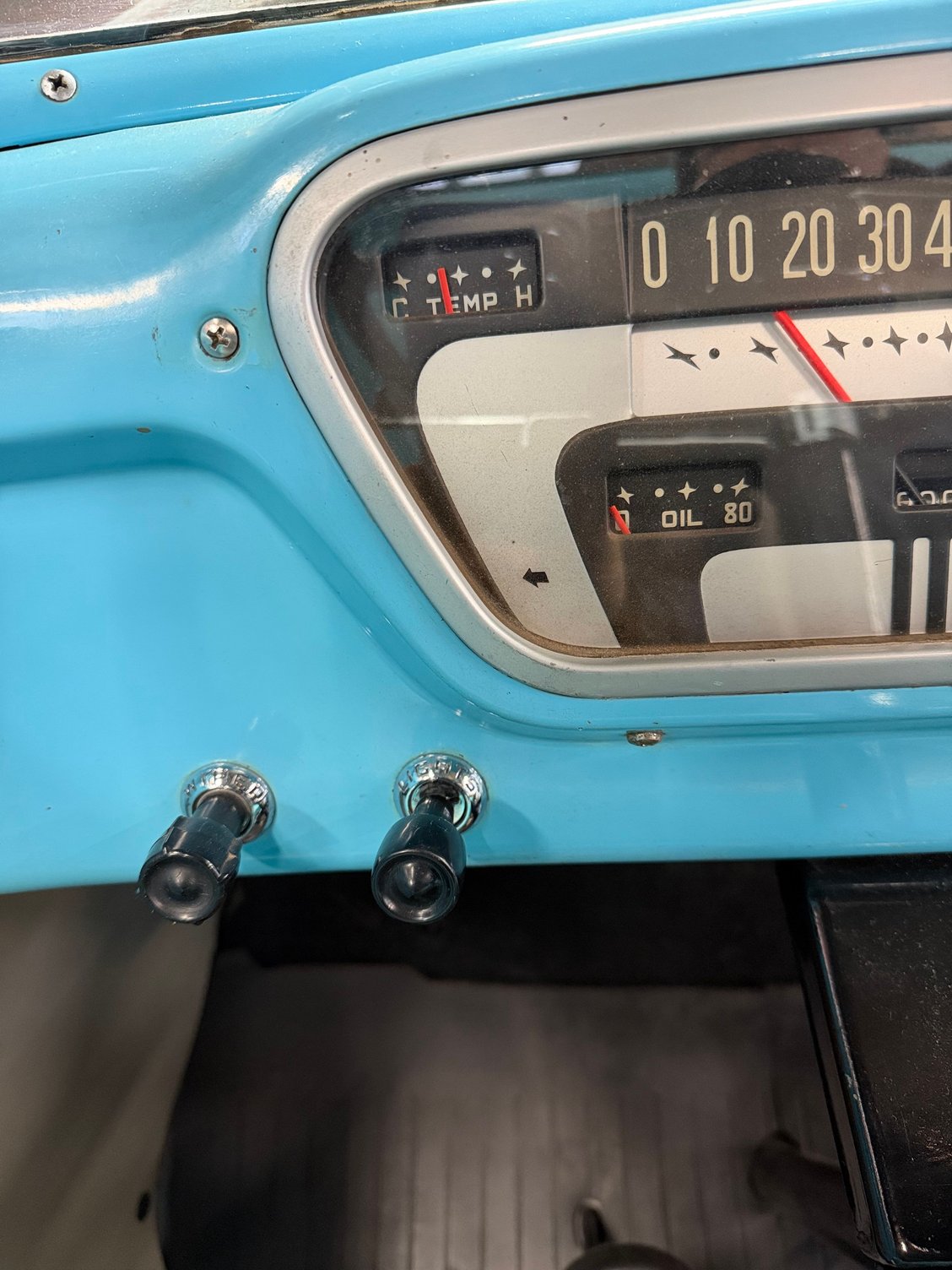

Reinstalled. Not sure why the needle is sitting where it is. Hopefully it's not broken.

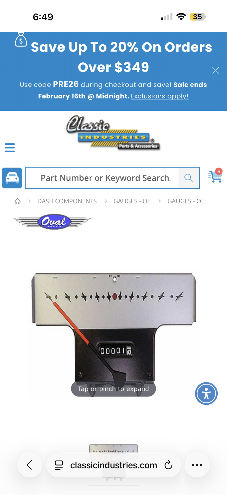

Aaaargh. Summit wants me to return the speedometer so I have to take the the whole cluster out again. I think I will buy the replacement somewhere else. There seem to be 2 styles. One with an oval shaped high beam hole and one with a round. Mine is definitely the round hole which is the one I got from Summit. LMC also has a round hole so I will probably get it from them. Ecklers and Classic industries has the oval shaped hole.
I tested my temp gauge and sender using an infrared thermometer. Where the gauge reads based on Temp in the pics below. It reads at about 3/4 at 190* and about 1/3 at 155*. I don't know what the typical operating temperature is and I can't remember if I bought a 180* or 160* thermostat. I know it was whatever the stock one is supposed to be. It looks like around 170* it would be at the center. I ordered another temp sender which is 1/4NPT and won't require an adapter. After researching it looks like it should work. I will have it in about a week and will test and decide which one to use.
