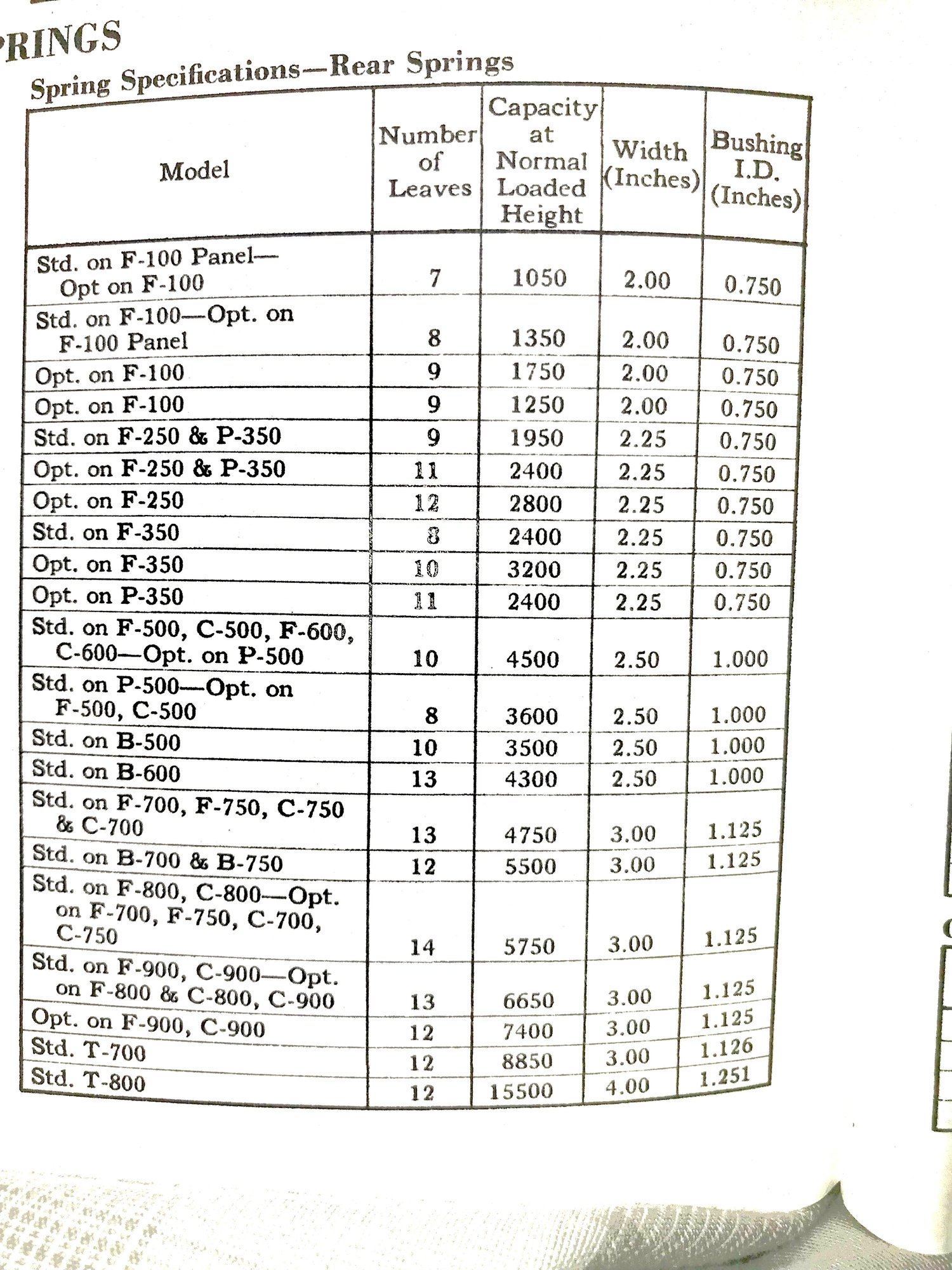

I got some more info by digging into the shop manual…
It does not show the helper springs as an option on the F250, only the 350 and up. Because this was a farm truck the tailgate as a grain door in it. Maybe they needed the extra payload support.
Stock for a F250 looks to be 9 Leaves which is what I have. So the helper springs are going to go since I still have 3/4 ton capacity. Good reason to take the springs off and clean up all the pivot points and replace the Ubolts. Also easier to clean up and paint the rear end out of the truck.

Well that's interesting. I never looked that closely at that part of the manual.
My 55 F250 has the overload springs. It was a farm truck and had a Knapheide bed on it. I think it might have come as a cab and chassis new. Definitely farm country where the truck lived but was built in Kansas City.
I wonder if the overload springs were a regular dealer add on in the farm communities.
