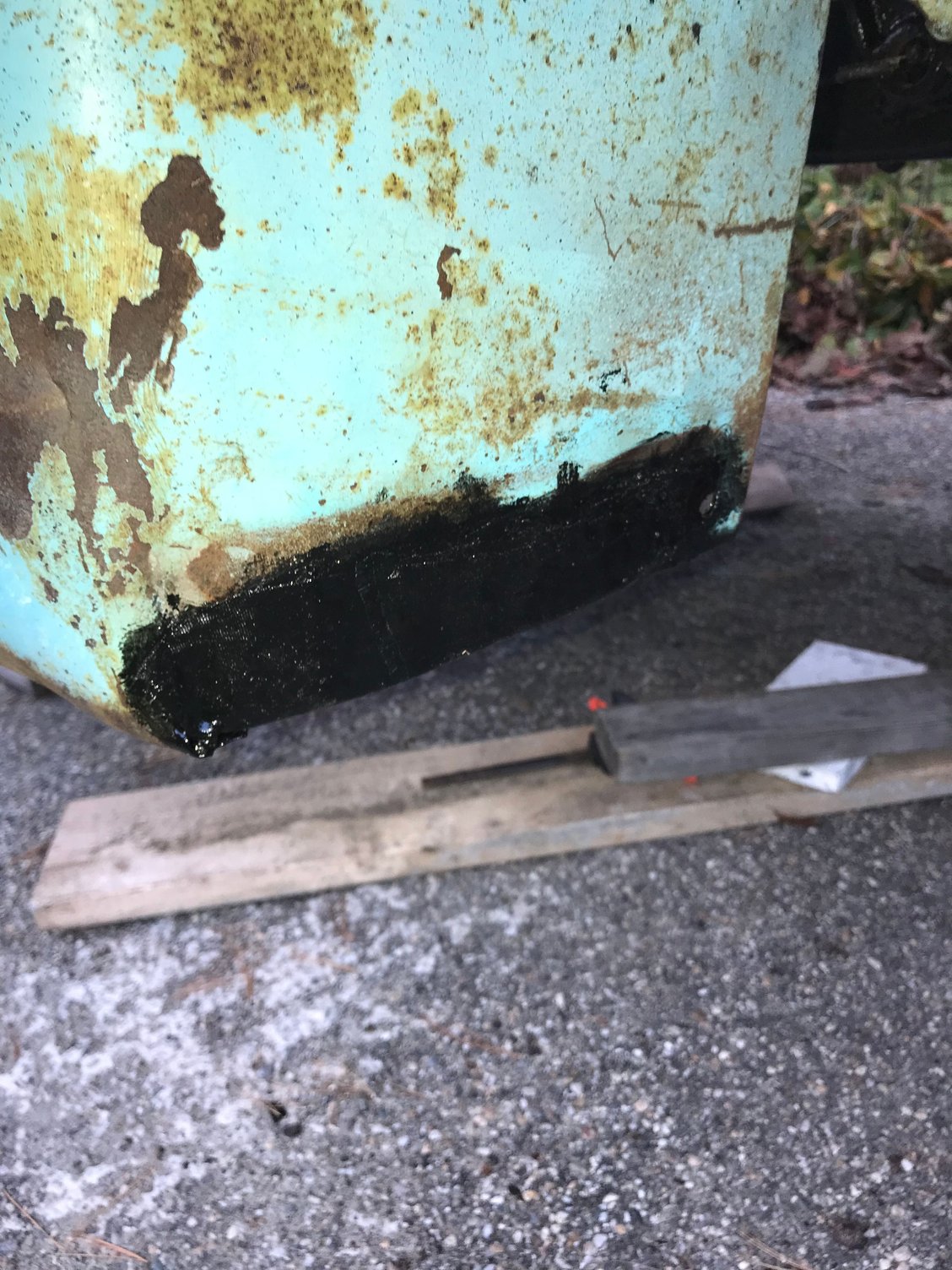

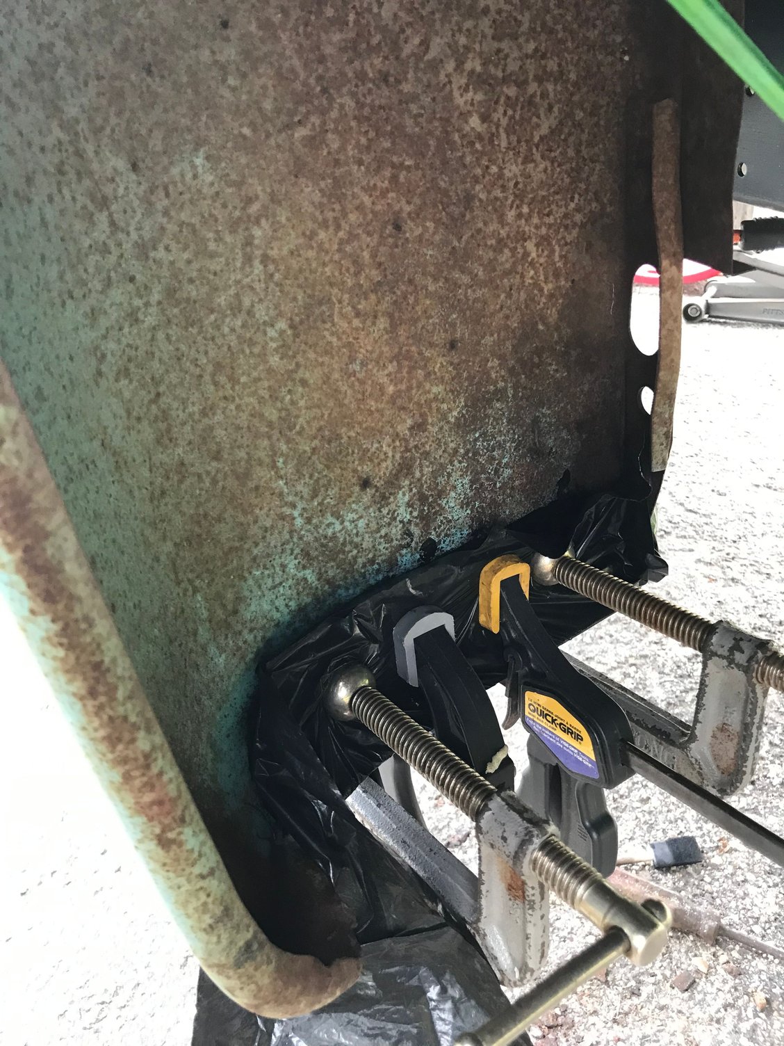

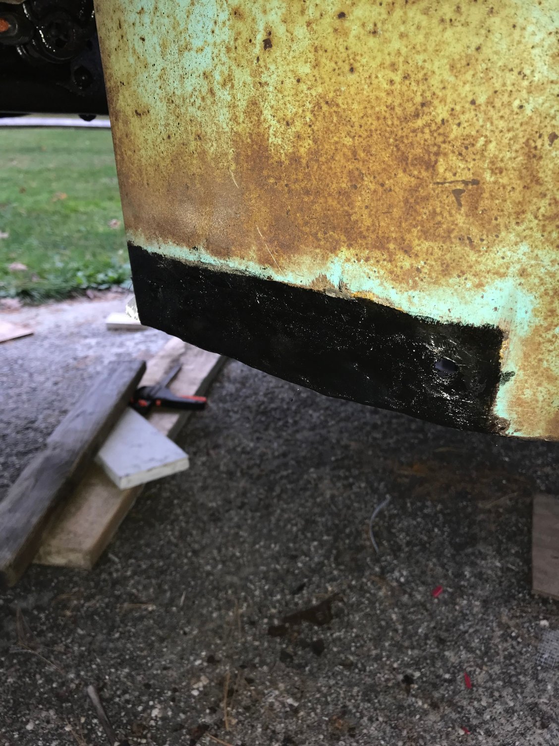

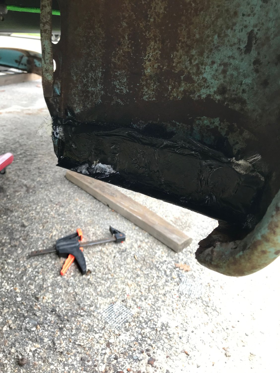

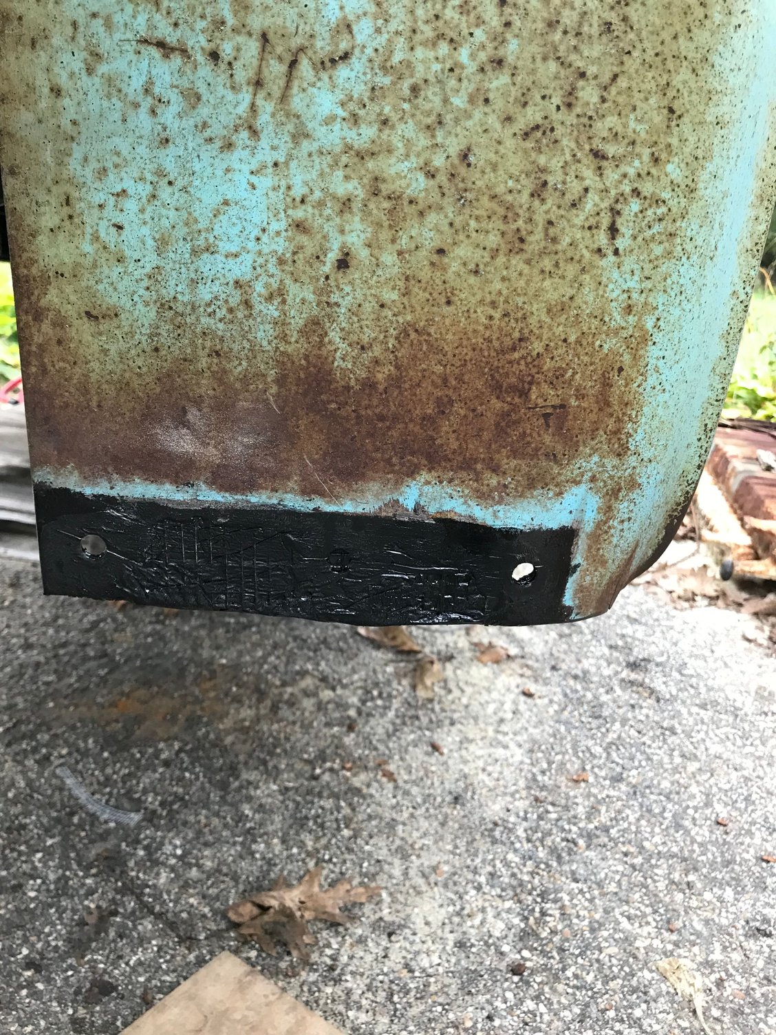

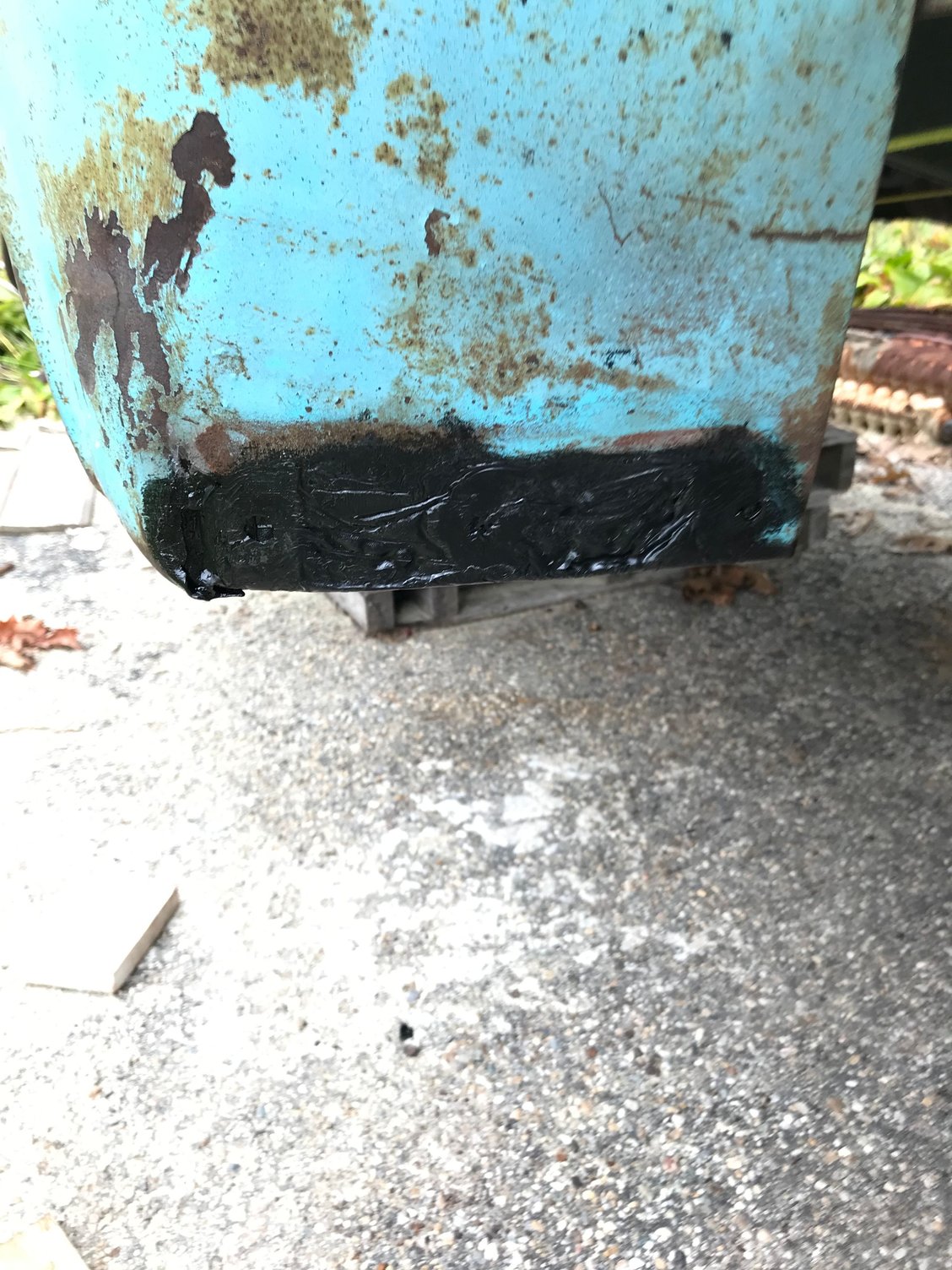

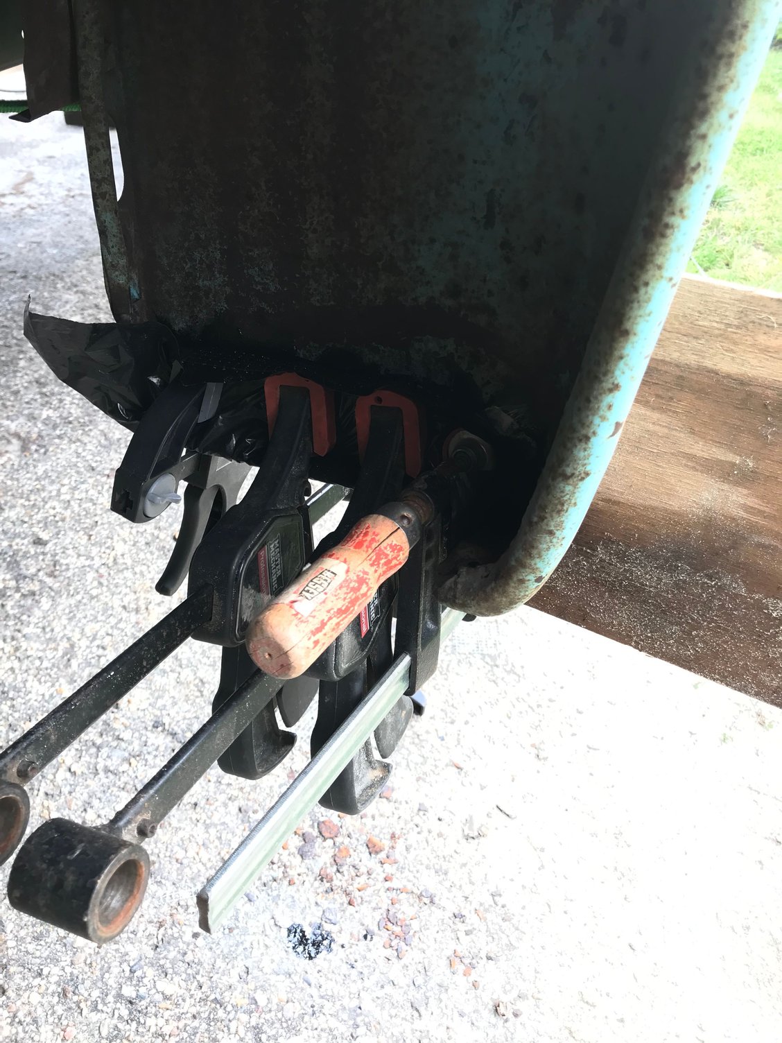

Almost finished reinforcing the rear fenders. It’s basically done but I want to put one more coat of POR patch on to smooth out any rough spots and depressions.
Basically I soaked the rusted area in POR slid the metal mesh in and reinforced with POR soaked fiberglass.
I then took the POR patch which is basically really thick POR and filled in any gaps and the spaces between what was left of the metal backing plate on the lower fender.
I clamped it all in place first covering the repair in plastic and then pressing the backing plate metal in tightly to the fender and compressing the fiberglass and mesh together. The POR patch acts as a glue somewhat like panel adhesive and reinforces the area and secures everything together.

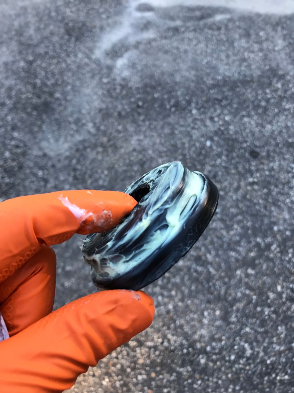

I got the front body mount bushing back in on the passenger side. Just need to find a few minutes to do the drivers side and then start on the rears. I covered the mount in a silicone gel that is made by Toyota that is said to keep rubber parts in good shape much longer than without as well as restore older rubber parts.

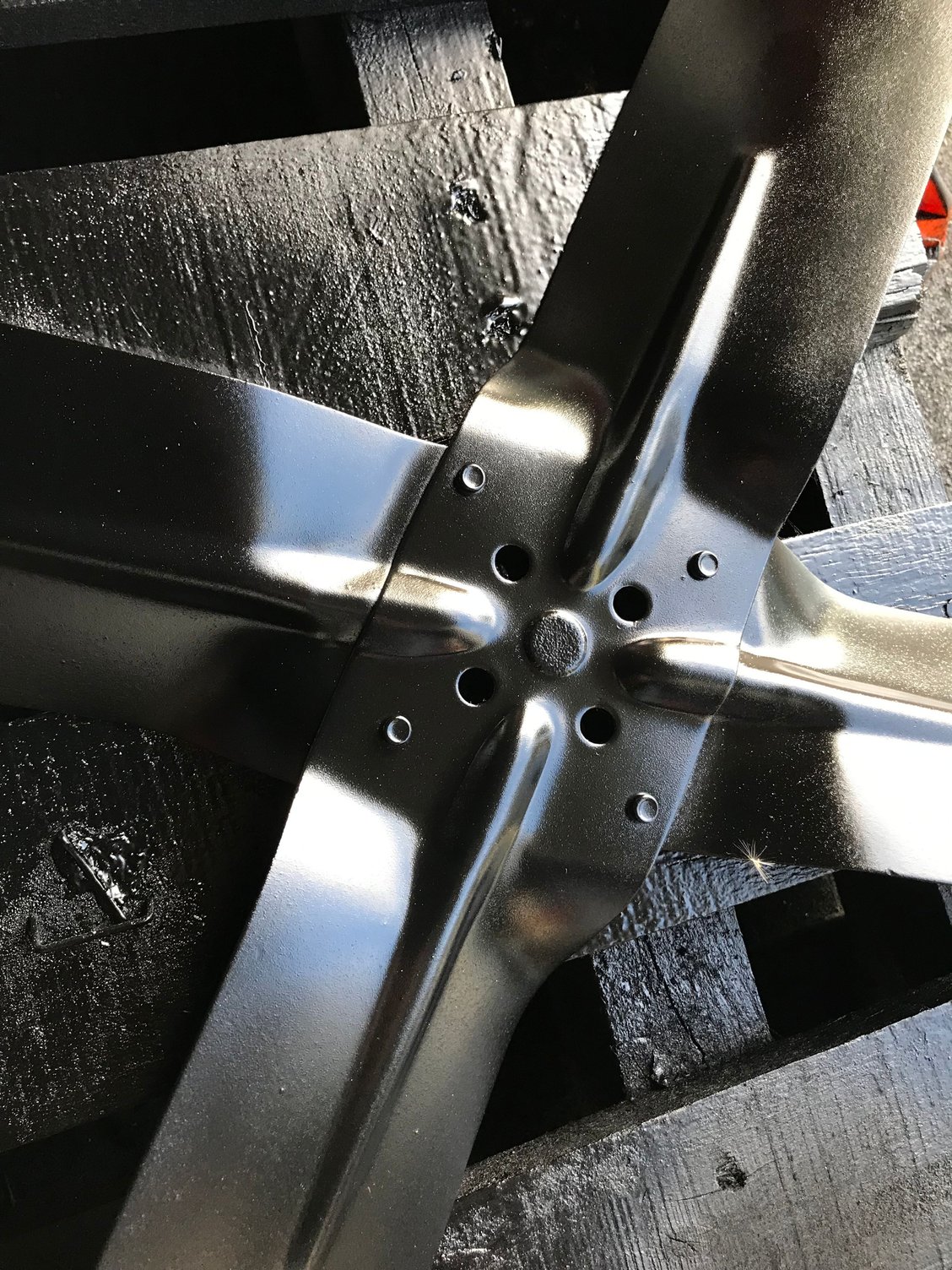

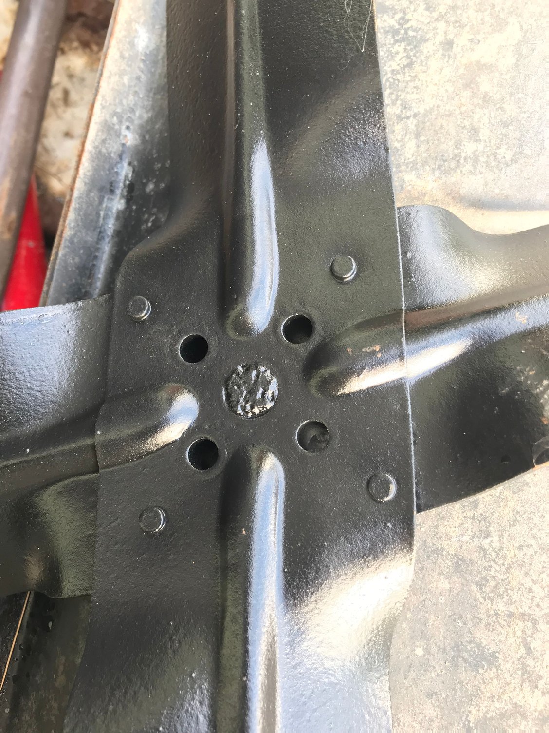

I got my fan painted and my exhaust hangars.
Completed repair on passenger side
From behind on driver’s side
And on passenger side
Front of driver’s side repair
From the front with a board to spread the clamping force
Repair clamped together
Same

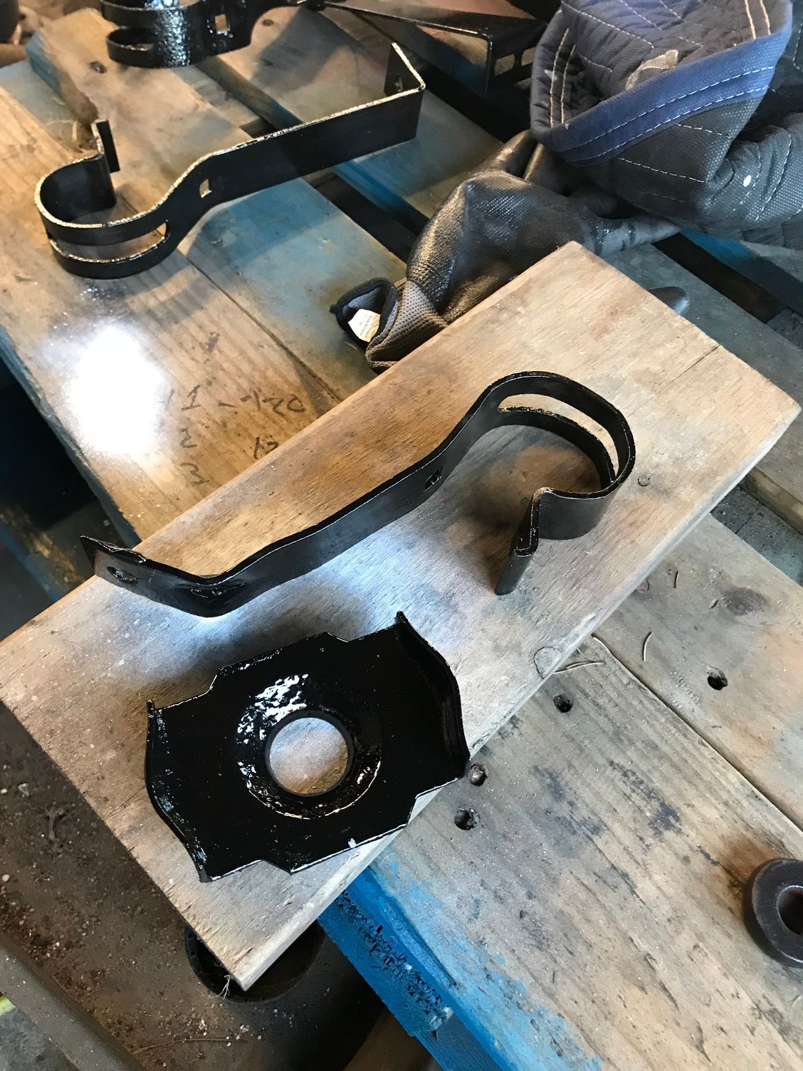

Can mount bracket cleaned and painted with POR

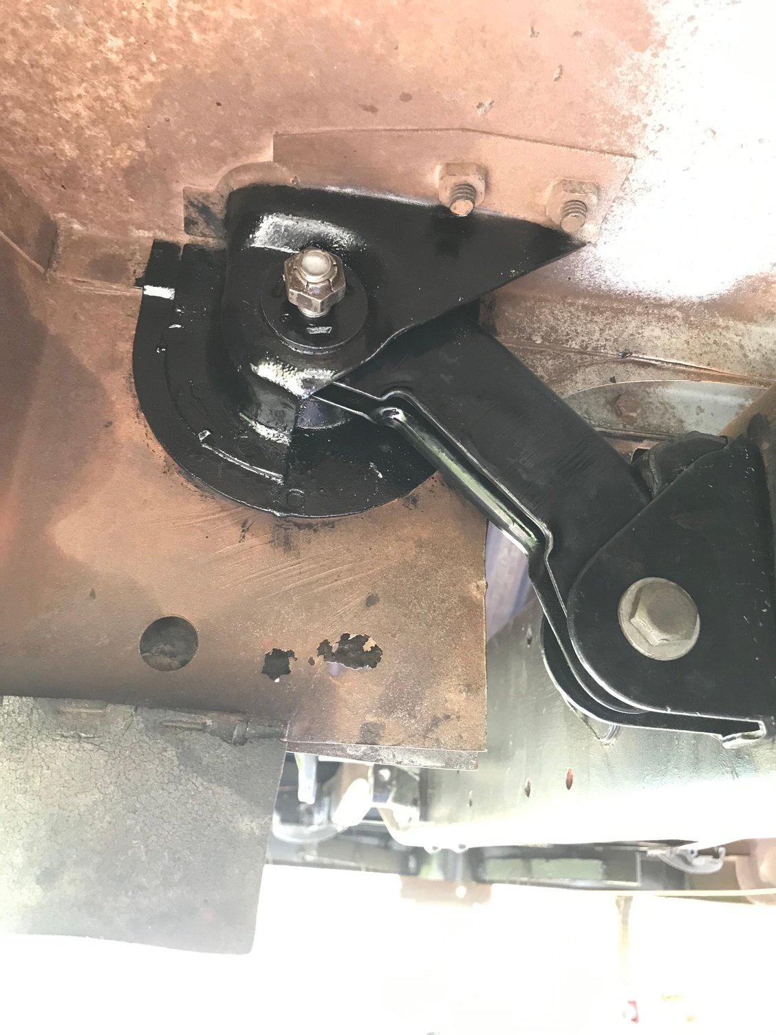

Body mount covered in Silicone grease
Me bushing in place
Fan painted
Old Oct 14, 2021 | 07:19 PM

Are you gonna paint your POR, not poor, patch job? Or will the running board cover it ?
Also, how thick is the POR patch? In other words what size holes will it fill? I've got some small holes in the door of my 54, from pinhole size to a little bigger.
Old Oct 14, 2021 | 07:57 PM
  #183
8pack's Avatar
8pack
Joined: Sep 2018
Posts: 1,427
Likes: 486
I think the running board will cover it. If not I think it will blend in with the black from the running board. If not I will get some touch up paint and randomly brush it around so it blends in.
It definitely fills pin holes. Clean them up from the back first if you can. Clean and use the metal ready product or Ospho to prep it. Paint the back side with regular POR or spread the past as a thin film if you don’t want to buy both products. Let it get tacky and then apply a thicker layer of paste. Depending on where the pin holes are I would do it from the back and let just a little poke out of the pin hole which you can trim later or wipe off with acetone before it fully cures.
in terms of how big a hole…Hard to say. You will know when you have it in your hands and use it for the first time. If the hole is too big prep and paint with POR from the backside and let it get tacky. Take an appropriate size piece of fiberglass cloth and lay it on a sheet of plastic and soak it with POR with a foam brush.
When both are fiberglass and the repair area are tacky lay the fiber glass across the hole from the back. If the metal area gets tacky before the fiberglass just lay the wet fiberglass in on the backside. It may just take a little more work to get plot to lay flat or adjust to curves.
Move to the front and layer the paste in to fill the hole waiting for it to firm up a bit and get tacky before the next coat. Repeat until it is filled in to your satisfaction.

I finished the fender repair and it is rock solid. Going nowhere as long as I own the truck. Will definitely outlive me. I put another coat of POR paste and then 1 layer of 2oz fiberglass to leave a smoother finished result. I still need to sand and feather the fiberglass edges but that has moved down the priority list as I am ready to start reassembly of everything but the drive train. Pics below.

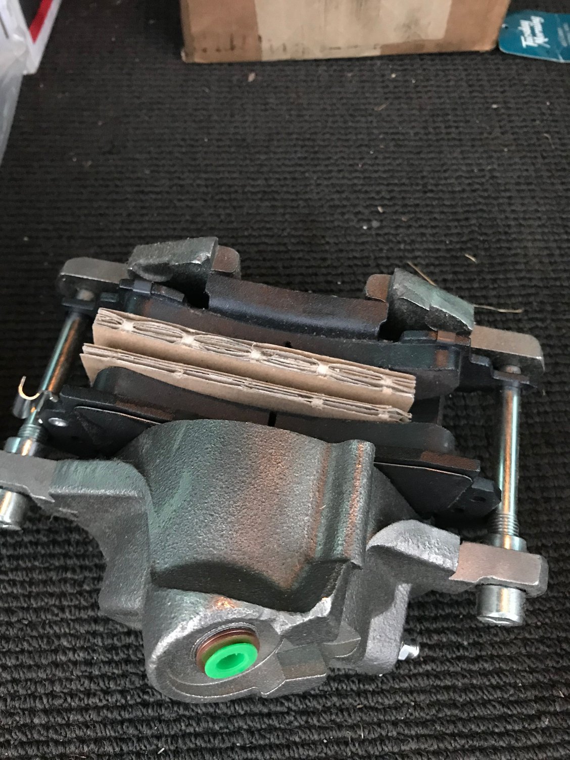

The coolest bit is i got a set of 8 Lug front disc brakes which use the existing hub and I can keep my wheels. Nice kit. The instructions were missing so I emailed the manufacturer and hopefully they will send them to me next week.

This is the fan I painted before off the ‘62 motor. Chuck took a look at it and said not to use it, it has been welded back together. You can see it in the center. I painted the ‘55 fan and am all set.
This is the ‘55 fan you can see the difference.

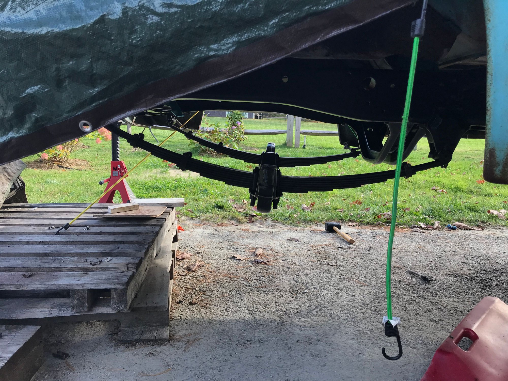

No pics today but I was able to get the bushings honed on my spring shackles by my neighbor so I could put the rear springs on today.
I thought the new pins and set pins would just slide into the fittings on the frame but it required a couple of hours of careful work on my back and sitting under the truck with a 1/2 round and rounded file to clean up burrs and smooth things out so they would fit in smoothly. I am not clear why they needed to be cleaned up but it must have been rust and flashing that didn’t need to be taken care of in the factory as they probably had some kind of press to push the pins in.
i basically ended up doing the install almost twice because I didn’t realize you had to connect the rear first and then attach the front of the spring. I put the front in first and had to take it apart. They are heavy to do by yourself!
I couldn’t line up the cut out for the set pin on the drivers front and it won’t rotate so I can adjust it like the rest. I have to pull that pin out and realign it on the next couple of days.

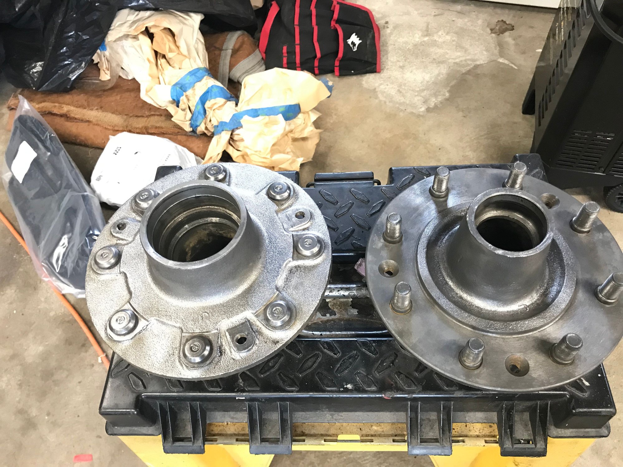

However, I got my crusty rusty spindles and hubs cleaned up like new and painted in high temp primer and paint, cast metal finish. This has me all set to start on the front disc install. I have a question on the king pin installation which I will put in another post.
I still need to get the rear drums primed and painted. Hopefully over the weekend. It is supposed to rain for the next couple of days so any outdoor work is on hold.
After soaking in Rust 911 and cleaned with a wire wheel.
Taped off and painted hub with cast metal Duplicolor engine enamel and primer.
Taped off and painted spindle

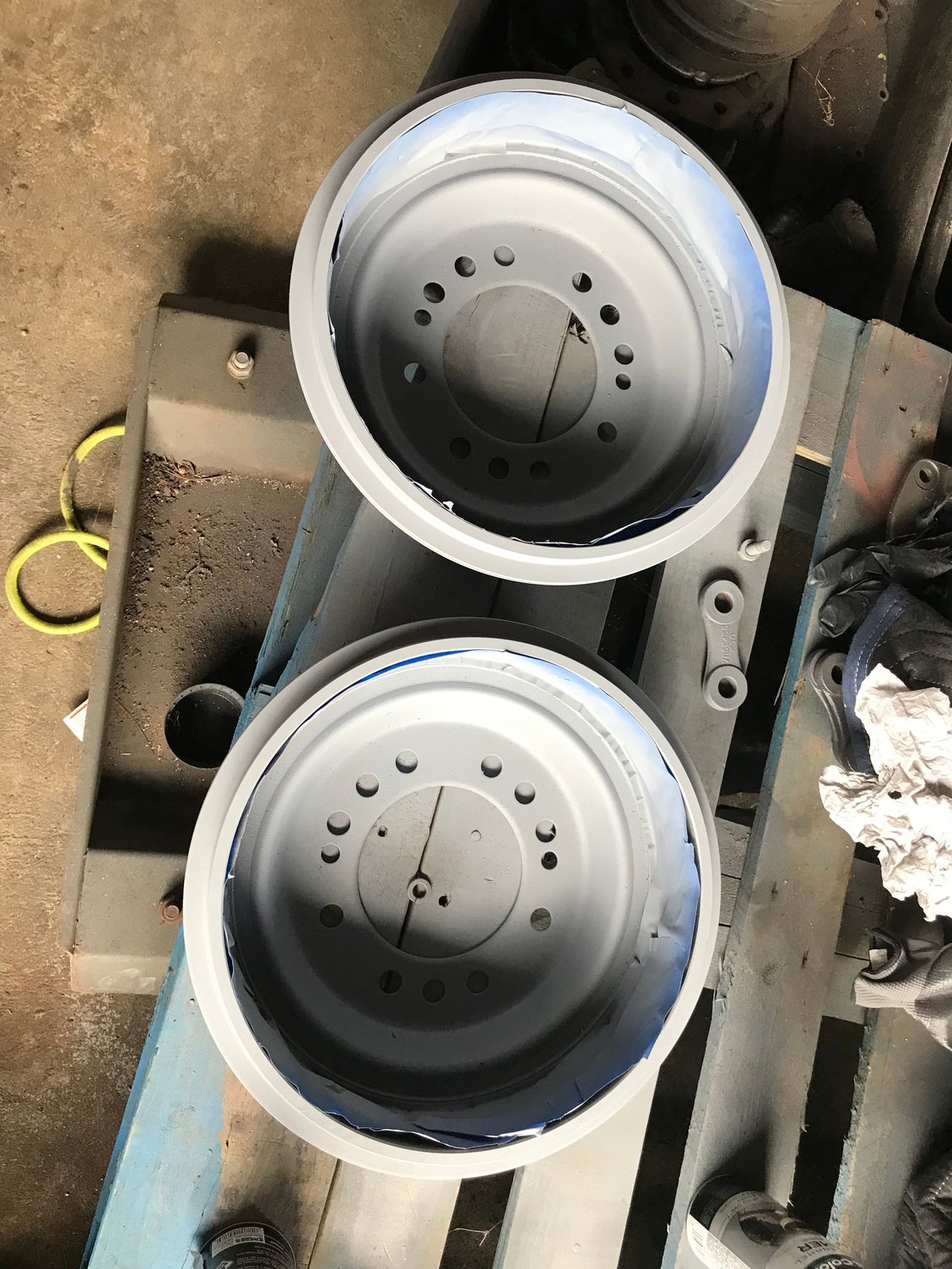

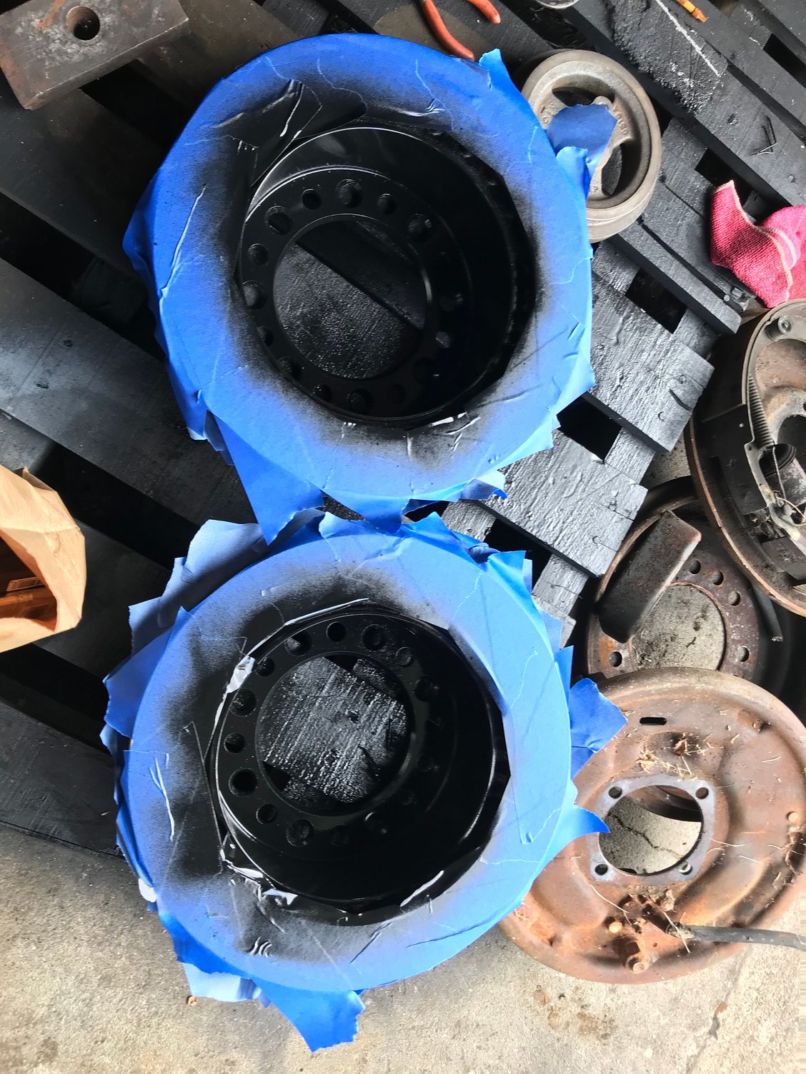

Big day…I have the rear springs properly installed and the differential is in.
I painted my drums in cast steel paint and the hats on my rotors I painted black to hopefully keep the rust at bay.

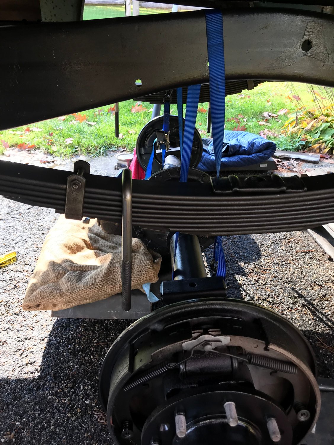

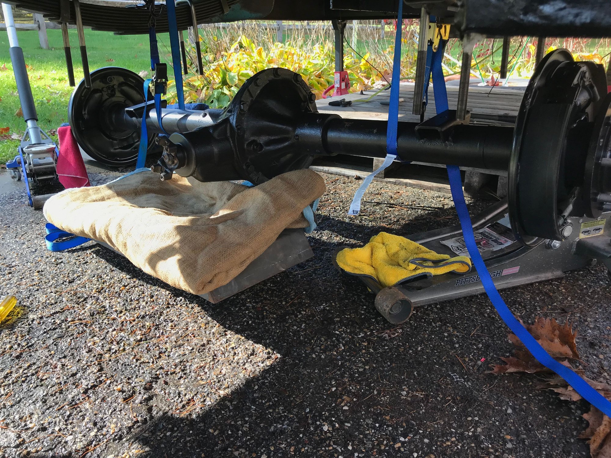

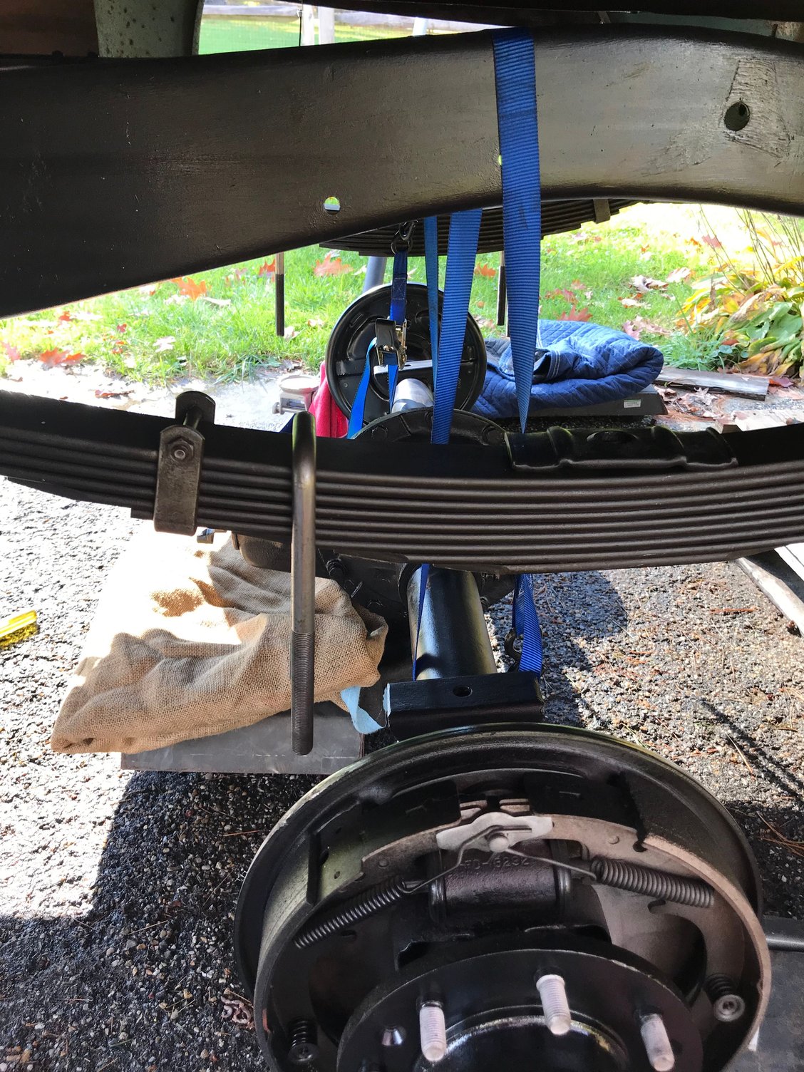

Here is some additional information on me installing the diff by myself.
I was able situate the rear on 2 car roller wheel dollies and got it under the truck.
i connected 2 ratchet straps on each end inside the spring perch. I ratchet it up was about 5 inches from spring. I jacked up one side at a time and adjusted the straps along the frame and differential to get the rear to swing into the right spot. With the lower plate and u bolts in place I slowly snugged up the nuts and adjusted the diff to align with the springs.
some quick pics
