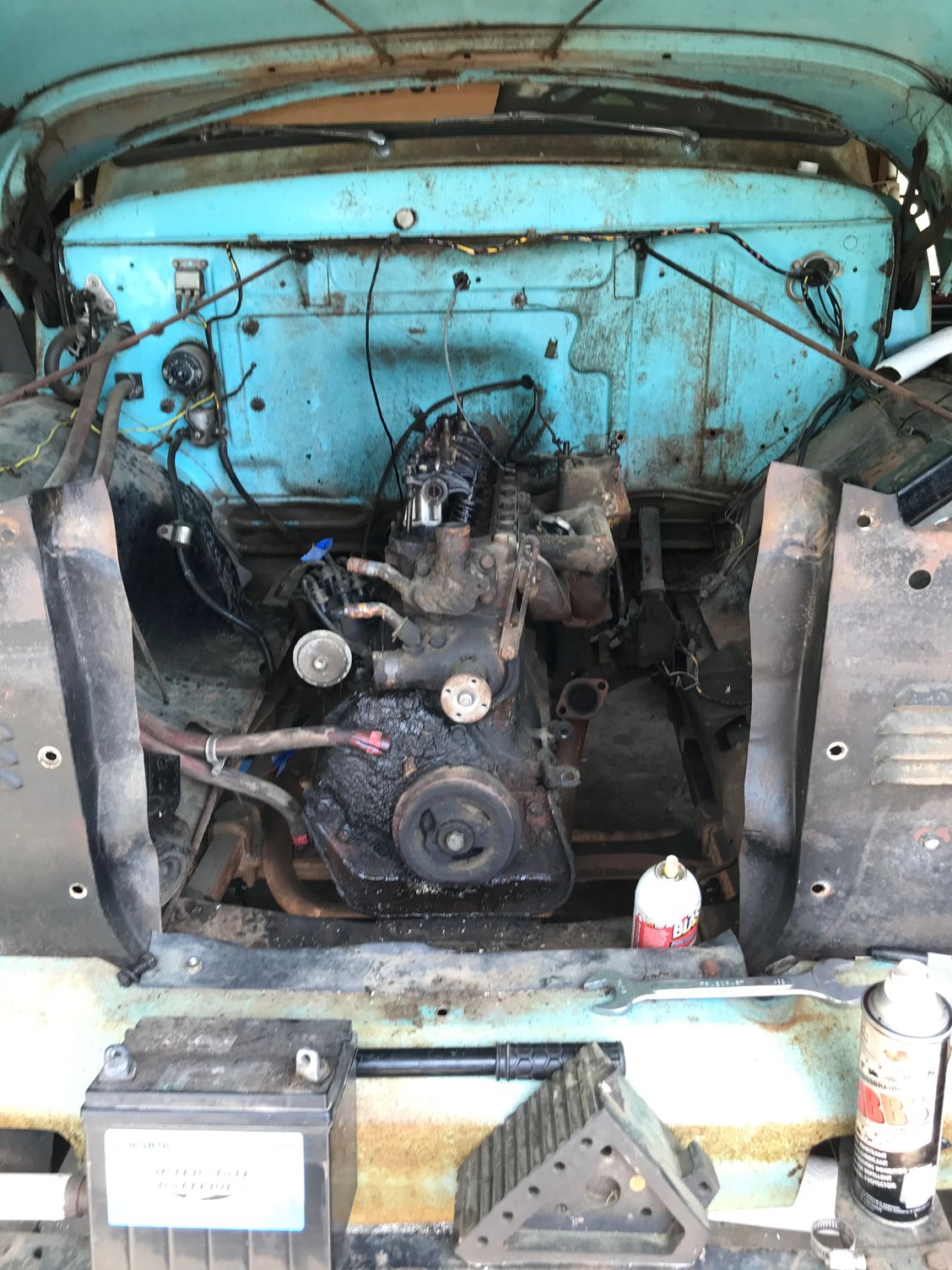

Big day today. Engine is ready to come out! Will definitely be out this week. My neighbor is going to use his Bobcat to pluck it out and is coming in the AM to set up a plan.

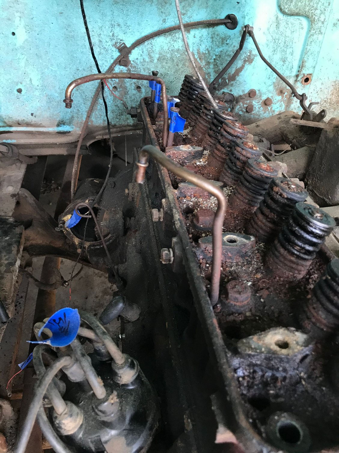

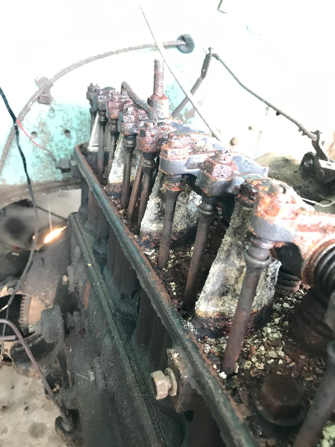

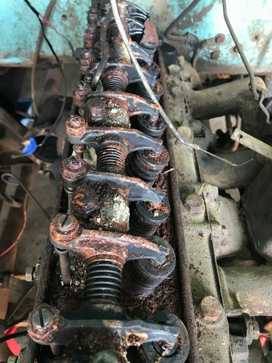

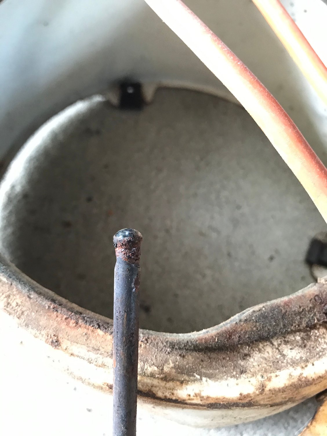

Here are just a couple of pics, pre removal. It certainly explains why the engine is seized! I have never seen a top end like this that has been sealed up. Check out that corrosion.....No oil anywhere. When I removed the oil filter there was almost no oil in it. The pan was full. I am guessing a bad oil pump?
I will spend some time on it once the other engine is sorted out and in the truck. Very nervous about the compression test and finding out I have a bad replacement motor.....

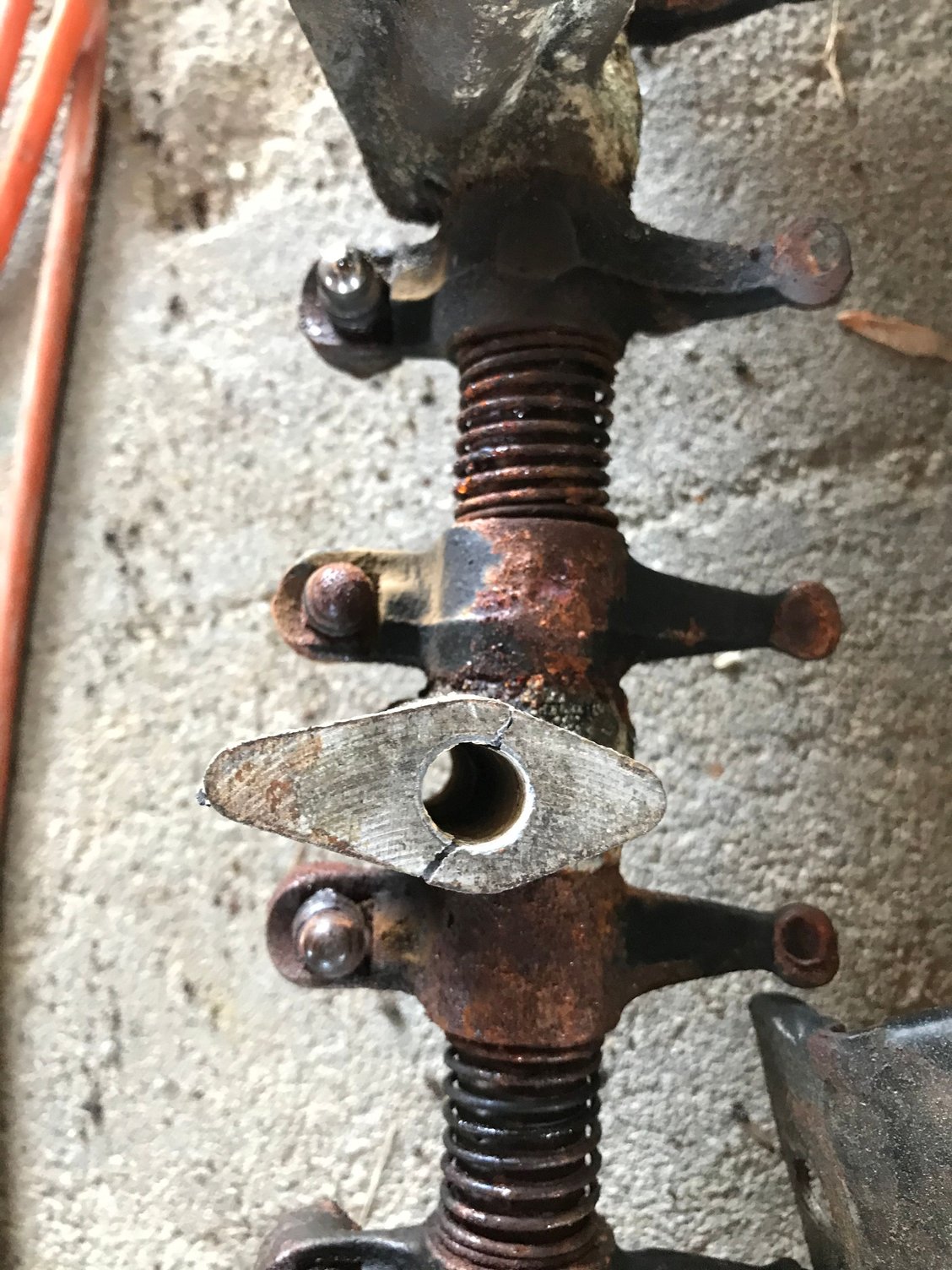

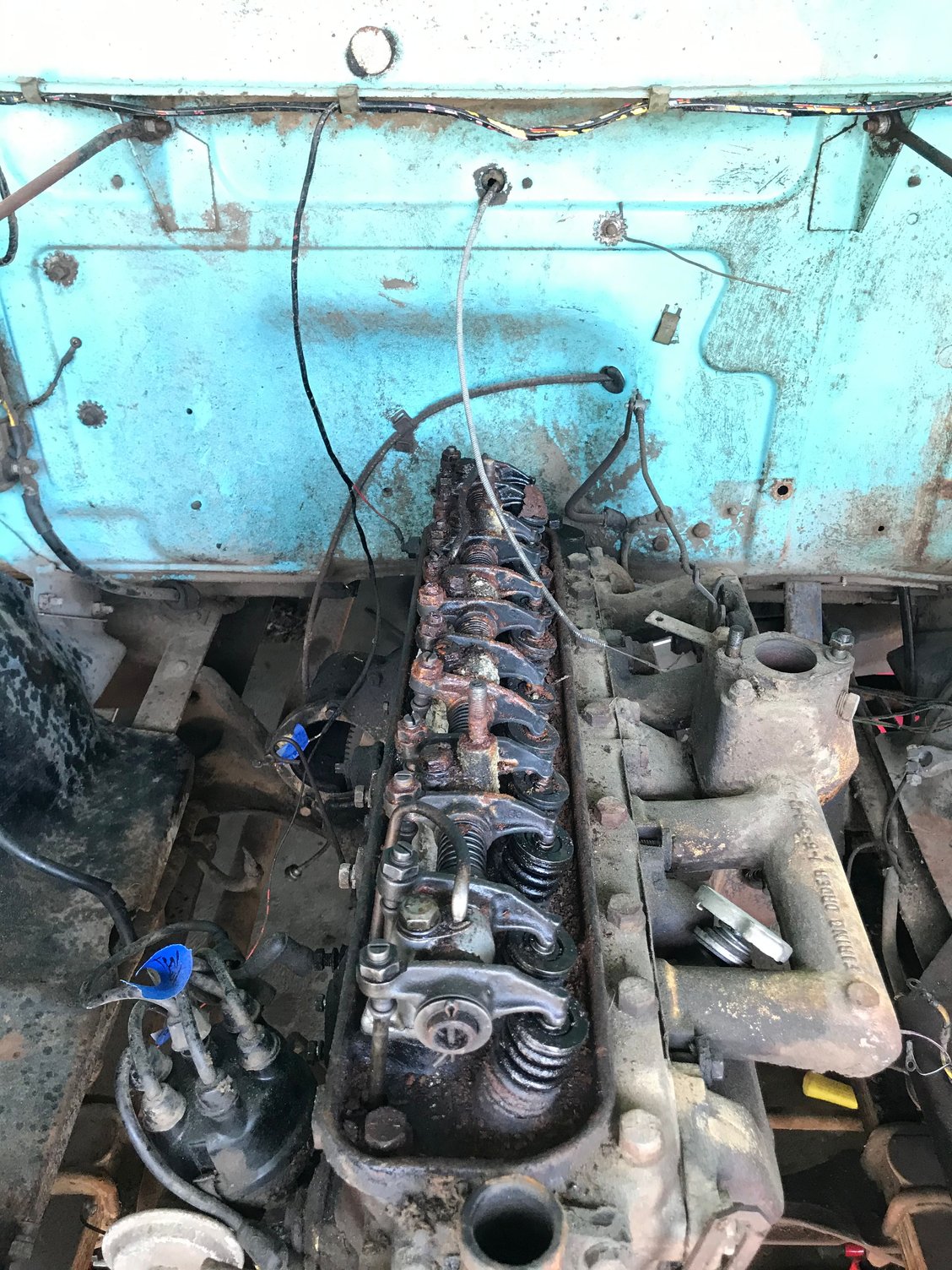

Took the rocker assembly off so we could get at two head bolts to lift out the engine. Here’s are some more pics of a crack on the assembly at the #4 cylinder and one push rod. The push rods were stuck in place. I still have 3 that won’t come out.
How do the top end oil tubes come out. I got one end out but the long part that goes into the head won’t come out. Pic also below.

Yeah I'm not fixing that motor. If by some miracle it looks OK when you pull the head great, but don't hold your breath.

I'm with fatfenders on this one , the odds of it being salvageable without a bore job and having everything else replaced is slim .

I have no expectation that this motor is salvageable at all. I am guessing my biggest problem is going to be how to get rid of the block. I have a replacement motor that was said to be running well when I got it, I am just hoping it has decent compression and there are no issues there.....I am not up for a multi thousands rebuild on an IL 223 and I really don't want to go down the path of a V8 swap and all the additonal expense and labor that comes with that....I will know later this week I hope!
