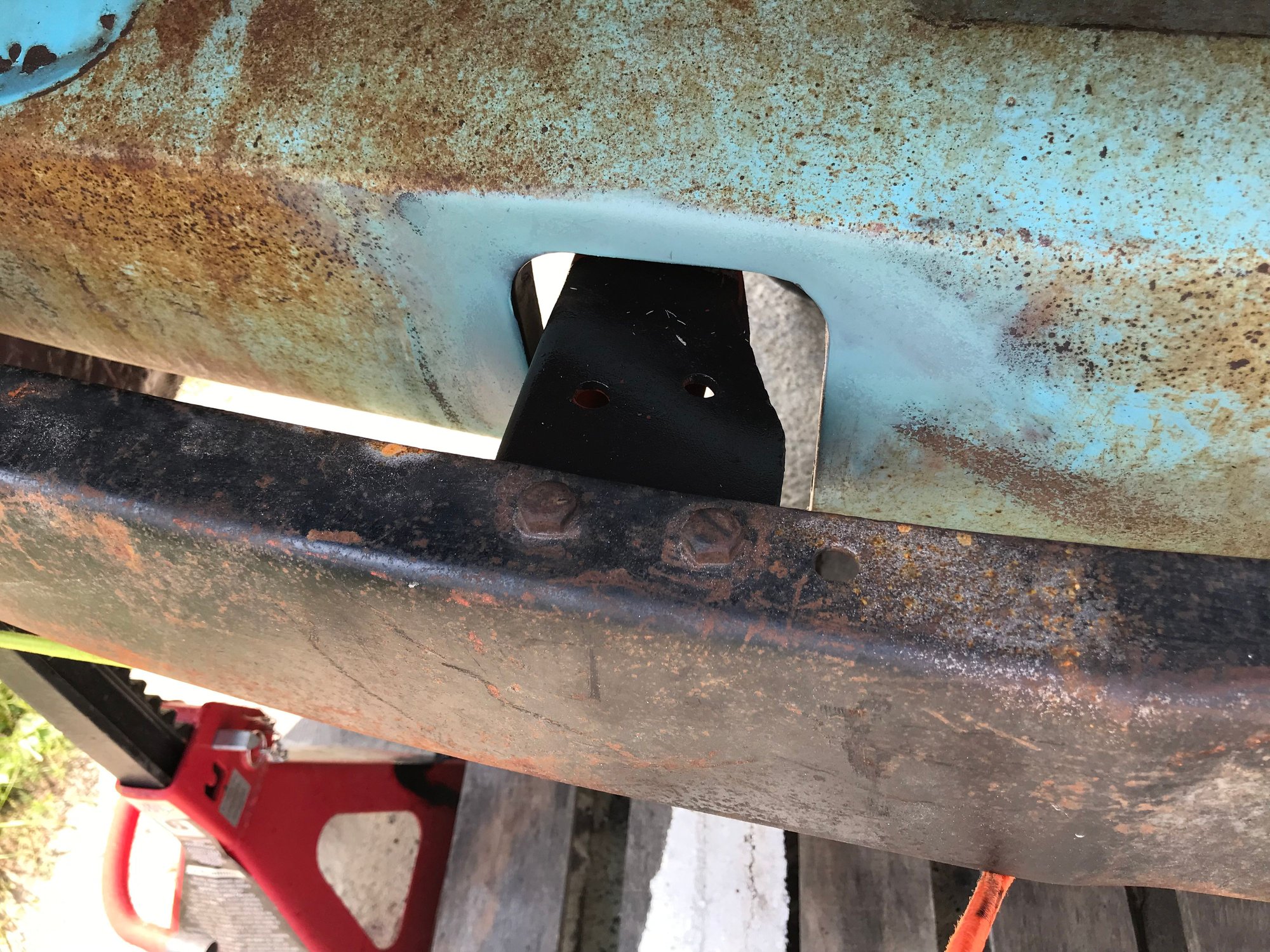

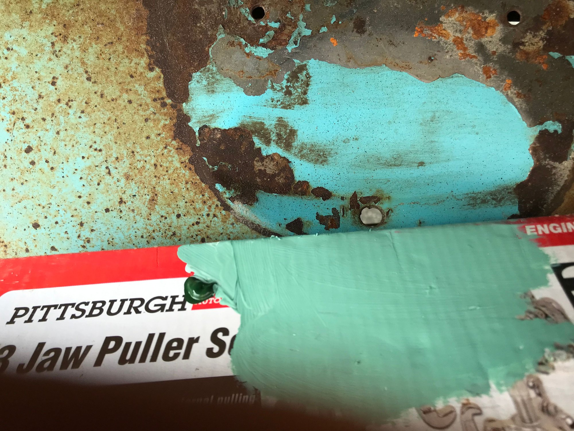

I bought some special green and some pure white Lindseed oil paint samples. I want to be able to “touch up” any bare spots or areas that could benefit. I mixed it up today and applied to the area where the frame comes through the front and the bumper connects. The sandblaster got a little too aggressive there and took some of the original paint off.
The color does not match the original color, it needs some blue added, but it matches exactly where the paint is tired and worn. I rubbed it on with my finger super thin to allow for a little rust to come back and match the whole panel. We will see how my experiment goes over the next year.

This is my custom mixed oil pAint applied to the sandblasted area. Looks pretty close to a perfect match.
Here it is compared to the original color. Not as good a match but I am pretty sure I could get it there with a little blue.

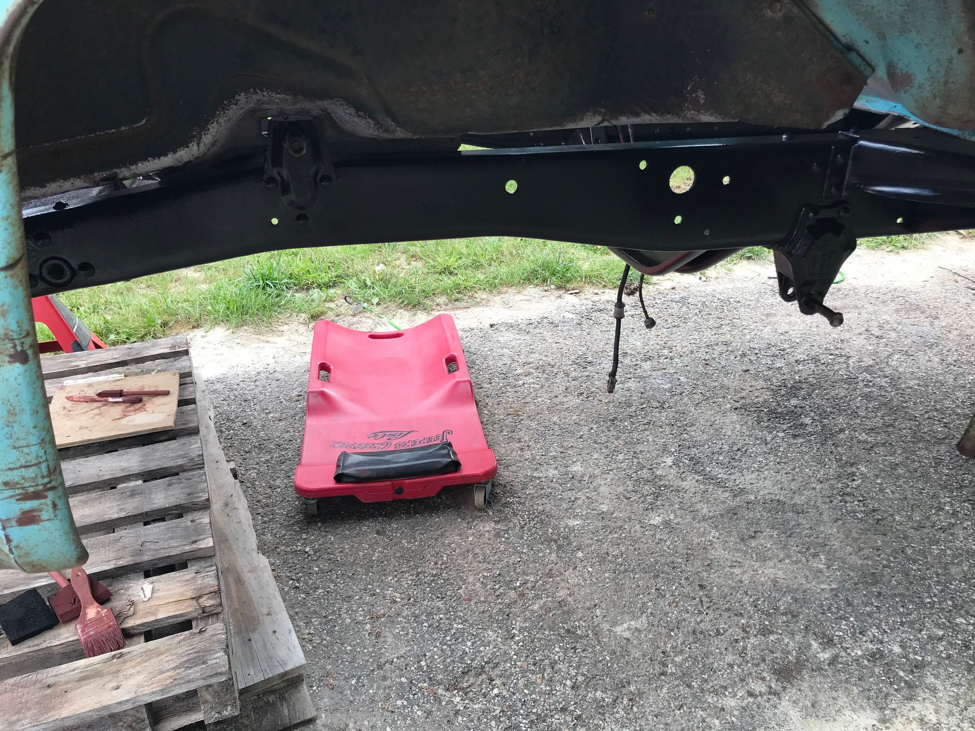

Originally Posted by Harrier
Looks great. I kind of regret painting my frame black. Whenever I crawl under the truck it is hard to see anything.
Black is stock, but having a lighter color on the frame would have made working under it a little easier.
You have me thinking about ordering a lighter color for the frame. A lighter grey maybe. It is definitely hard to see what’s going on with the black frame.

Keep it black. Just use a good LED light source.

A good argument can be made to keep it black. Having a lighter colored frame will make it more noticeable and that can be a bad thing as well.

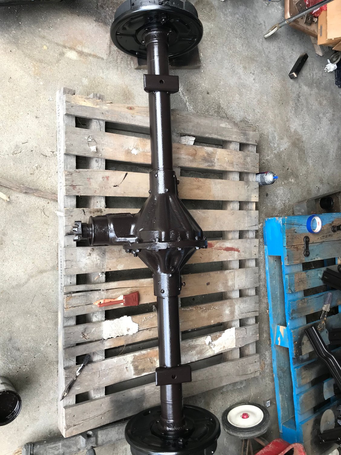

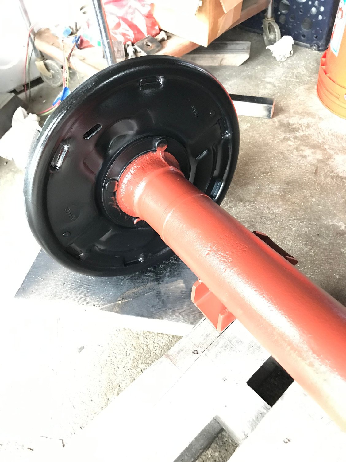

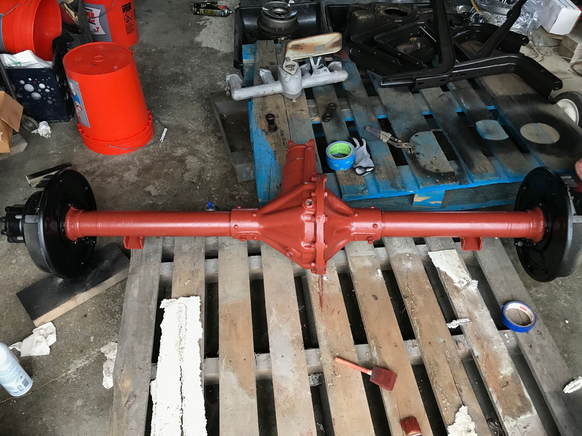

I decided to paint my backing plates with epoxy as it will be more resistant to chemicals etc. than the Lindseed oil paint. I painted the axle housings and pumpkin with 2 coats of the red paint. 2 coats of black to go.

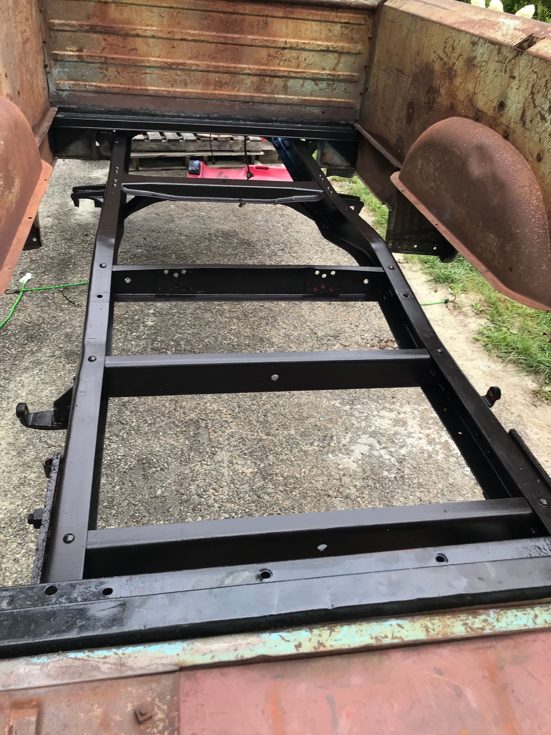

second coat of the red under paint is on the frame. The second coat went much faster than the first as it didn’t require the brushing in that the first coat does. 2 more coats of black to go. Should be finished next week weather permitting.
all the parts from my earlier post have had their second coat of black and are being put away for safe keeping until reassembly. Many more parts to go!

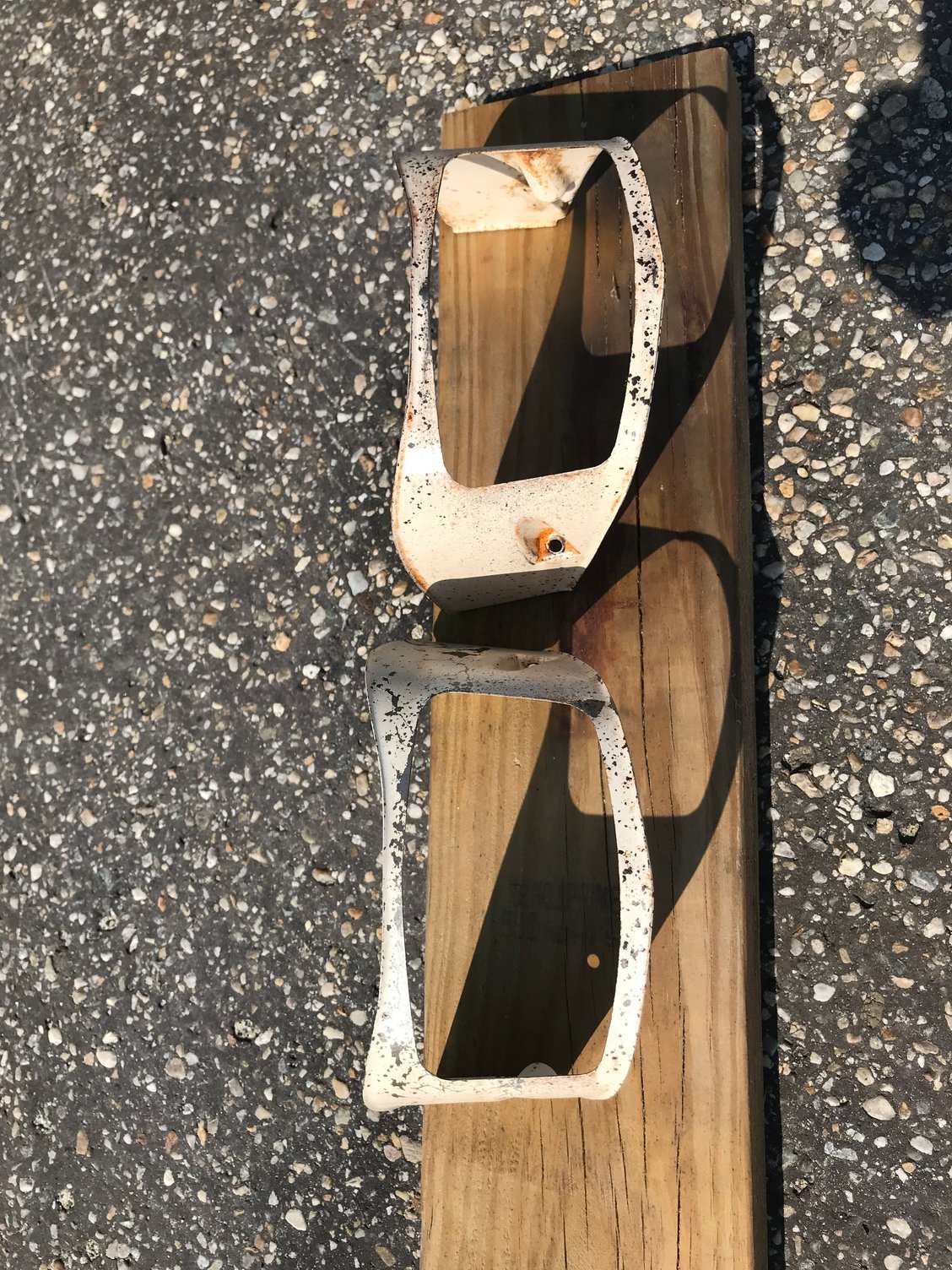

I painted my parking light housings with cold galvanizing zinc paint. There was some rust on them which I removed with rust 911. The inside was originally painted white to reflect the light. I painted them silver. I found out that I needed to let the paint dry longer between very thin coats as the zinc primer underneath started to wrinkle a little bit. I am keeping them as is. Maybe I will get motivated to sand them down and recoat them but I think they are fine.
Backing plate painted with VHT Epoxy paint.
Backing plate and 1st coat of red paint
After 2 coats of red. Black will go down in the next few days.

Completed lights Cold galvanized Zinc paint and silver painted lense reflectors.

First coat of black paint on the frame today. One more to go. I must say the frame disappears under the truck now. I did kind of like the rust colored paint but it is probably better that the frame doesn’t stand out.
I also got the first coat of black on the differential as well.
