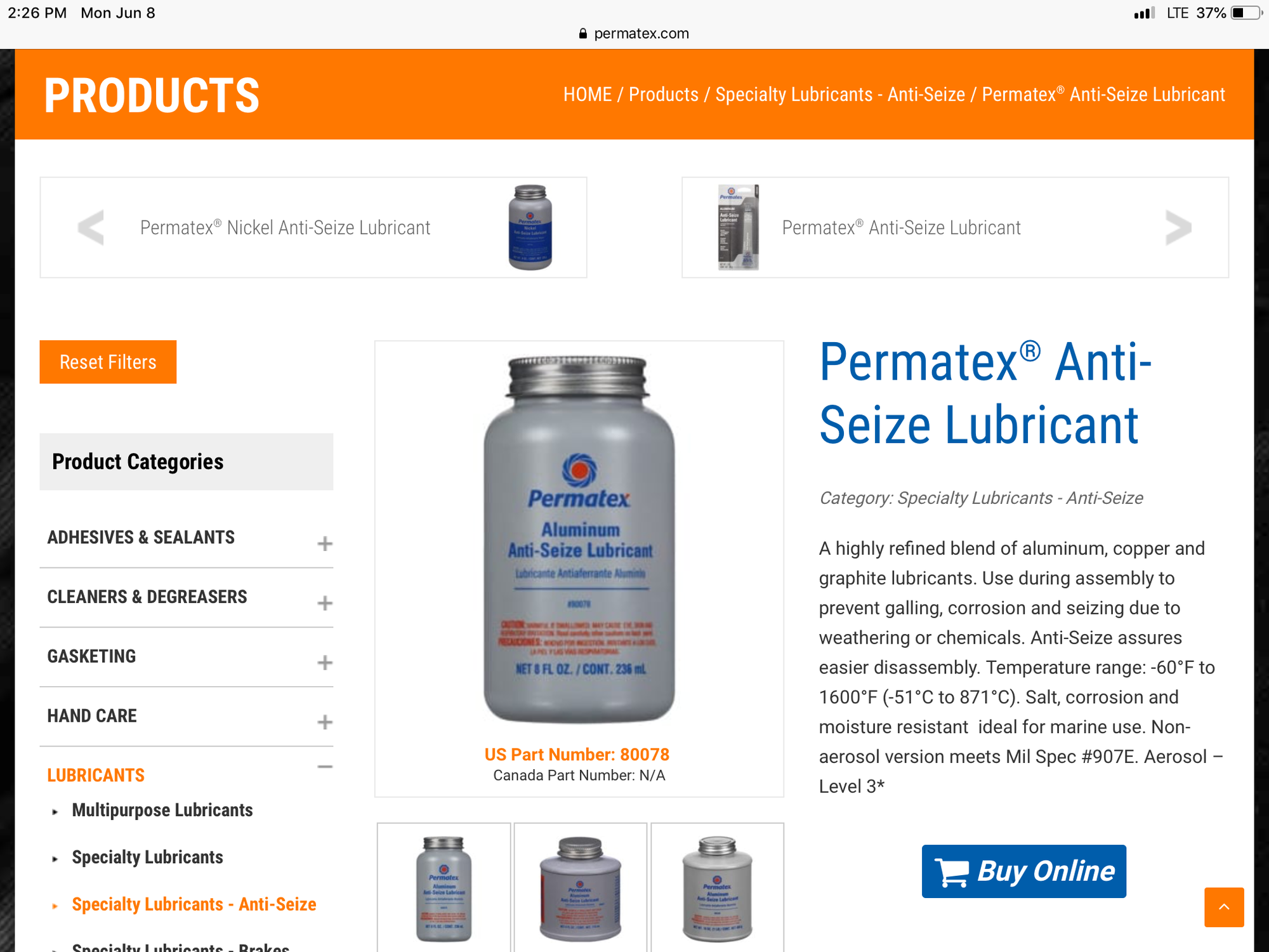

If you consider putting stainless in their place, stainless and aluminum don’t do well together. Mass quantities of anti seize may help. You have to get into specialized coatings to avoid this corrosion or galvanic action. McMaster has some ultra-resistant coatings, but I went with Zinc Yellow Chromate, which I believe is better then Ford/Int version. I also made sure the fasteners fit to the top of the treaded hole and used antiseize.

As for stainless bolts into aluminum, my go to is aviation prematex liquid. (brush-top can). I learned this a good while back working on marine outdrives and outboards.in saltwater applications. It works long term. There may be some "neverseize products made specifically for this , copper, maybe? but the prematex is readily available and works, at least for me. Some never seize compounds actually enhance the bad galvanic effects of these two dissimilar metals, at least in salt water.

This is what I showed I use between steel and aluminum in the vid. I’ve been using for years.

I use the same anti-seize as you do Jack.
