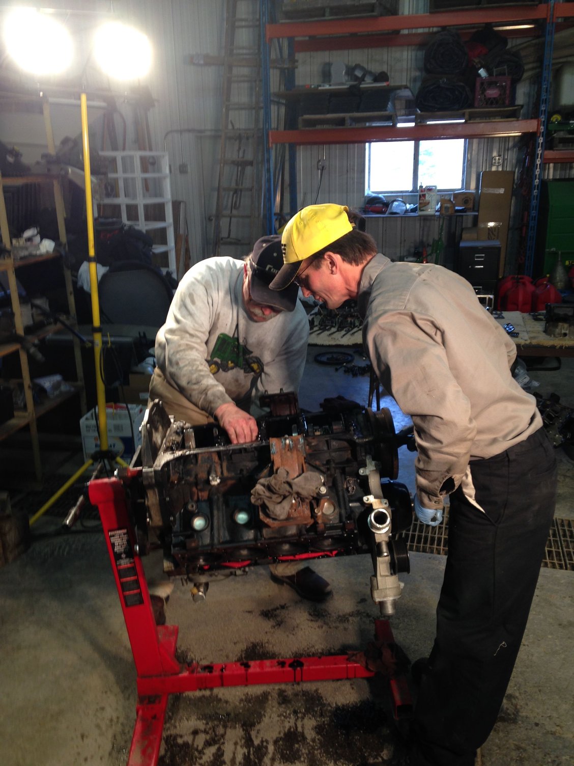

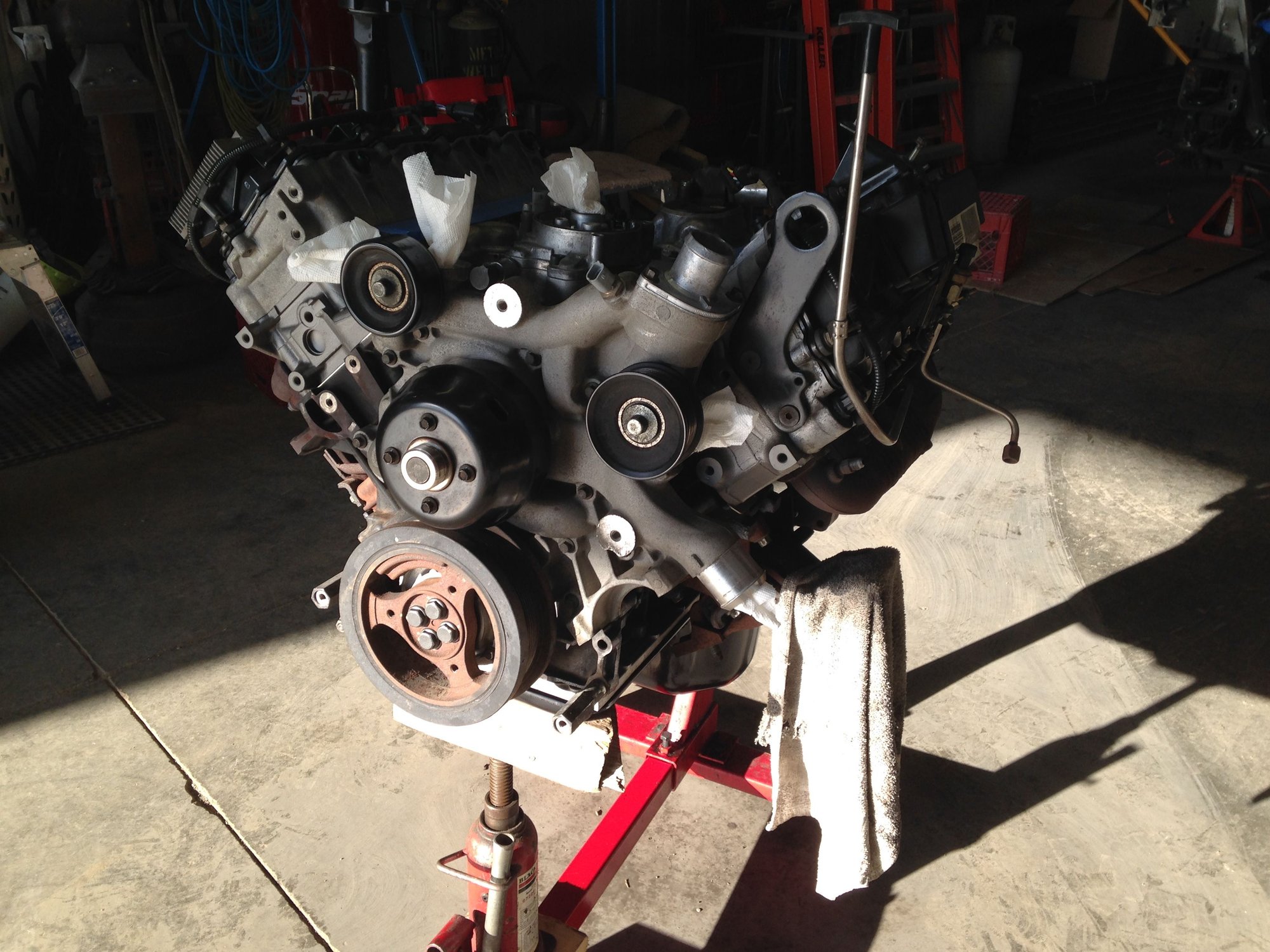

Engine is out! That was a full day affair.
What do you guys use for an engine stand?

I built my own stand. The majority of people have modified existing stands or built their own. For a single stand, you need 2,000lbs.

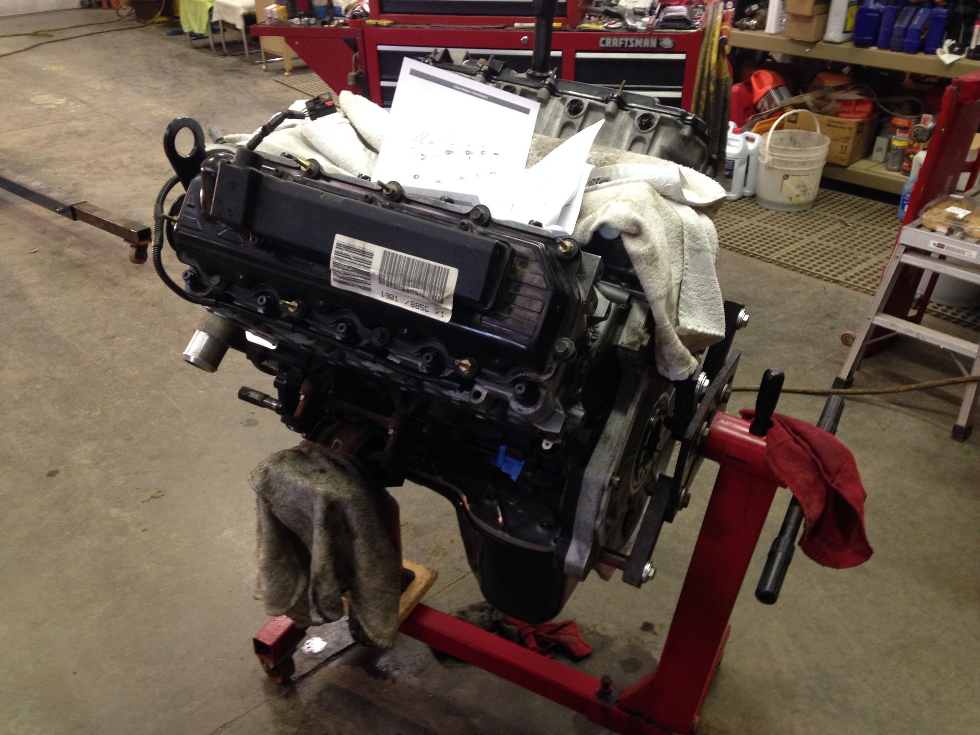

I used a regular engine stand, it my have been on the heavier side. I did put some blocking under the noise of the engine till I got the heads off to support the weight. After that I had no issues.
Buildup pretty much done.
The morning before it went back in.

I picked up an engine stand today - 2,000lb heavy duty stand from Harbor Freight. It was $107 + tax and thew that together this afternoon. I'll have to bring my dirty clothes into the shop tomorrow and try and get the engine hanging from the stand by tomorrow. Probably pull the passenger head and disassemble this weekend.
