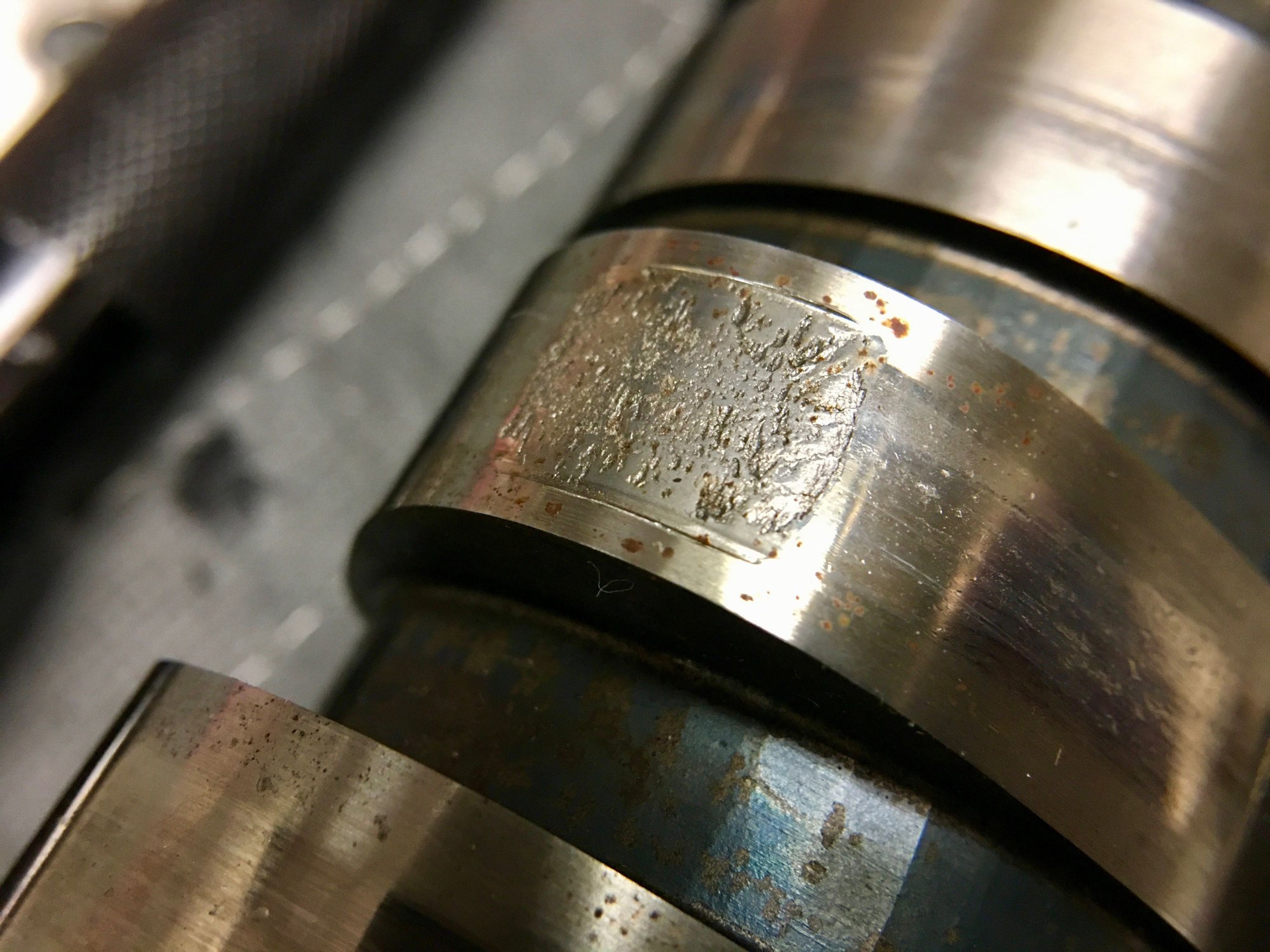

It's just weird to me what happened on the valvetrain side without any fault in the system. Some of the damaged lobes I've seen are only on the nose. I've got Dexter's cam and lifters here (from the org), the lifters look fine.
My limited experience, piston fault, or excessive pressures.
