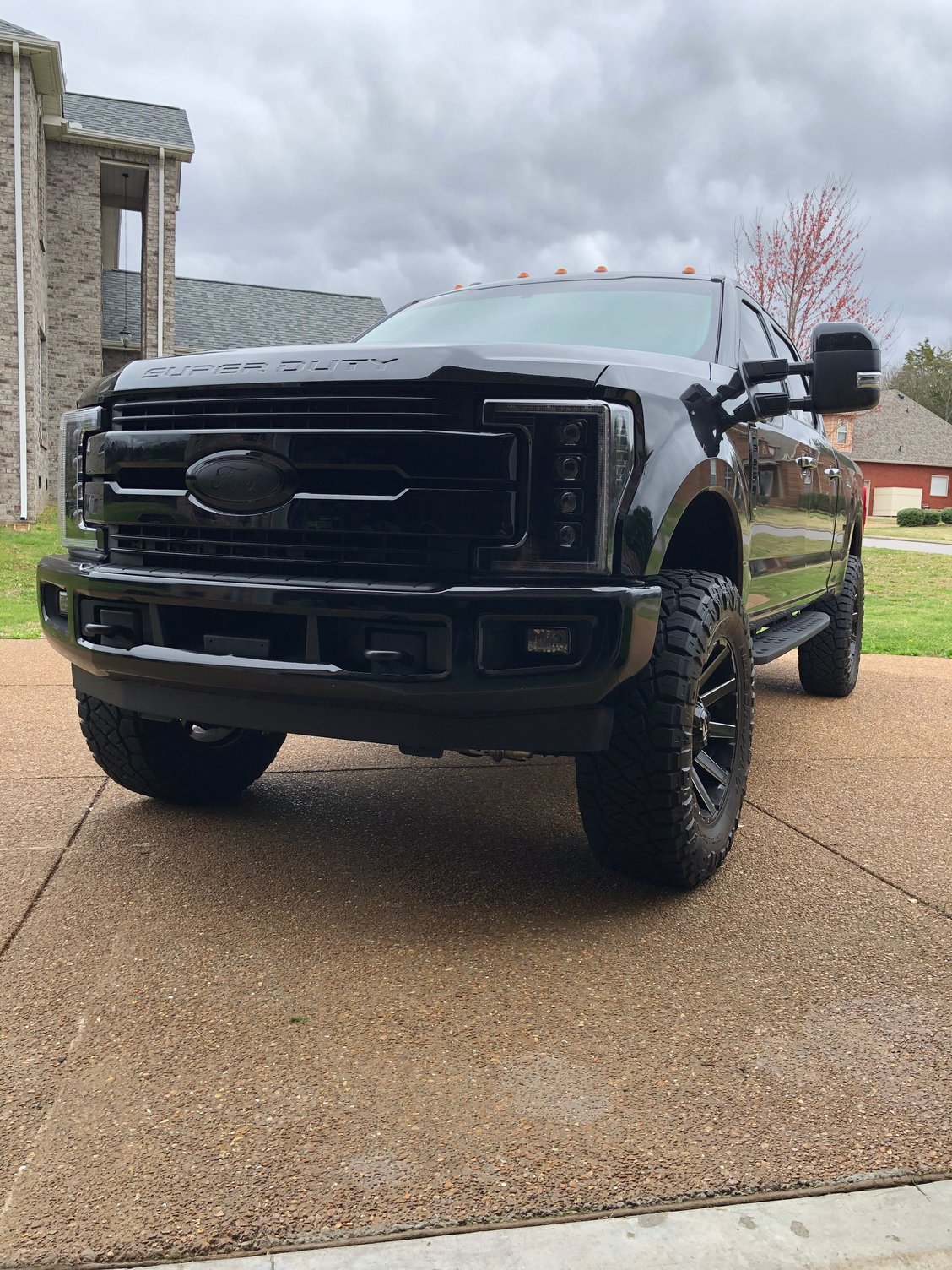

PatsfanTN's Avatar
PatsfanTN
Joined: Oct 2018
Posts: 300
Thanks! Here’s another shot that might give a better overall idea of how they look. The DRLs are BRIGHT and the sequencing blinkers are just so cool.
I’ve also contacted stage3 and they are working on getting me that harness fix for the fuse box.
