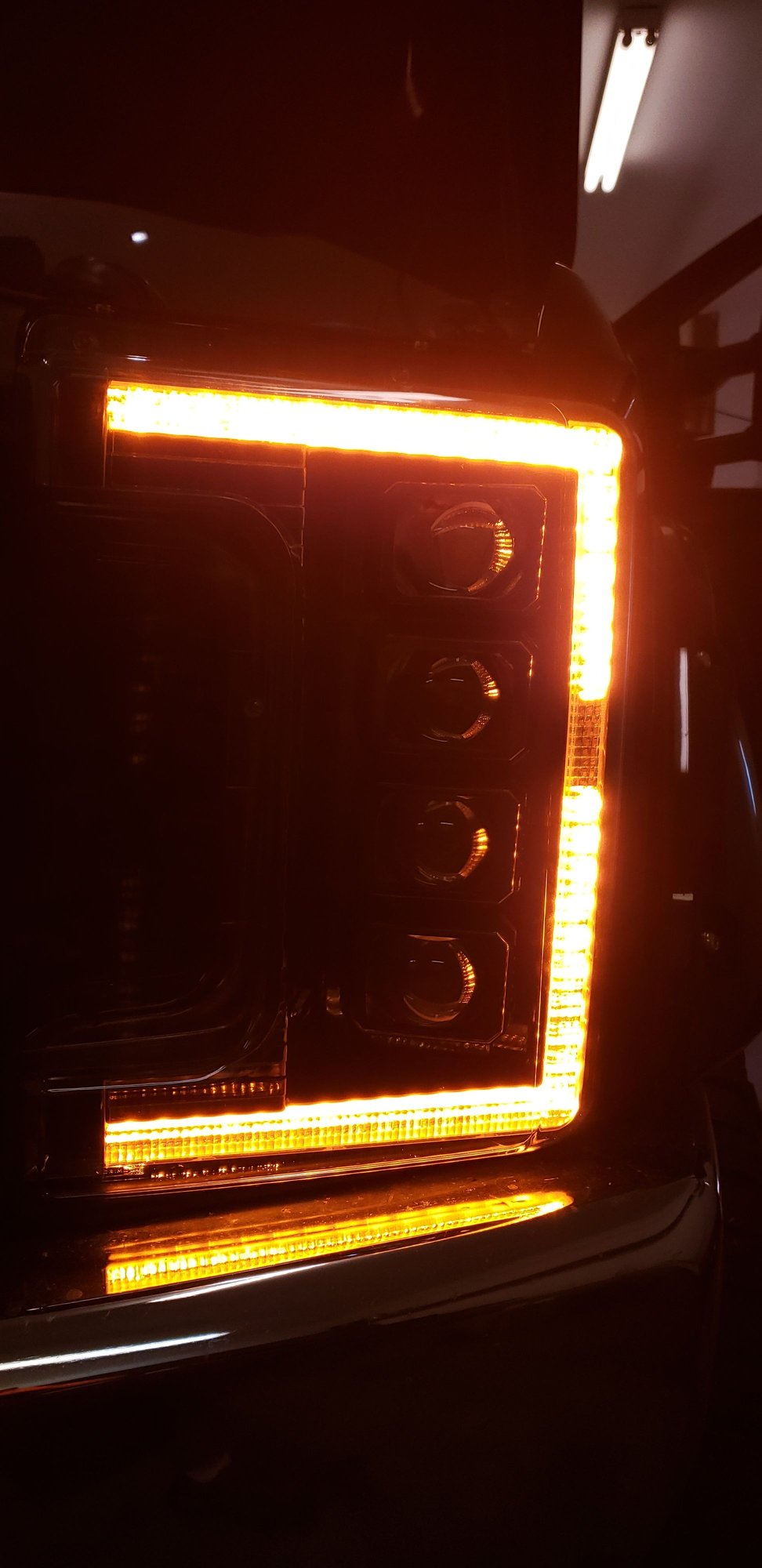

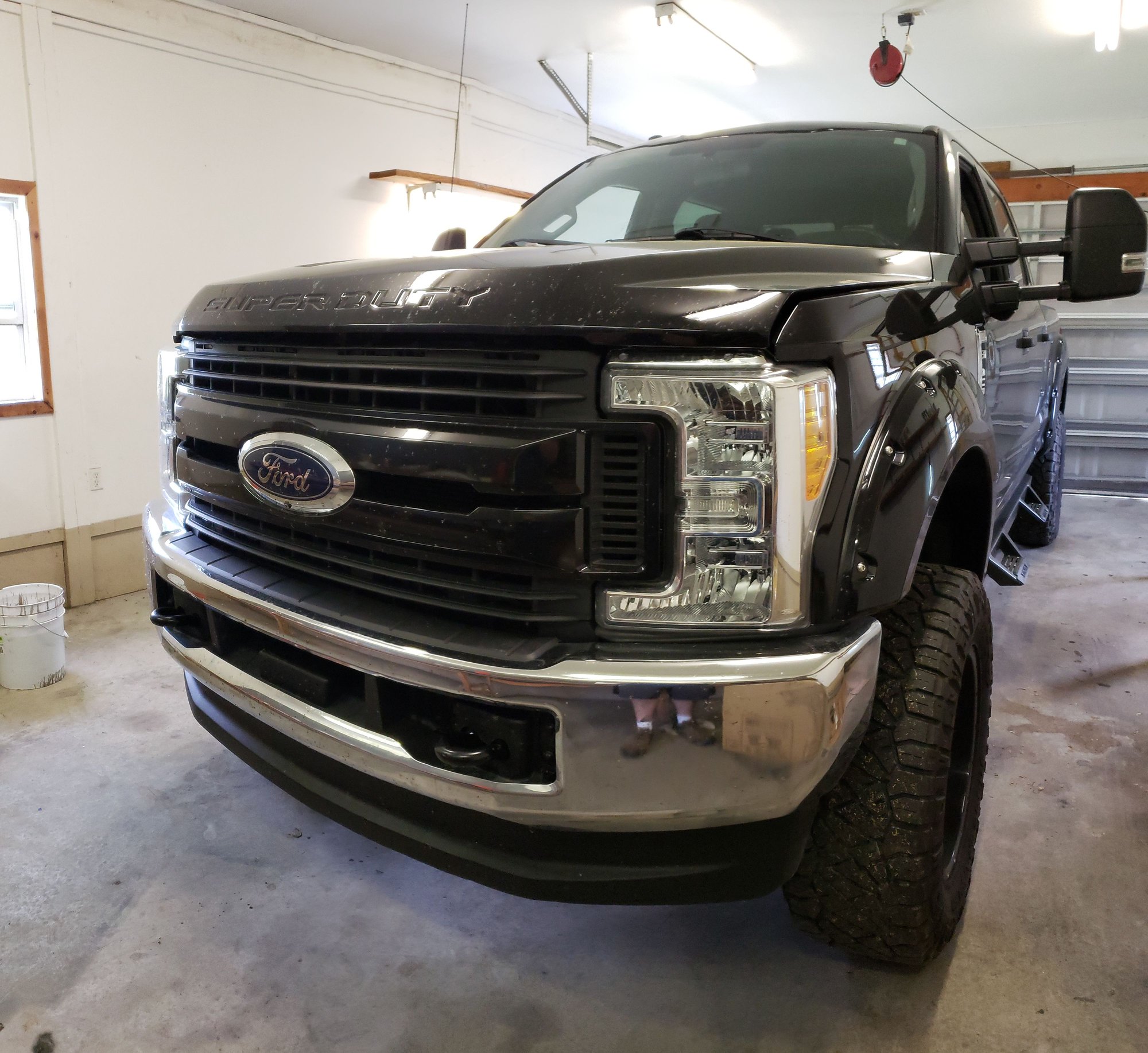

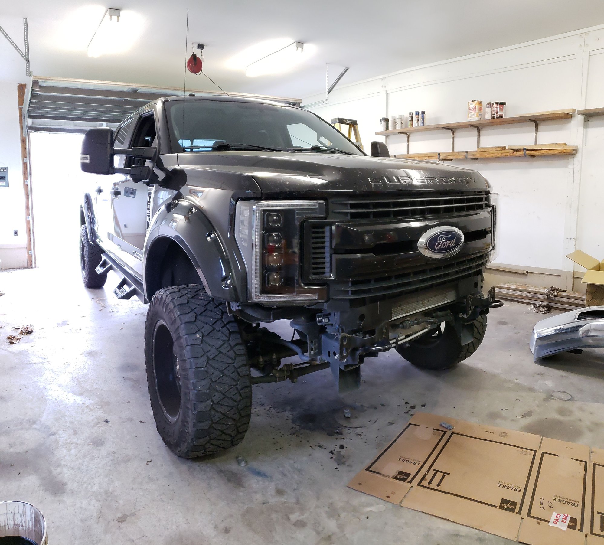

I guess I'll add my two cents.
I haven't read through the thread too much yet, but it seems like I'm not the only one who can't get the DRL harness installed in the fuse box. Doesn't fit the way they have it routed. I'm guessing this is whats preventing the 'bugatti' sequence because mine aren't doing that yet.
That aside, I have a bad set. One of the turn signal boards is dead. So I've got two issues, after waiting over 6 months for the headlights. Not really happy about it, HOWEVER
They look fricken awesome. I had been waiting to install my black bumper at the same time I did the headlights, so my truck got a hell of a makeover yesterday. Overall quality on the headlights I would actually say is great, despite the issues aforementioned. My only real complaint in the design is that all 4 LED's are aimed slightly lower of each other, so you don't really get the sharpest cutoff that you expect with a high quality projector. They are BRIGHT though, almost too bright I think lol. The beam is so bright in the center I think its actually burning my retinas a bit, from behind. It makes it quite hard to see things beyond the cutoff line. I'm definitely finishing my custom fog lights sooner than later, because these things kinda fail to light up the ditches as well as I expect, especially in a turn. They don't project very wide.
All quirks aside, I would still highly recommend these bad boys. 100 times better than the stock halogen pieces of **** that blind everybody going down the road.
PICS: (don't judge my aim, I'm not going to finish it until my broken headlight gets replaced)
