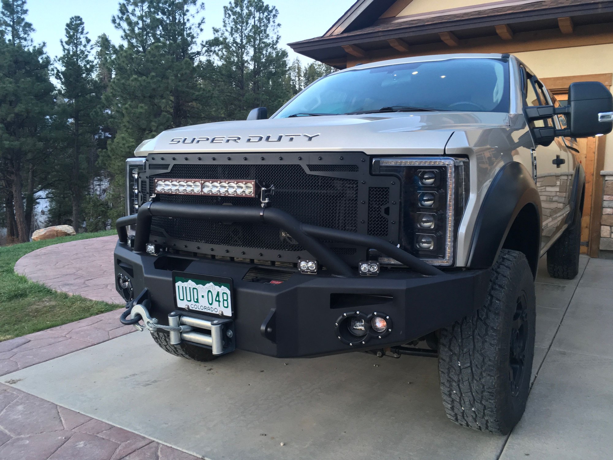

I finally got mine installed and yes, mine have the shakes too. My lights were aimed pretty much in line with my old halogen housings / LED bulbs so I haven’t done any adjustments yet. After an email, a rep from TRS guaranteed me that one to two full turns clockwise on the adjustment screws will tighten them up and they won’t vibrate anymore. I’ll report back when I do this next week.

I had the same question that you did. The rep from TRS told me that I will still be able to aim my lights properly. He said that it's hard to explain but the horizontal adjustment will also affect the vertical adjustments as well and vice versa. I will report back as soon as I make the adjustments. The light output is amazing and they have a great cutoff. Once adjusted properly I believe you'll have great output without blinding oncoming traffic.
