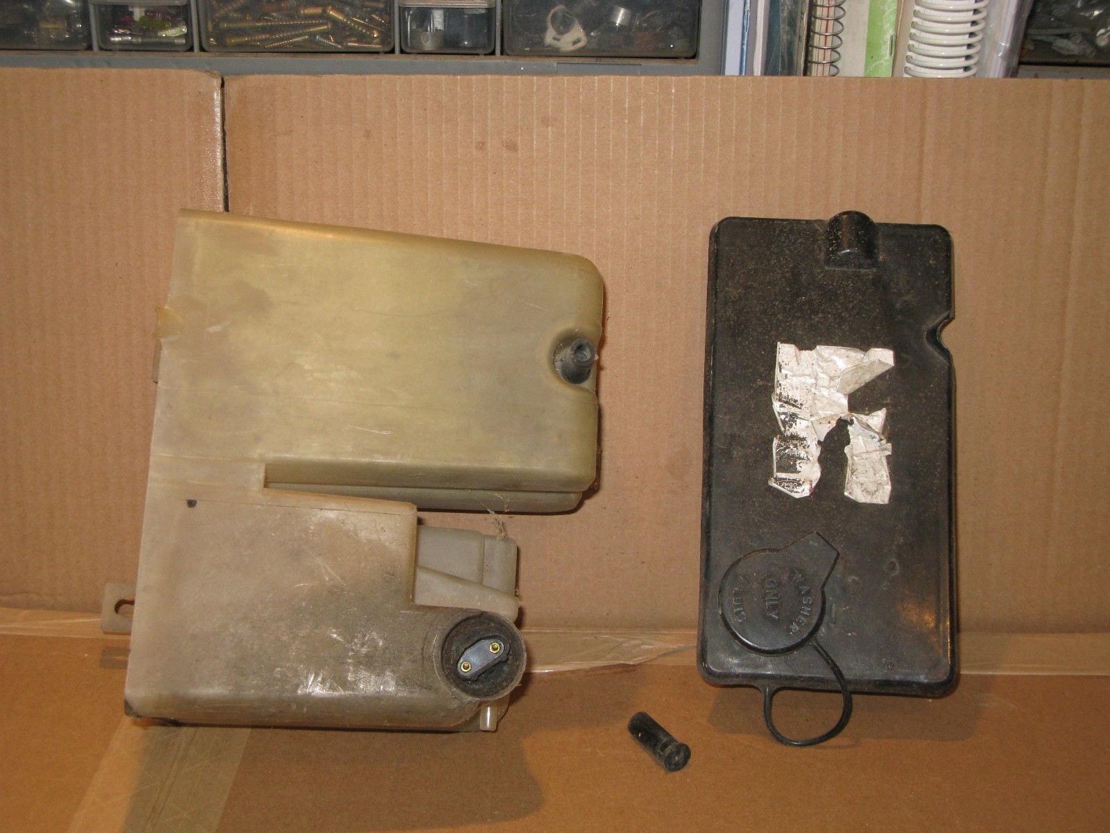

I'm not sure on the water pump. Need to get some power steering fluid to see if its good. I'd hate if it leaks after I fill it.
ICM and a reservoir but i don't know for what
The only thing that works is the speedometer. The oil pressure sensor and ampmeter for the battery works.

The reservoir has two compartments. The one nearest the front of the truck is an overflow for the radiator coolant. The rear section holds the windshield wash solution.
