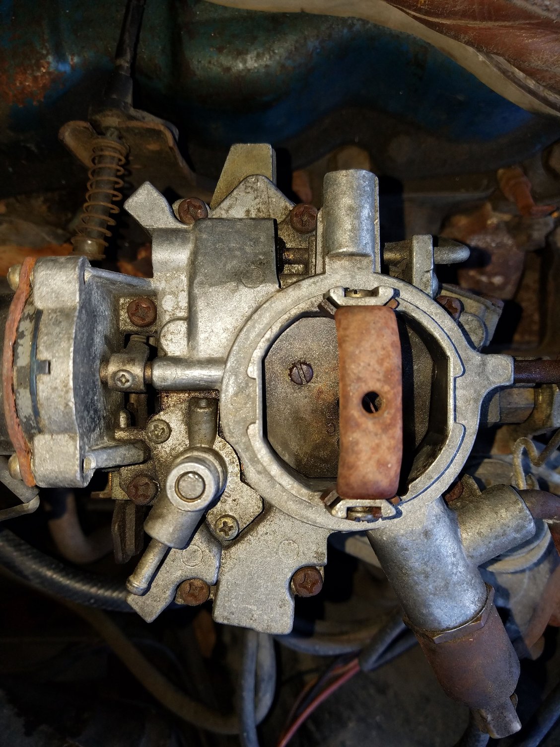

Alright. Im about to check if my soarkolugs are fouled and if they creatr spark. If there isnt a proboem with the spark aspect , then the carburator rebuild kit is next

Because this is how carb looms like
