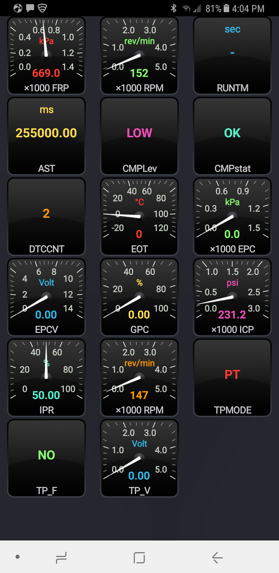

Ok i got my adapter to work I had to almost be touching it with the phone and i took a screen shot both batteries were fully charged and rpms were around 160
Old Dec 14, 2017 | 06:39 PM
  #113
madpogue's Avatar
madpogue
Joined: Oct 2003
Posts: 8,476
Likes: 37
From: Madison, WI
ICP is low. How long had you been cranking when you took this shot?

10 seconds and it's was close to freezing out

I'm pretty sure after 10 seconds of cranking, you should have at least 500 psi ICP.

So i put 150psi of air to the heads and there sealed up tight. Tested the coil on the ipr it tested fine. It's either an hpop problem or ipr problem. I made an adapter to test the heads the quarter turn valve saves me from a mess
The fitting in the head has a jamb nut so u can tighten it up at any angle
