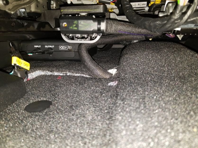

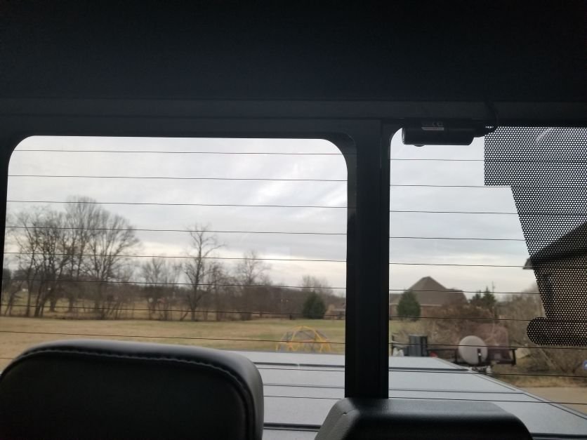

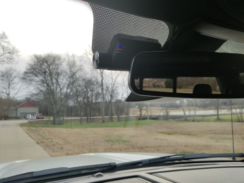

Originally Posted by Brother_Bluto
Finally got around to installing my F800 Pro (front/back). Picked it up at Blackboxmycar.com on black Friday. Install was fairly simple, just time consuming to do it right. I wanted to mount it on the passenger side with the camera lens in the "L" of the webbing... but the wide angle picked up the window webbing all the way until I was mounting it completely off the webbing. Power wire run along passenger headliner and down pillar. Wire for 2nd camera ran along driver headliner and in the headliner across both doors.
The add-a-fuse was the only thing it throw me - turns out it has a bit of plastic to be trimmed off to get down to same size as a fuse and then seated fine in the passenger fuse panel. I also bought the Cellink B battery as it will provide a longer parking time than if hardwired and using the built-in low battery cut-off. I mounted that under the passenger seat - perfect fit and easy run of wire to the fuse panel - just followed the existing wire loom under carpet to door sill and back to panel.
All in all very happy with it. Clear, bright picture even in the dark.
I have to give you Kudos for a clean and stealthy installation.
If that location doesn't interfere with the sensor on the driver's side back of the mirror I'm going to mount mine in the same fashion. Did you have any problems with blocking the sensor? I'm assuming that it's purpose is for auto-dimming the headlights which I wouldn't want to give up.
