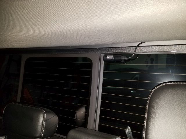

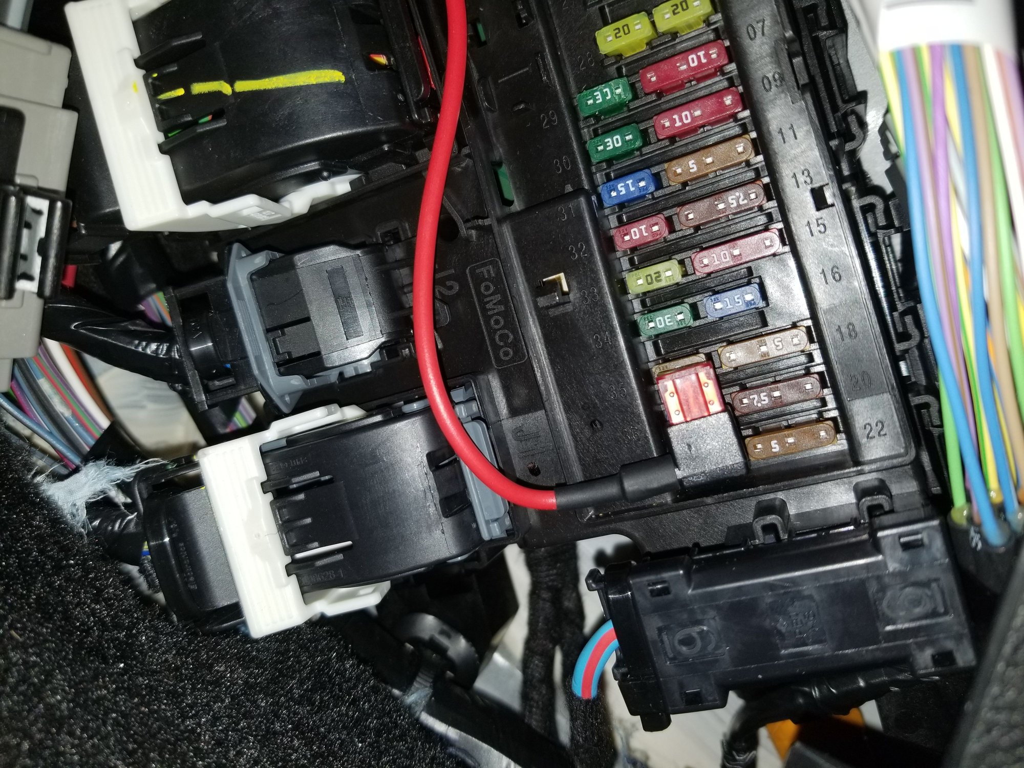

Installed a Thinkware F770 yesterday, thanks to the feedback in this thread. I connected it to Upfitter SW1. Like others have said, would it have killed 's profits to make those pass through wires twice as long in the passenger footwell? Just ridiculous that one needs to be a contortionist to #1 Get to the wires, #2, get that damn tape removed, #3 strip the insulation.
Anyway, I checked where the wipers cleared the windshield, so the front camera would have clear vision in foul weather. I ended up mounting mine left of the rear view mirror, so I can access the buttons. Didn't care that the alignment grid when viewed through the app, wasn't centered.
The rear camera, make sure it is installed with the writing, upside-down. I tried routing above headliner without luck. Ended up routing along passenger side, under sill plates, up the c-pillar and tucked it up under the headliner along the back.
Even thought the wire looks like its going to the drivers side, its not. The extra cable is stuffed under the headliner, and goes to the right side of the truck.

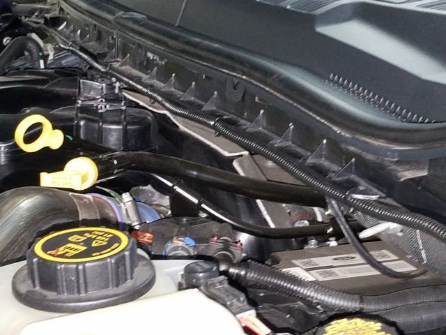

I wired the camera's ÄCCY power wire to Upfitter SW1 by running a wire from the Upfitter bundle at the fuse/relay box, along the cowl, to the pass-through wire on the passenger side. The wire is in 1/4"split-loom, ziptied to the cowl through 1/8"holes drilled in the plastic cowl.
The split-loom shown zip-tied to the cowl. If or when I need more capacity, I'll snip the zip-ties and use a large diameter split-loom. 1/4"was great for one wire.
Close up of the drilled holes for zip-ties.
Holes were drilled about every 6-8", so they looked like they belonged there.
