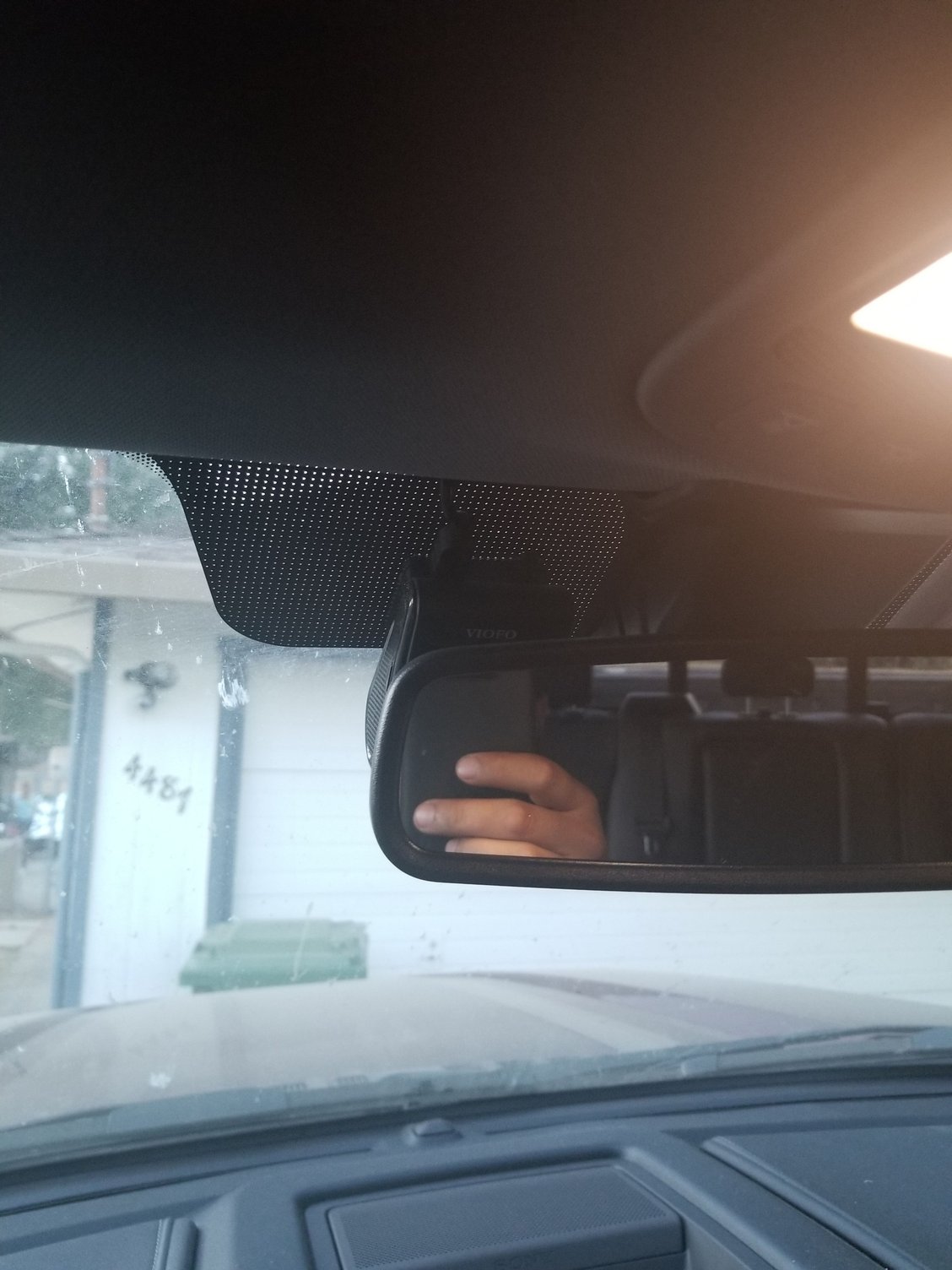

I "hot" wired my dash cam - since it has a parking mode, I want it to be on all the time....I picked up an always on circuit in the passenger side kick panel....the same could be done by using the up fitter wires in the same (passenger side) area.
someone was asking about mounting/sun shades earlier...I mounted mind on the passenger side (to avoid interference with the auto dim sensor in the rear view mirror - and because I will eventually mount my Valentine 1 on the drivers side).
as you can see - the Dashcam is nearly invisible from the outside.
the Mounting location is to the right of the the lane departure / rain sensor (scoop) because it has such a wide angle, if it were mounted closer to the sensor scoop I'd end up having the plastic blocking the lens/view.

Thank you! My father-in-law and I spent quite some time figuring out the best location for our use.
Originally Posted by ngatiger
I also have a 2017 F350 and am looking at the same dashcam. Why did you install it below the grid in the glass higher up??? Would the GPS be blocked if it where higher? It would seem to be less visible higher up with only the lens below the grid dots. Thoughts???
The camera was installed below the grid dot for a few reasons:
1. The camera install was only temporary (three weeks). We wanted to make sure the VHB wasn't going to be a pain to remove from the grid dot.
2. The location allowed for easy manipulation of the buttons and great screen visibility. Theft (exterior visibility) was not really a concern.
3. The wipers clear the field of view perfectly.

Originally Posted by flanneljunkie
Viofo a119s mounted in a 2017 f350
Same setup
I just went little higher to make it harder to see it from outside

Originally Posted by Robeleo
Same setup
This is where I mounted my Viofo also, but on the right side of the mirror.

Mounting it on the left (drivers) side of the mirror could block the sensor in the back of the rearview mirror...there is no sensor on the right (passenger) side.
