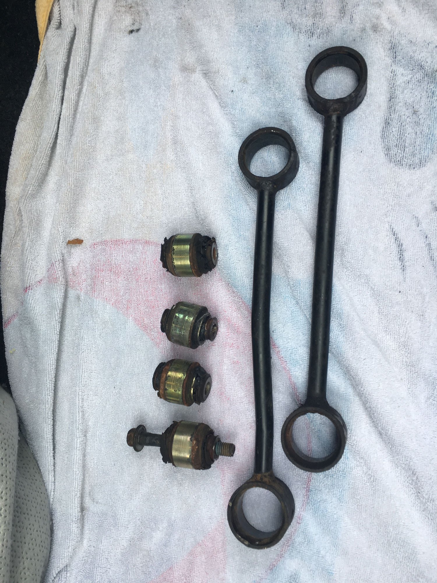

tried being useful today. went and paid $245 at Autozone to "RENT" their ball joint tool. and immediately returned it after 30 minutes in the parking lot pressing the endlink units out. Wish they followed their old policy of just holding an ID
anyways, I looks like I accidently bought a rear sway bar rebuild kit by accident. be a few more days until I get proper kit, or just buy new endlinks.
damn things look like factory original from 2000
Here is the Rear Swaybar Endlink kit that is useless to me
