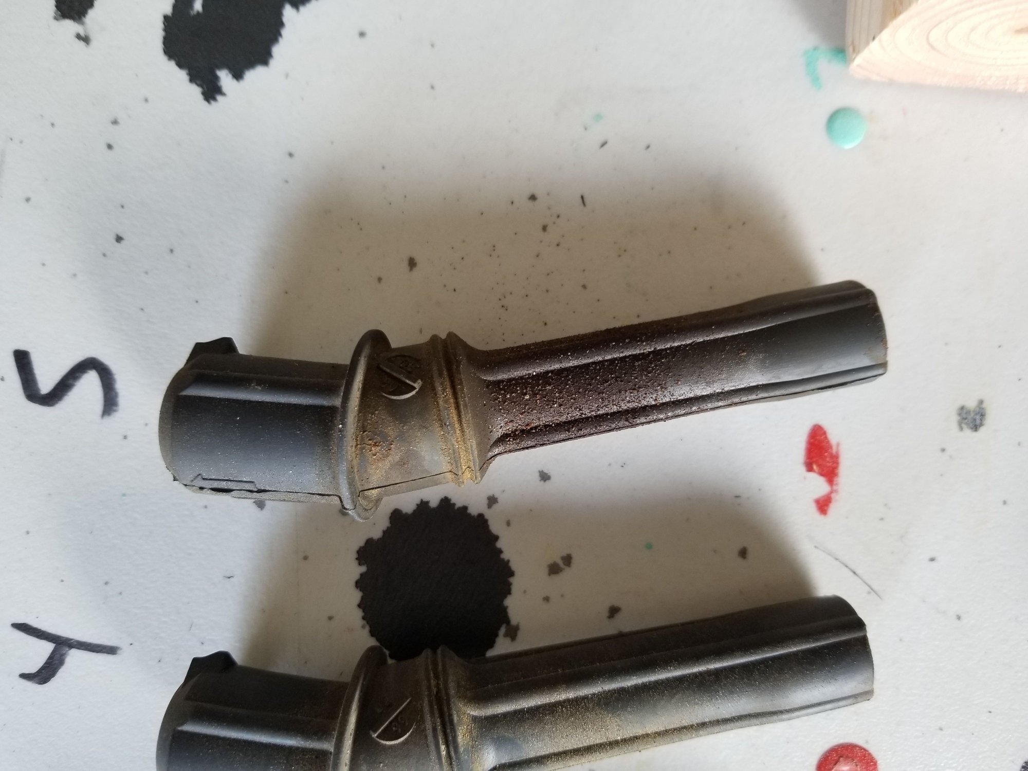

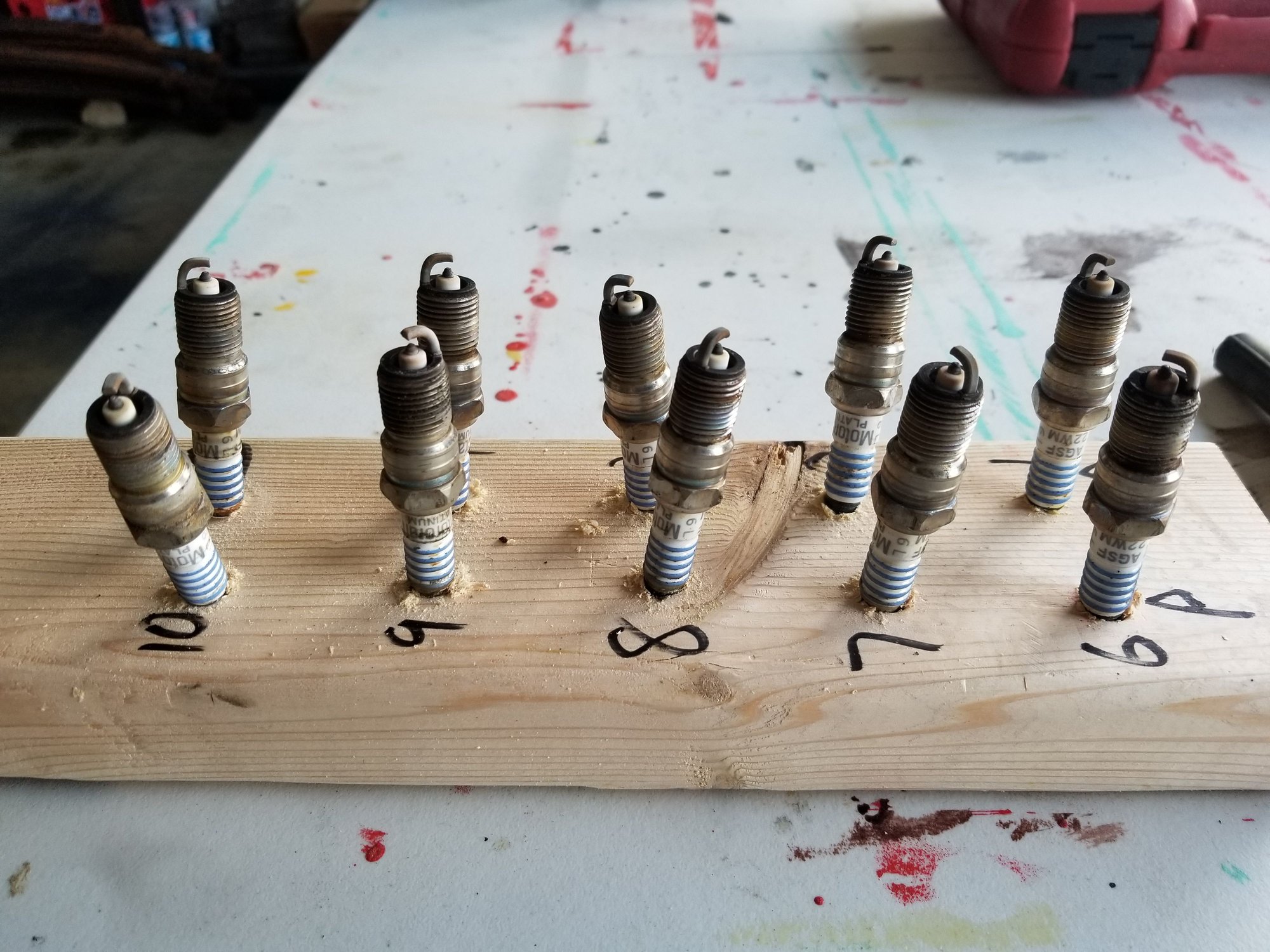

Finally did a tune-up after 11 months of ownership...lol
8 plugs (SP-479) and new no name boots
damn new plugs were all gapped >0.060". I re-gapped each to 0.054". spec on the passenger head says 0.052" to 0.056" gap. I always check gaps, but this is the first time I've ever actually had to adjust the gap...well in probably 20yrs anyways.
lubed the seating surface and threads with neolube. installed and torqued to 22 ft-lbs
got to break out this awesomeness here. lots of gunk in and around the plug holes. it's 5/8" fuel line from Autozone. it fit the plug hole almost perfectly.
Found a few issues though. Not happy with it, but damn glad I caught them before it could escalate.
1. plugs for cylinder #5, #8, and #9 were all loose. #5 was 1 full revolution. Other 2 were less than 1/2 a turn. You can see the crud on boots for #5/9. Threads were gunky as well
2. basically found that the plugs aren't 18yrs old. But they aren't spring chickens either. .060" gap on 7 of them.
3. #2 COP is a no-name. seems to work though
4. #7 COP has a crack in housing. no misfires. thinking I'll seal with silicone and leave well enough alone
5. cylinder 5 and 10 have evidence of water intrusion below the boot. So I very liberally applied silicone to the boot where it seals to the head. hopefully this will prevent water from getting down there. Probably going to apply Brents cowl mod at some point this weekend.

I think that cracked #7 COP will be OK with a bit of sealant on top, does the one below it in the picture also look to have a smaller crack too? Maybe move the cracked and sealed COP(s) to the front dryer positions as an added measure of protection.
You were very lucky with that loose plug!
Have you noticed any improvement in performance with the new plugs?
If I tried that shop vac and fuel line deal I'd be picking that micro fiber towel out of my shop vac instead of cleaning out the plug wells, my luck........

#6 cop doesn't look cracked. I'll check again when I'm under the hood today
Performance wise, the lie-o-meter is already back to near 10 mpg. Has been sitting 6.4 mpg for past 6 months. Same gas still in the tank, so I'm thinking she likes the smaller gap
More importantly though, I had 3 rumble/vibrations. 38-42, 62, and 69 mph. The 38 and 69 mph seems gone. I've been chasing my tail to eliminate these for months. Had read recently that an engine miss can cause vibration. I'm really hoping that's the case lol. I'll give it a week to see if they're still present
Monitoring via Torque shows nothing
