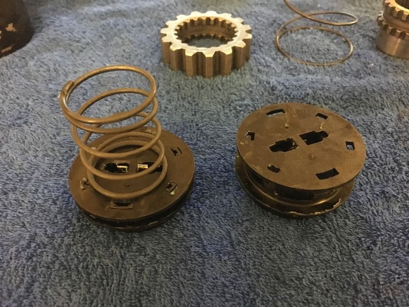

Pulled the locking hubs out to clean and see what the issue is. Drivers side has been stuck engaged
the last guy in here put it back together wrong. the spring belongs sandwiched between the plastic pieces. Both hubs were also lightly greased with green stuff. It wasn't grease anymore, thicker than peanut butter. and many of the moving surfaces had zero grease at all
found this. basically the last guy in here put it back together wrong. the spring belongs sandwiched between the plastic pieces. Both hubs were also lightly greased with green stuff. It wasn't grease anymore, thicker than peanut butter. and many of the moving surfaces had zero grease at all
You can pull the ***** and grease them too. It makes them turn much easier... https://www.ford-trucks.com/forums/1...9-04-hubs.html
I had no idea. Very useful, thank you
