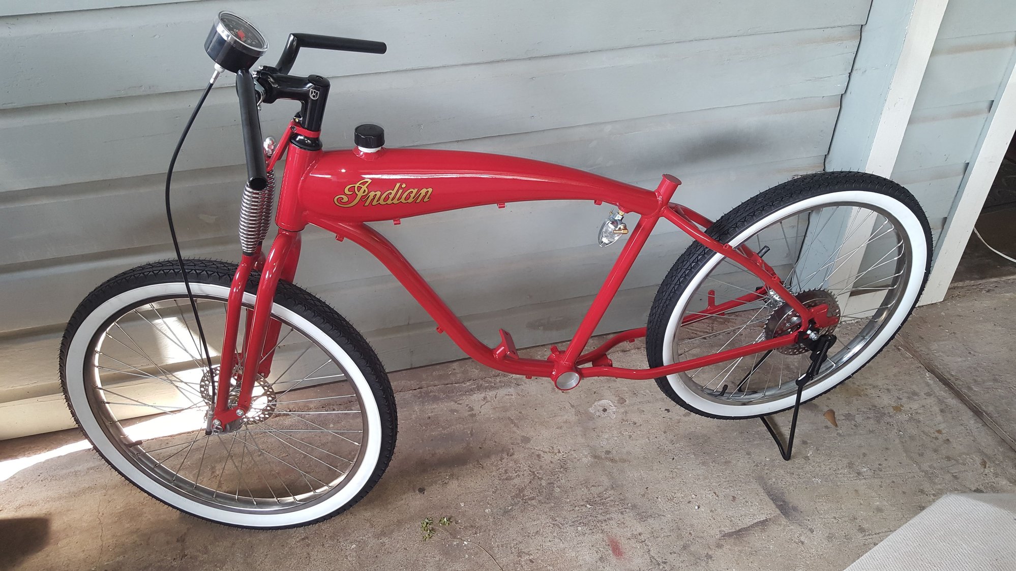

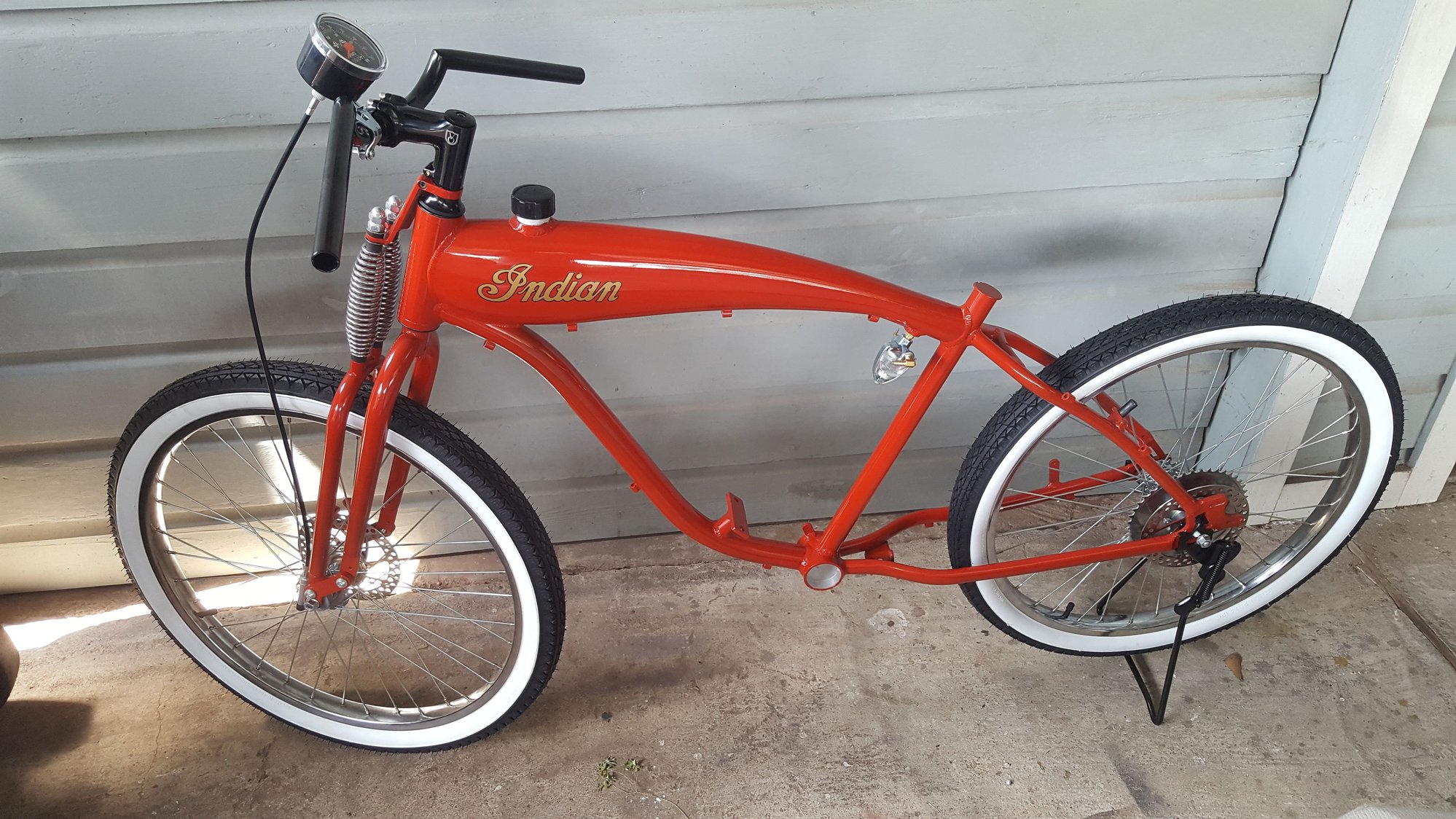

Well the wheel was finished when I went in today. Apparently it was finished earlier in the week but no one called. No big deal. I got it all put together only thing is the stupid drop kick stand wont fit the frame without modifications as the locking ears to lock it around the drop out plates doesn't line up fully. So I have to pull it back off and tweak it some and bend some ears up or just simply remove them to get the bracket to lay flat. Right now because its not able to sit flat I cant get the rear axle to slide forward its currently bolted down at the rear most position.
In any case I had the bike out side today for a good 3 hours as I used my Meguiars Ultimate compound on the entire frame still got a few spots I need to work by hand some more before I can start applying polish and wax for protection.
I'm still awaiting the new threadless stem I bought that is 41mm tall and the 20mm and 15mm gloss black aluminum spacers so I can raise my spring perch up 20mm to see how that is if need more I will raise it the full 35mm. I how ever right now am fixing to hit up some stores online and order some more parts. I got out of the bike shop today for $115, the wheel was $56 they charged me $6 more than they quoted and didn't charge me for the spokes I guess they decided keep the old spokes and the coaster brake hub and cut me a deal on it. I did how ever buy a 15mm and 17mm axle cone wrench so I can adjust the front bearing pre load, I also want to take it apart and clean the ball bearings off and apply my Lucas red and tacky over the thin grease that is in there already. I also bought for $29 a 7 paw freewheel cog with 16 tooth count. Its noisy as hell and loud as it has strong ratcheting on it so I will have to see how it goes if not I at least know the axle is a british thread so I can always replace it for a weaker ratcheting one that is quieter.
The 17mm worth of spacers on each side of the axle centered the hub in the frame perfectly but to center the rim the wheel should be dished about 1/8" to the left as the tire is slightly off to the right. I wont be worrying about that unless the tire is rubbing the fender when I order them. My disc brake rotor how ever is with in one finger width from the brake caliper mount just like it is on my front fork so I don't have to do any shimming what so ever. Just need to buy some more cheap parts so I can do more and continue saving up for the more expensive parts such as the engine and saddle.
I'm still kicking around what to go with for my crank and chain ring. My freewheel sprocket is chrome but its not real shiny chrome just like a silver color. Not sure if I should go with a silver colored chain ring with black crank and pedals or just go with my gut and go black on everything if possible.
Anyways here are some photos I took today.
First one is with flash
Second one is without flash
