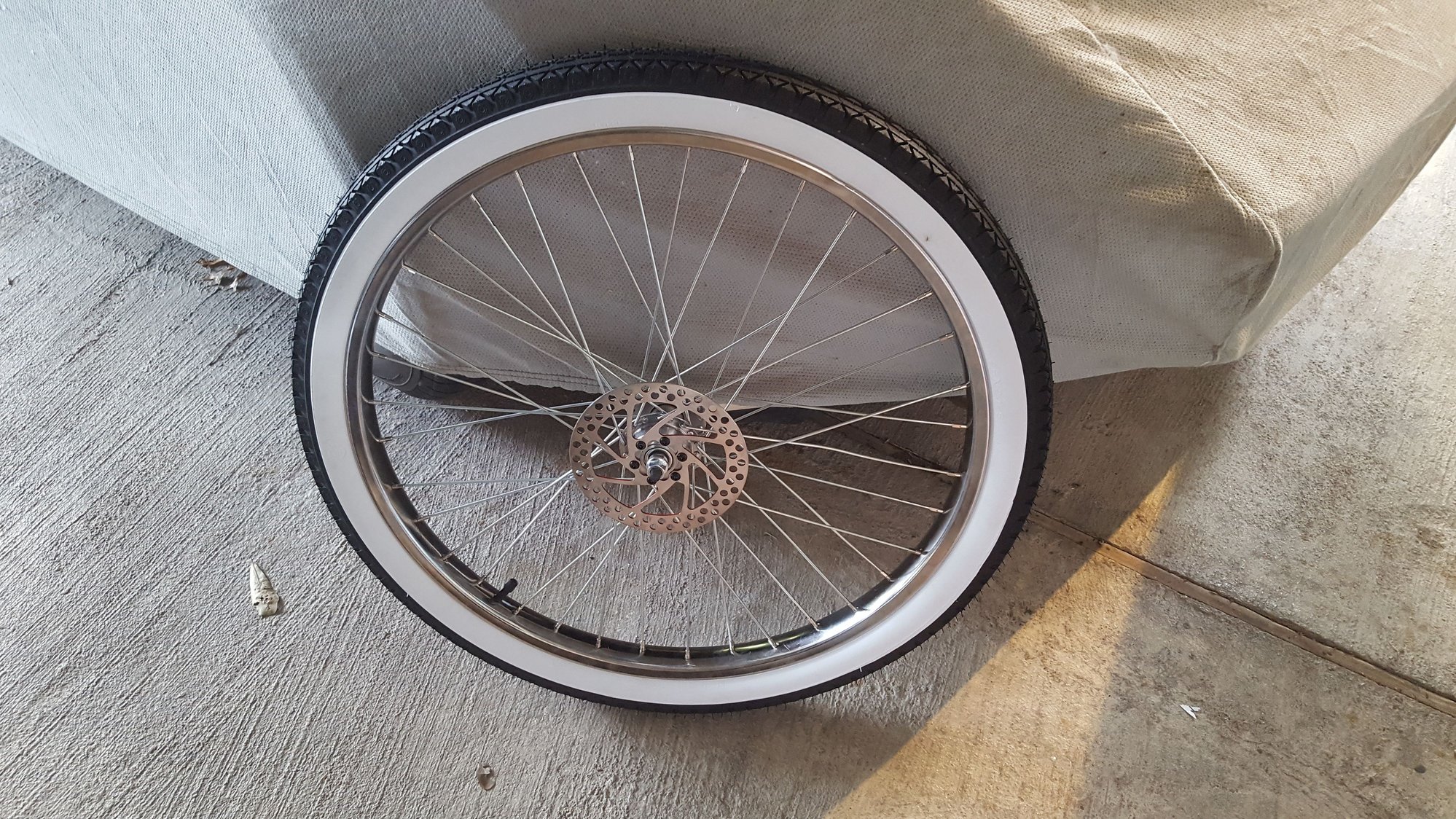

Aside from that bike shop called today at lunch they wanted to ask about the wheel job I had with them. They switched systems and the guy wanted to find out whats going on with my wheel. Asked me if I have been contacted, just told him I called last Friday was told it was scheduled to be built that day and would be finished that day and they would call. No call Friday, Sat, or Sun and I called this Monday found out they were having trouble finding the right spoke length and that it should be ready Friday but they will call. No call from them other than this one today. He supposedly was to talk to the mechanic and find out whats going on and would call me back later tonight but he never did. No big deal to me though, if it isn't ready by Saturday I will go in and find out what the hold up exactly is and if they haven't got it I will just take it and figure it out myself and they will just have to pay their mechanic for screwing with my wheel for two weeks out of their own pocket.
Aside from all that I wish I could figure out how to fix my issue I have with my speedometer drive not working with my front wheel.

Right now while waiting on a call that my wheel is ready still I am trying to figure out how to make my speedometer drive work with my front wheel. The photo shows how the arm is actually hitting right between the spoke holes in the hub vs fitting over the top of the flange of the hub.
