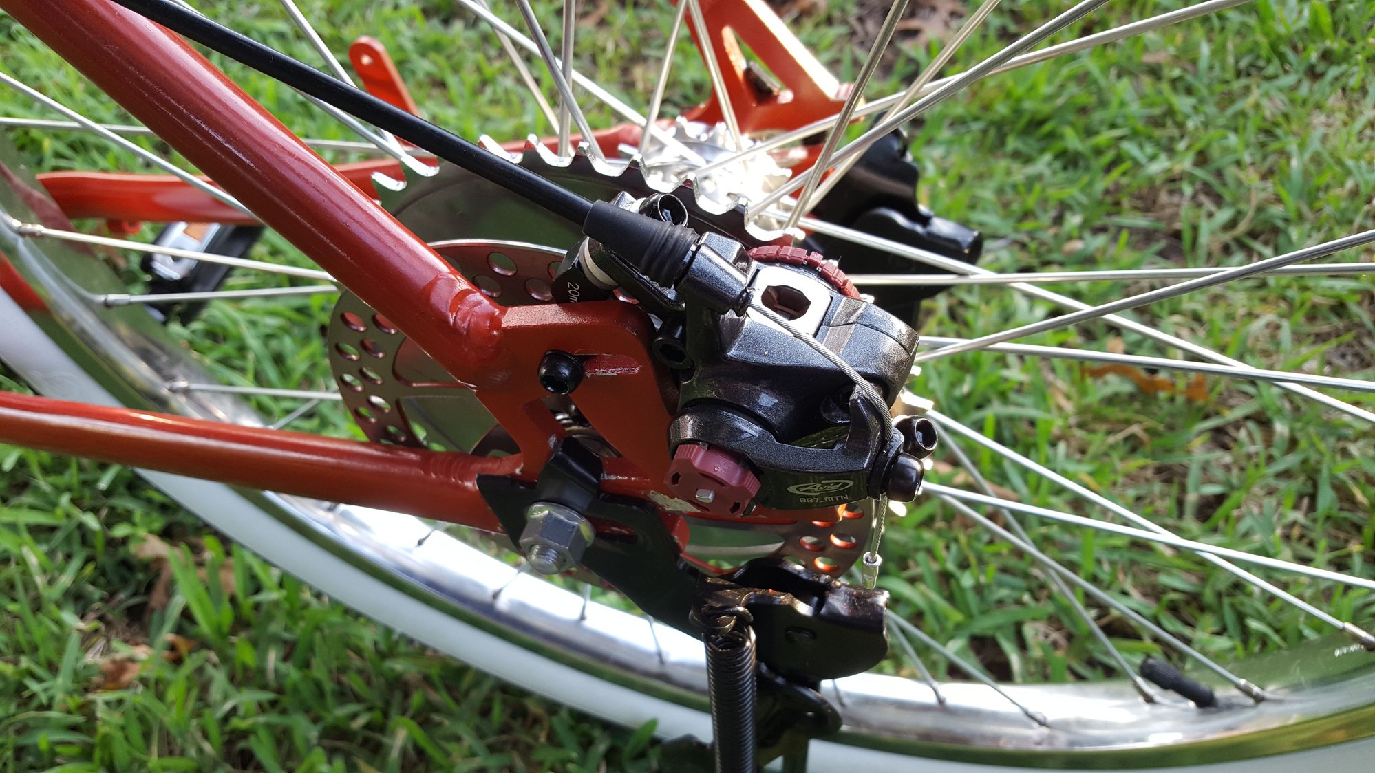

Been a while and Ive made some progress. How ever progress is on hold as work is just starting to pick up and I really need to hold off on spending money and build my bank account back up.
Anyways as of today I took some updated photos to show the Avid BB7 MTN brake calipers mounted front and rear, still need to figure out how to rotate the rear caliper clock wise as the pads are at roughly a 45* angle to the rotor and is half on the rotor and half off. I can slide the wheel back some and it will slide back some to tension the chain. I also have some pictures below showing the 7/8 motorcycle style twist throttle I bought as I wanted something vintage and metal not plastic. This also has a sleek vintage look to it vs the bulky blocky look of the CNC made ones. I just don't know if I should keep the black jack hammer style grip which came pre installed.

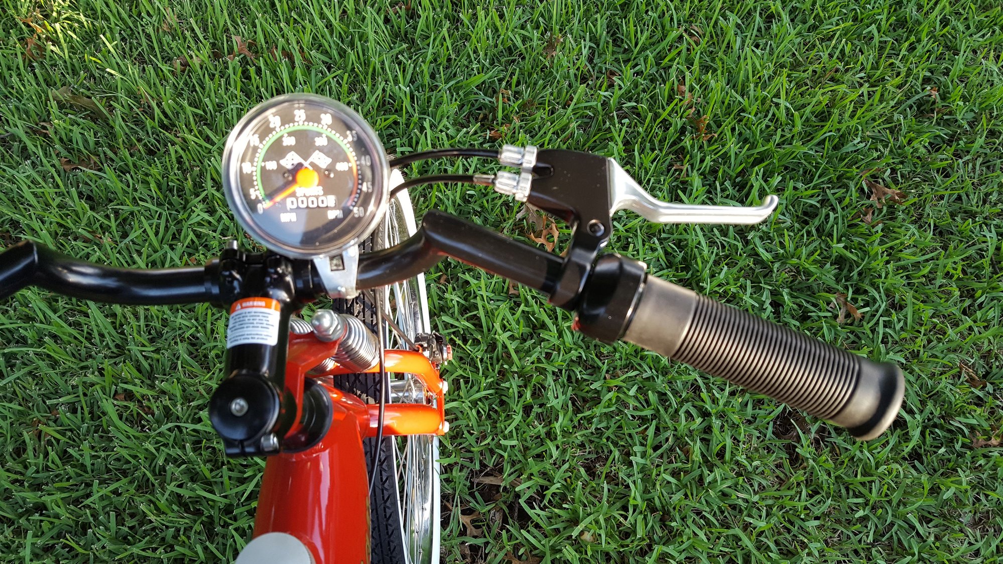

I bought some synthetic leather grips from Velo in brown probably wont fit this as the twist throttle is 1". I am thinking of getting the brown/tan Coke bottle grips in rubber at least the brown I think would blend in with the brown Velo seat I am wanting to get.

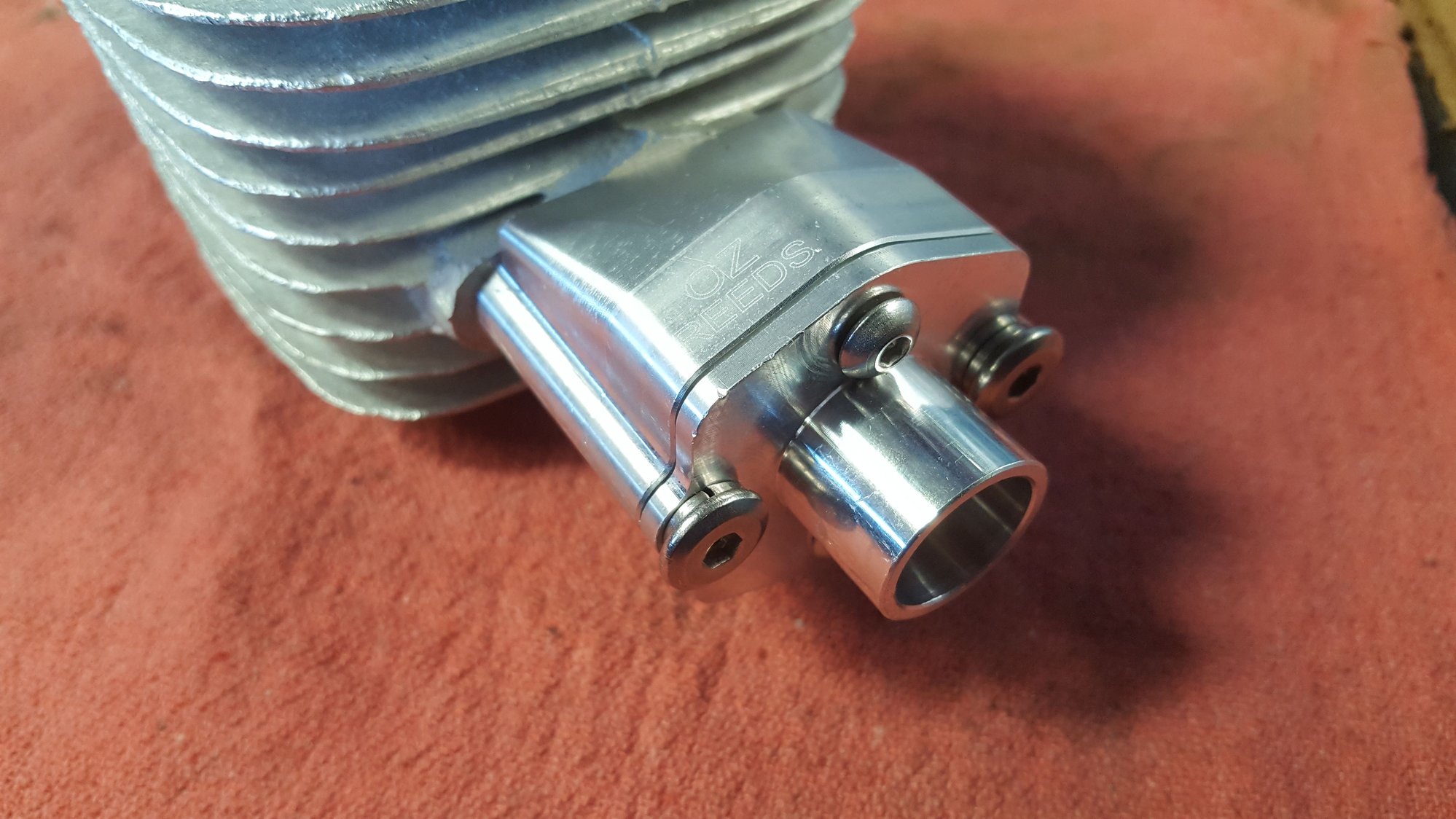

Heres some eye candy for those that are interested.
First pic is of the Oz Reed valve that I installed after port matching the Reed Valve to the Cylinder jug.
Second pic is of the Oz Reed Valve and the port matching that was done on the cylinder jug.
Third is two pics of the Fred Head I got from Fred who owns his own machine shop that machined this 7.0cc Stage 2 head out of a solid chunk of billet aluminum.

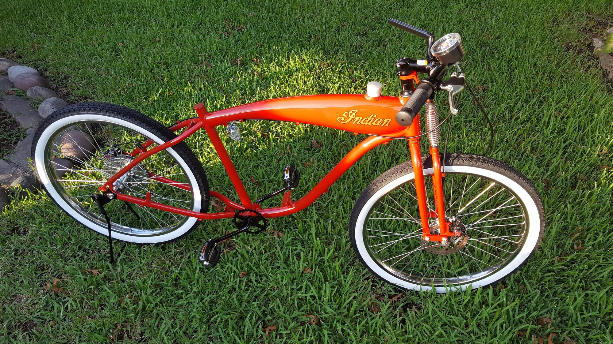

Well here are photos I took today. Ran the bike its loud as hell so will have to find a baffle or a muffler or something to tone it back some. But here are some pics from today after I polished the finish and polished the chrome out.
And a small 20 second video clip

Looks really good just the saddle to complete it now..?

The seat post, I have the saddle but keep getting sent the wrong size seat post from what I order. I also have some minor issues to resolve. Like the splines are damaged on my clutch cam so my clutch cam arm twisted on me. So I got a new cam and cam arm coming in to replace it.
Another problem I have I thought I fixed it but I just checked about 5 hours later and the brass fitting threaded into my fuel tank is leaking fuel again. I don't know if I should drain the fuel out tomorrow apply more than 3 wraps of the Teflon tape or if I should find like a brass washer and try to use a crush washer technique with Teflon tape. I just don't get it because I tapped the fuel tank aluminum bung since the threads were messed up to be 1/4" pipe so 1/4" pipe threads with 1/4" pipe fitting it should seal without Teflon tape. But it looks like the fuel is eating up the 3 wraps of the blue Teflon tape I used which is supposed to be fuel oil safe. Wonder if I should try 6 wraps. The tape itself on the roll says to do 3 wraps.
Aside from that the only thing left to do is decide how to modify my front fender to make it fit the bracket riveted on is too long so it will not fit my front forks. I also need to find a headlight and figure out how to power my 12V tail light/brake light. I was going to get a 12V generator but decided against it because I am running out of room to hide systems on this bike so I cant hide a 12V regulator/rectifier. So I am thinking of using a modest sized plastic project box and make my wiring hook ups in the box for my tail light and headlight and then buy one of those eight AA battery boxes to provide 12V for my tail light and headlight. I figure it should give me decent time for light since I am going LED.
