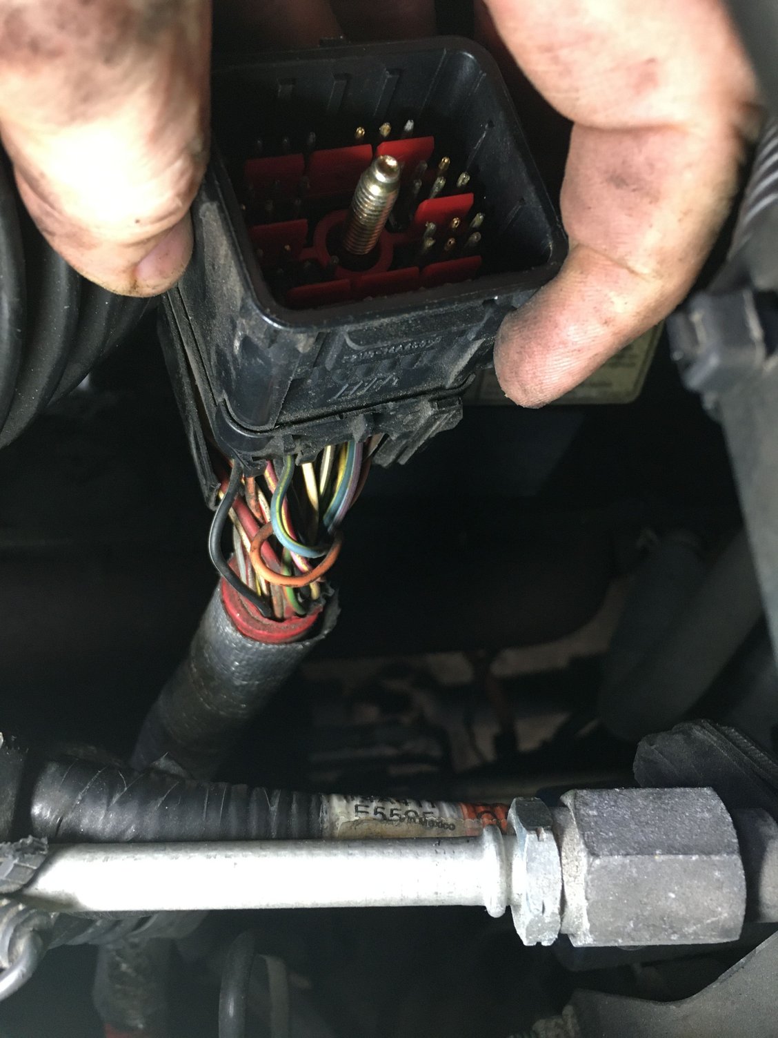

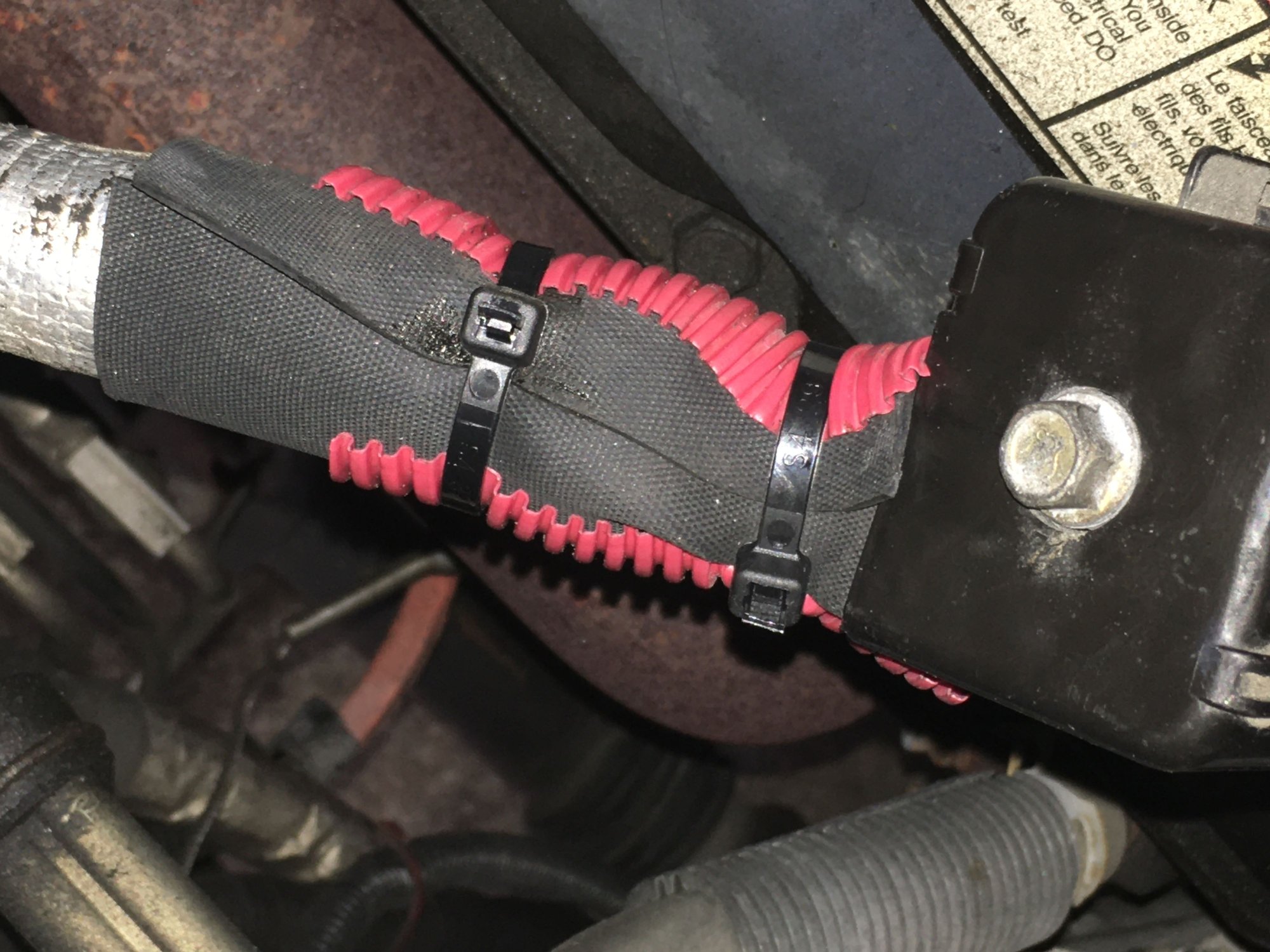

I am trying to track down some idle issues and someone suggested checking the wiring harness at the drivers side valve cover on my 7.3. No sign of wearing through the insulation, but I wrapped it with rubber and some loom anyway.

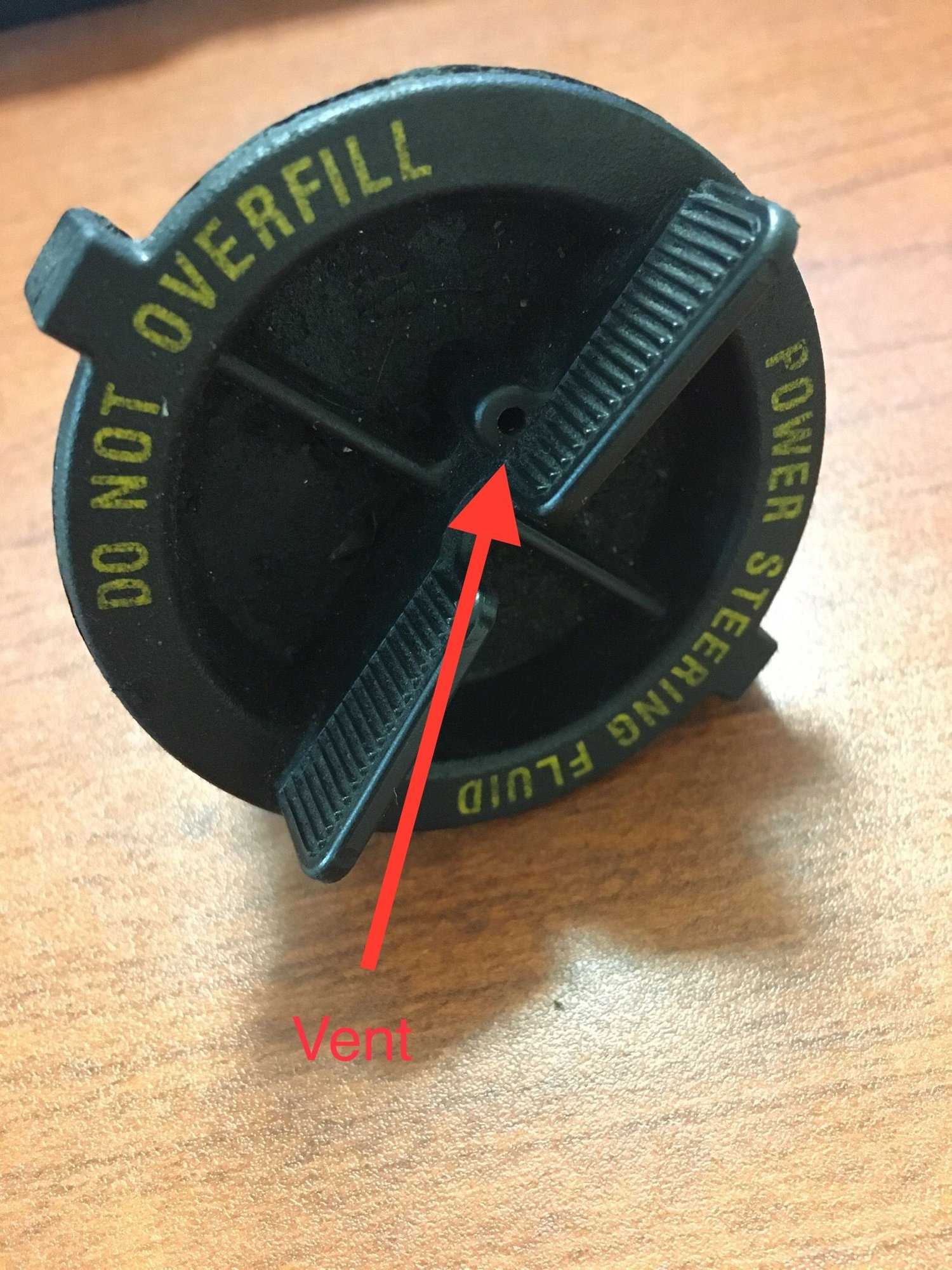

Tired of that old Power Steering Fluid Cap that doesn't seal anything and you are worried it will pop off at any time? Me too... I tried to find a Motorcraft branded one and came up empty. I'm trying a Dorman 82582. So far it fit and clipped closed quite snugly. I don't know about long term, but for $5 I figured I'd give it a try.

Don't lock it down too tight, that's the system vent.
There’s a vent hole in the cap. I took some pictures of the original Motorcraft, but verified the Dorman version also had one.

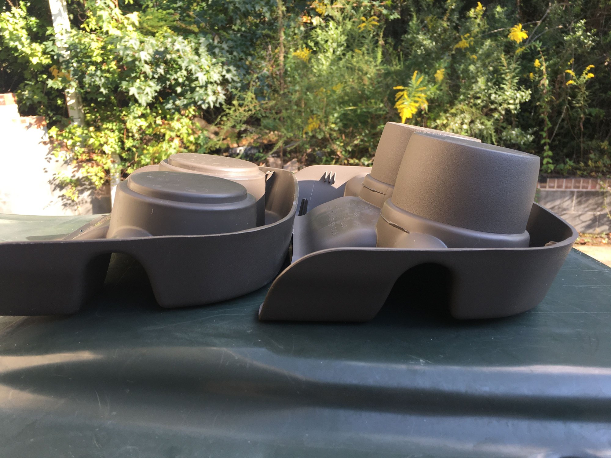

Easiest mod ever: the better console cup holders! As most everyone knows, the standard cup holders on the front of the console are virtually useless. I never used mine for cups or bottles, just coins usually. I had heard of folks upgrading cup holders in their super duties. But, because I’m slow, I thought they were talking about the in-dash cup holders. Mine worked ok so I didn’t put any additional thought into it (slow).
Then I was perusing @MasterX ‘s build thread and the light clicked on for me. Mr. UPS dropped off part number 1C3Z-3613562-AAA for me and I had it installed in seconds. Took longer to take pictures than the swap.
Old. This cup would fall out exiting my carport.
New. Snug as a bug in a rug. I’m not sure if the cup reaches the bottom, but it’s held tightly on the sides. I’d have to do some Dukes of Hazard stuff to get it to fall over now.
Tale of the tape!

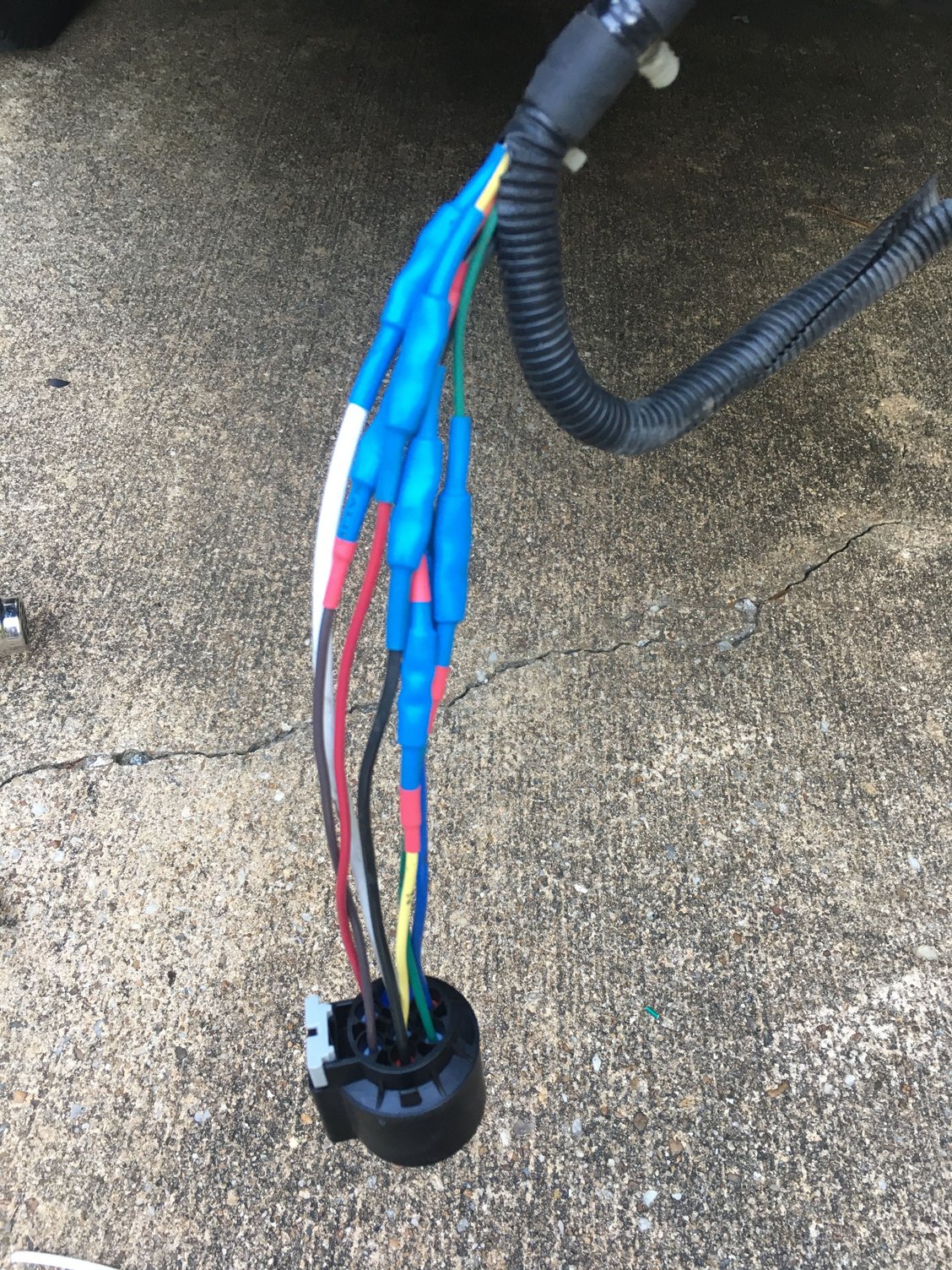

Here's the new plug spliced into the old wiring. The wire colors mostly didn't match so I just had to carefully work my way around the plug and match up wiring by position. I staggered the butt splices so they wouldn't be such a big bundle all in the same spot. I should probably have staggered them a bit more.

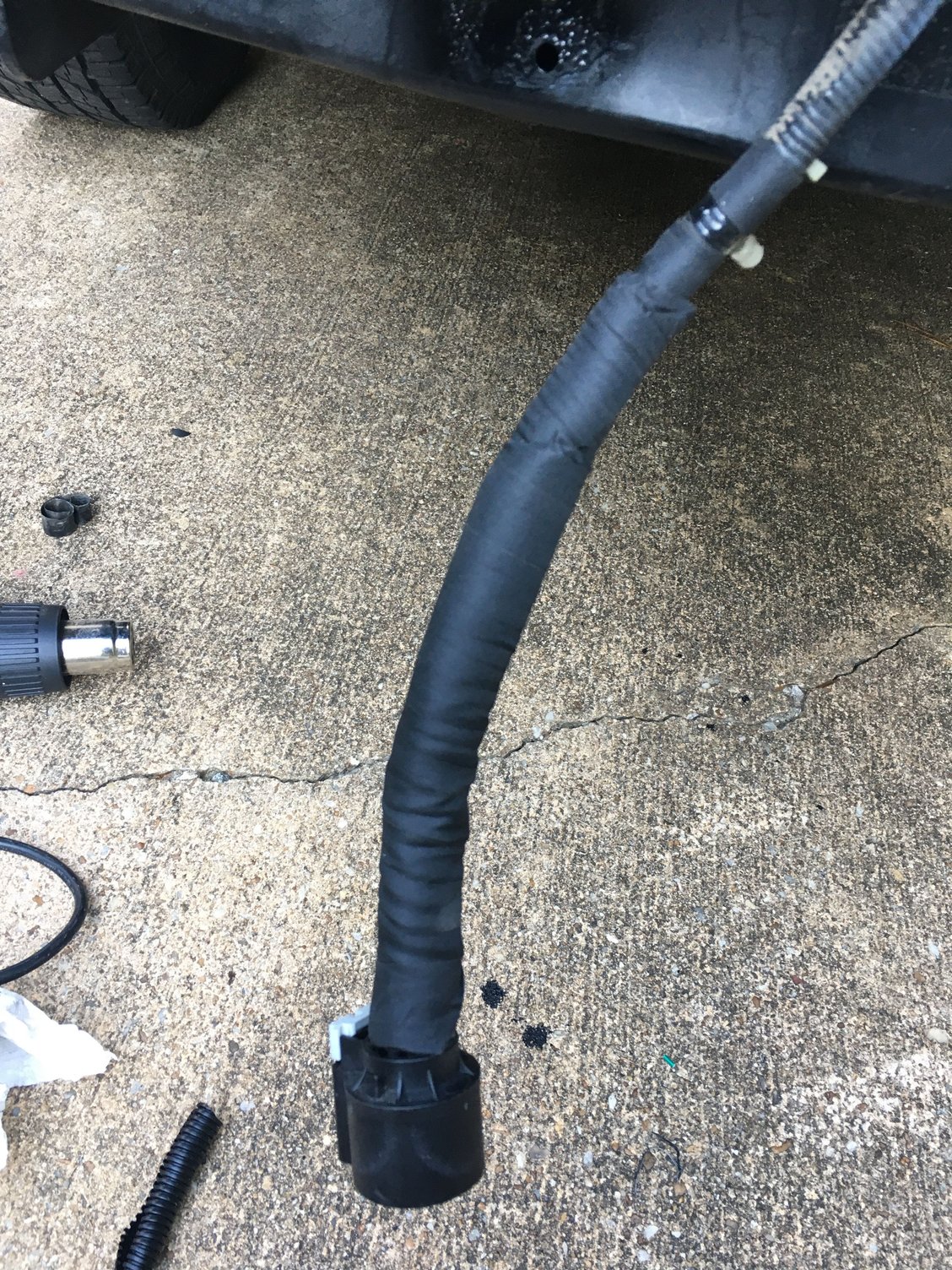

Wrapped up with wire loom, then whatever heavy-duty chunk of cloth the original loom was wrapped in, and then the cloth loom tape.

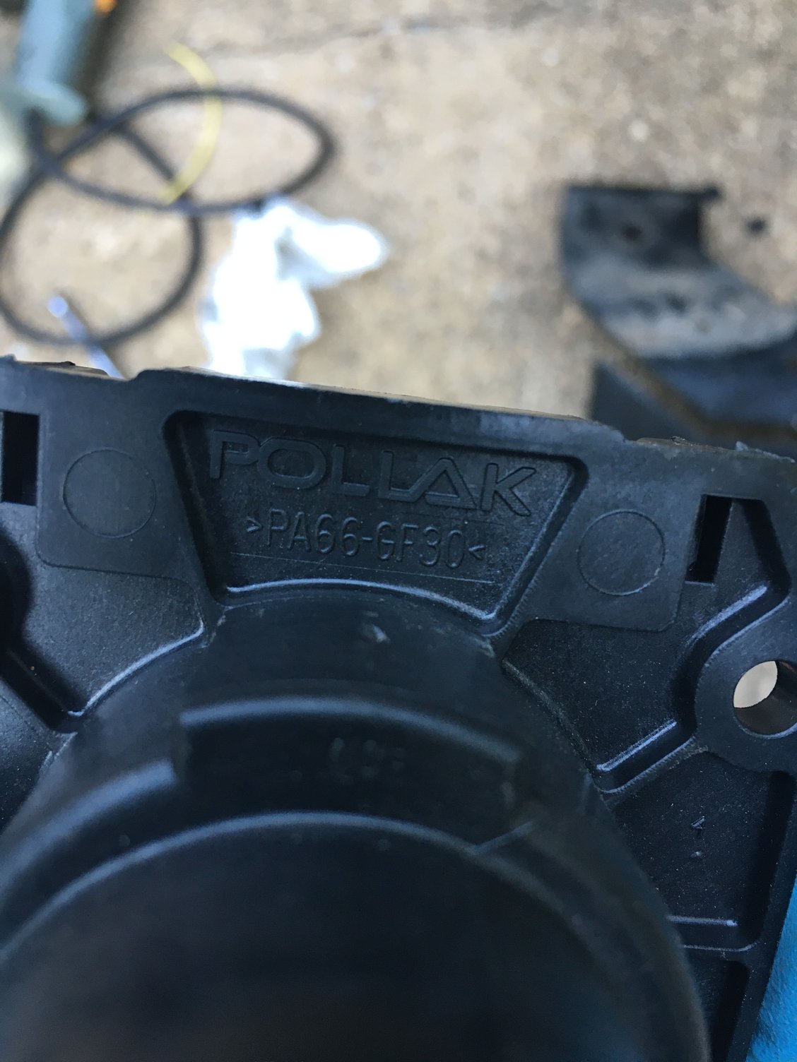

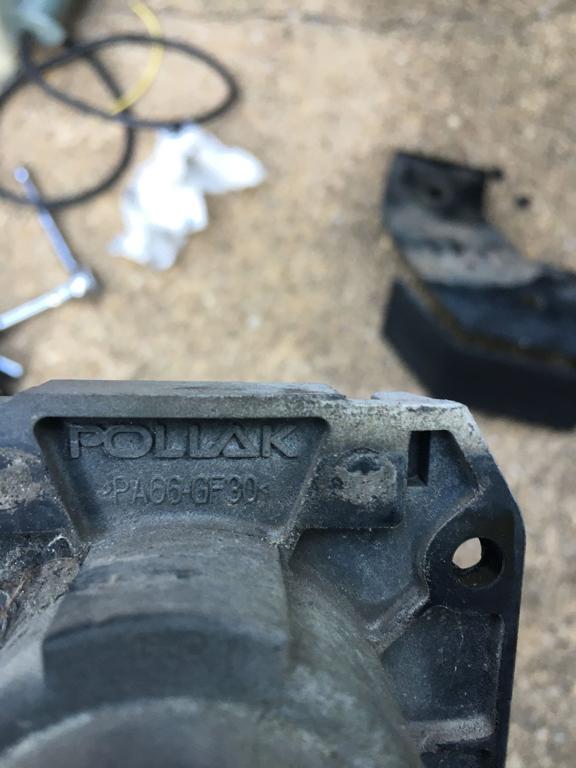

Original Ford socket part XL3T-14A624-BA.
The Ford part is made by Pollak though, part PA66-GF30.
New socket.
Same part number!

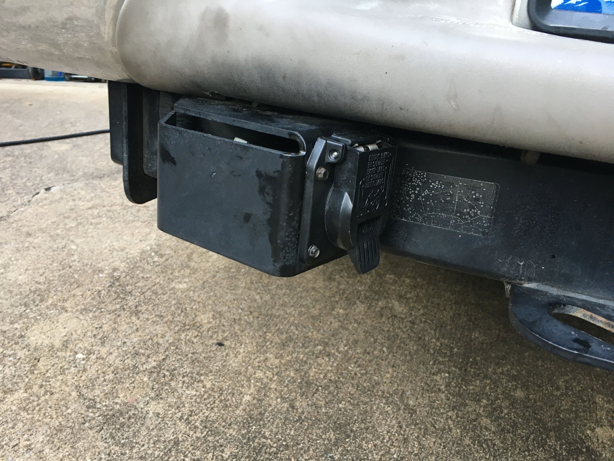

Complete. I probably should have painted the bracket but its ok for now. I backed it up to the trailer and plugged it in. Everything seems to be working! Success! That's two electrical projects in a row that seem to be working...first try. That's a record for me. Luckily the socket bracket mostly covers up the cutout in the bumper cover.
Just FYI, that bracket that the socket screws into is a bear to take out. I used a ratcheting 1/2" closed end wrench to get it off the top of the receiver bracket (and back on). It is about a click or two at a time because access above the hitch is tight. Lesson learned.
