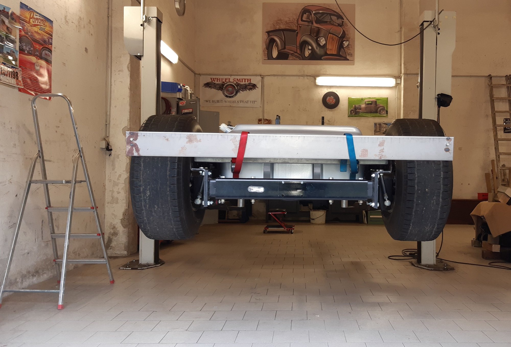

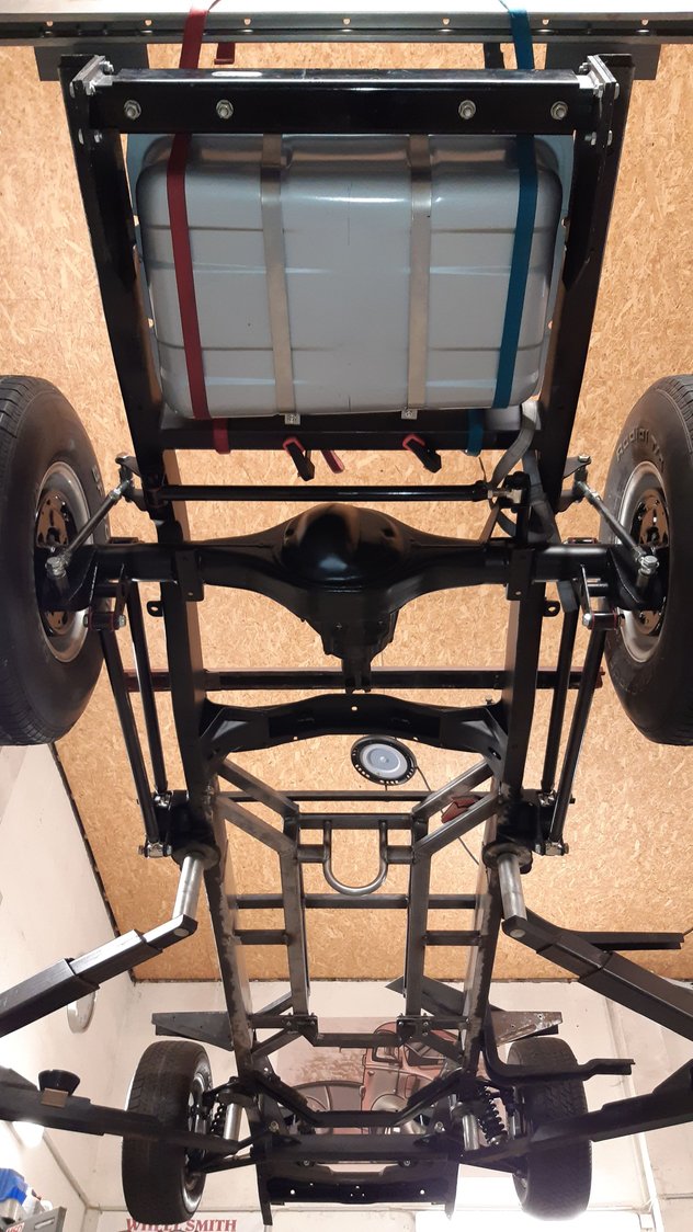

so i welded that selfmade X-Member to the Framerails in the meantime, its almost done now.

stiffening that weak Frame.

of course i will box it additionally ...read the thread a couple posts above

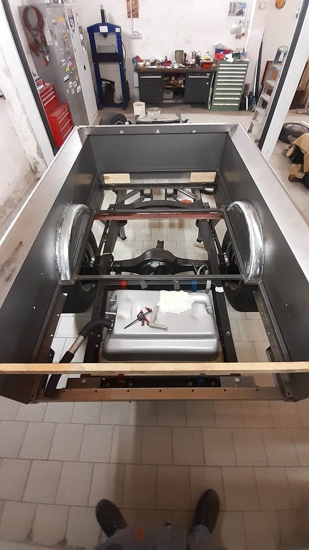

it´s a "Build Thread" now :-)
Frame reinforcement with K-Member and boxing is almost done now.

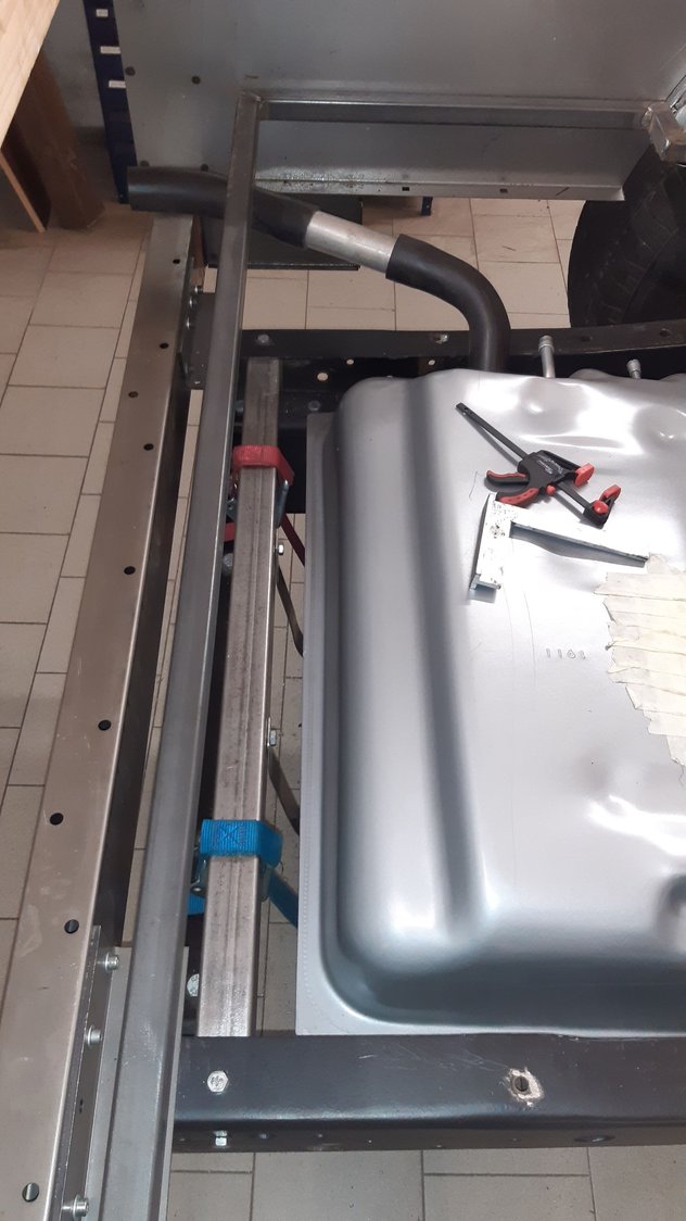

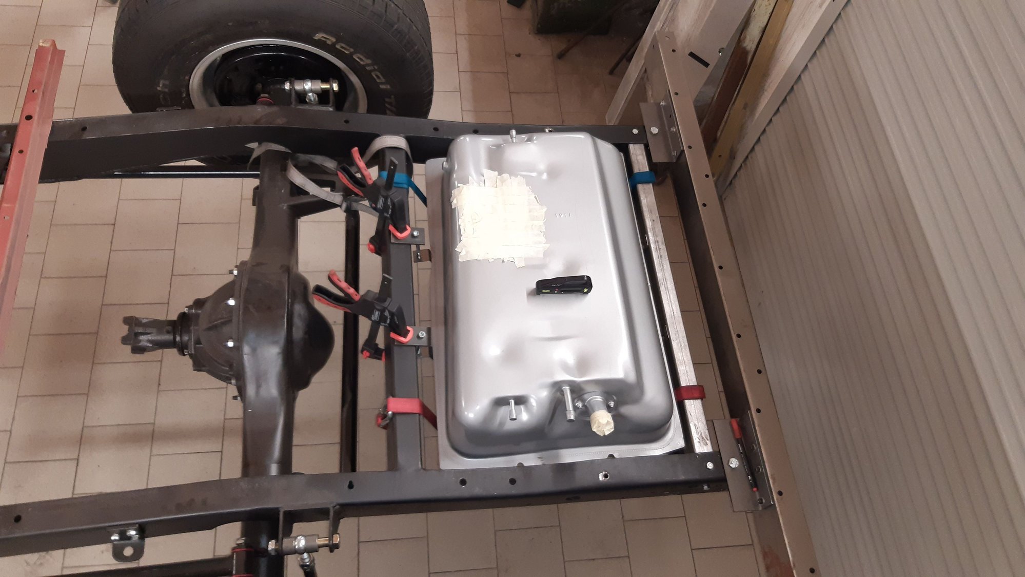

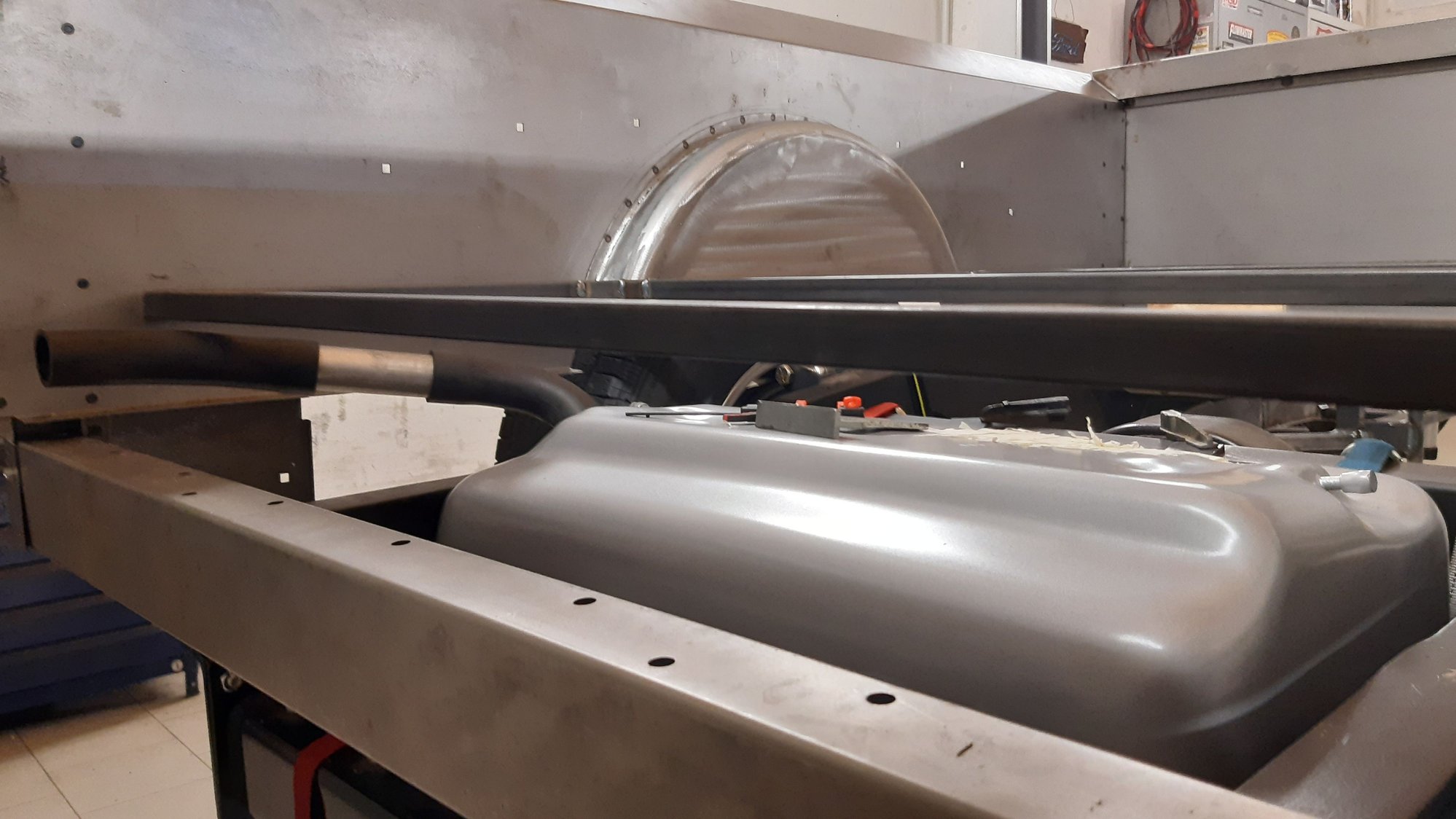

so i started locating the LMC Truck Gastank
i didn´t want to fill the Gastank at the Bedfloor and i did not want to cut holes in Fenders and Bed sides.
I will raise the bed floor and put the Fillerneck behind the befloor, underneath, hidden from the Tailgate.

Yes i hope it will be strong enough, it has to handle Big Block Torque, so i wanted to build it strong, espacially since i found that crack in the Frame.
Have yoo checked your Chassis? I noticed that Frame cracks not so seldom.

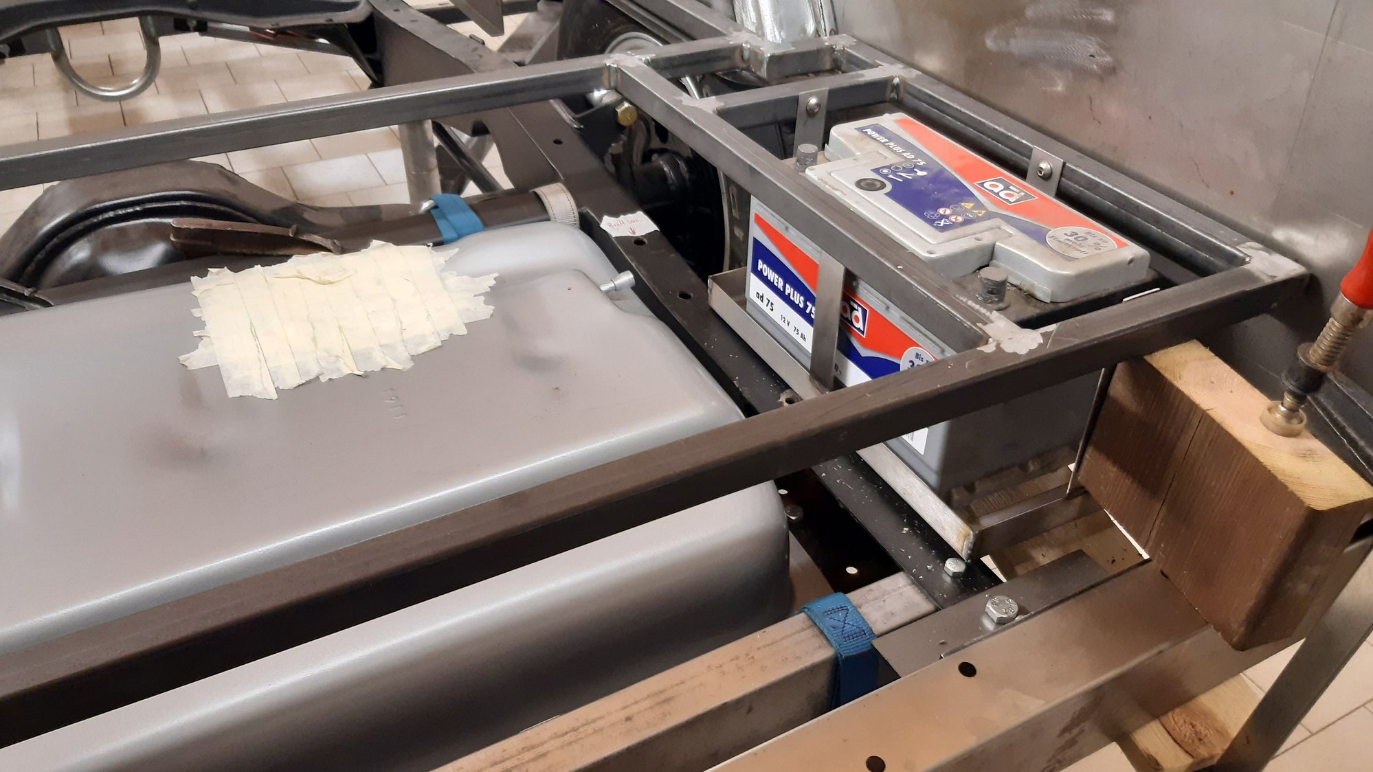

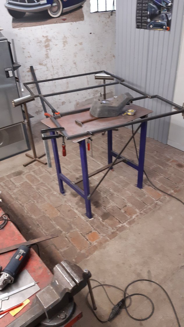

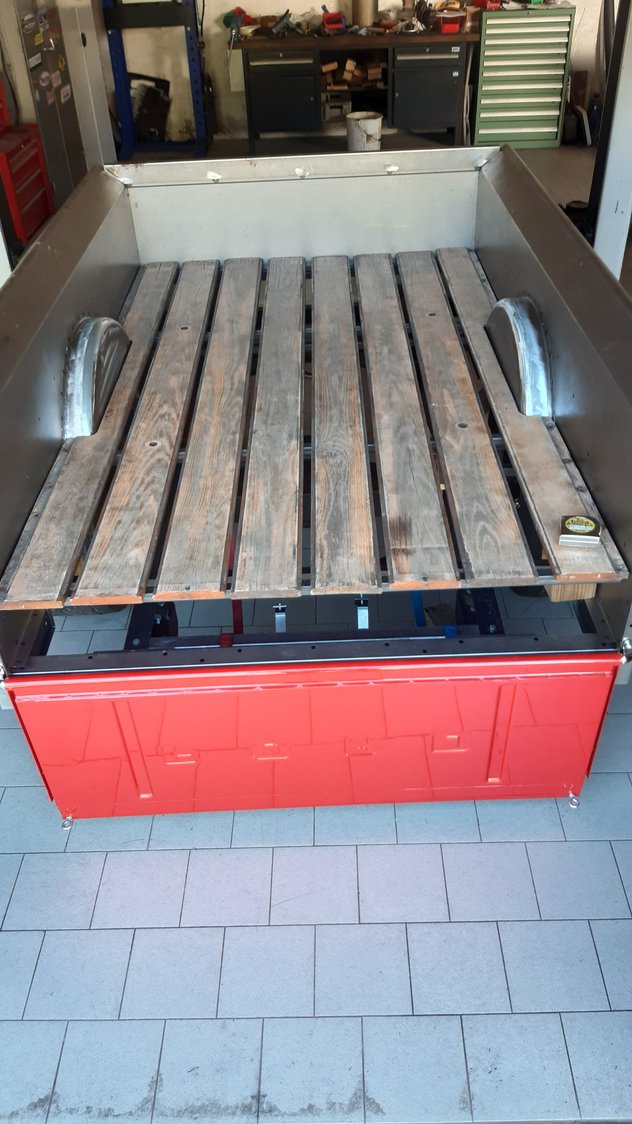

started working on the new Perimeter Bed i got form Midwest Early Ford.
Put tubs in for wider wheels.
raised the bedfloor with 1" X 1" tubing.
I built two frames, one i welded to the bed and the second one is for the tilt bedfloor for getting access to the gastank and the battery underneath.
just mocked up
