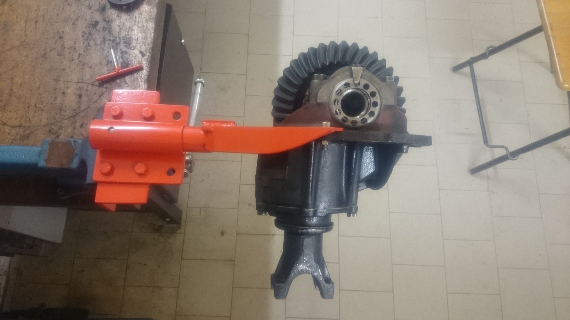

first i build a rotating jig for the Ford 9 inch third Member, than assembled the Diff with Eaton True Trac and a Richmond Ring & Pinion with 3.50 gear ratio.
Adjusting backlash and contact pattern.

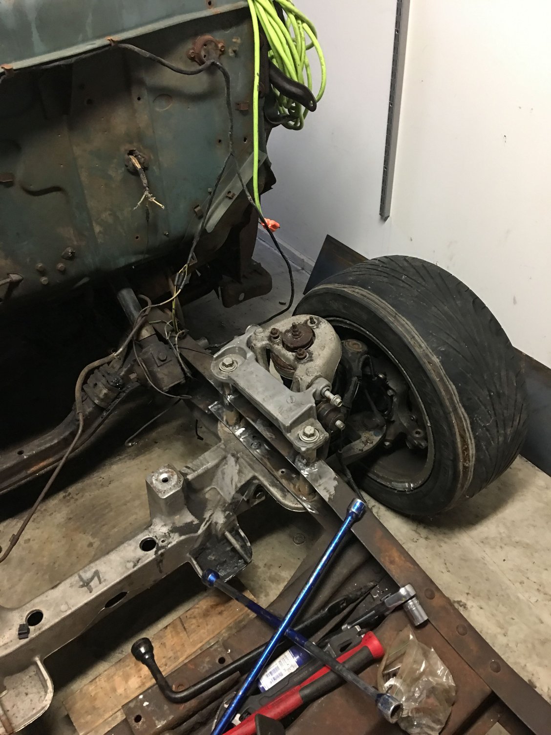

Today i cut the inner Fenders to clear the IFS....
there were some older cuts from a P/O for the Power Steering so te driver side lokks not that nice.
