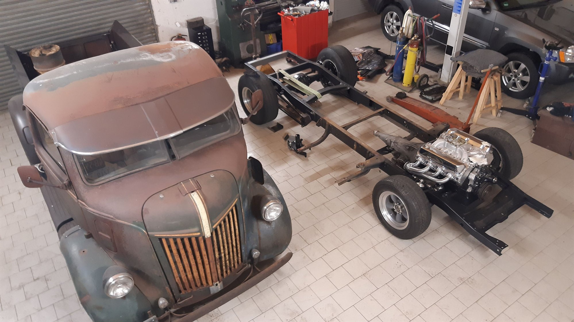

its almost a build thread now
today i moved the "Truck" from my Garage at Parents House to my Barn which is closer to my House...
new home...

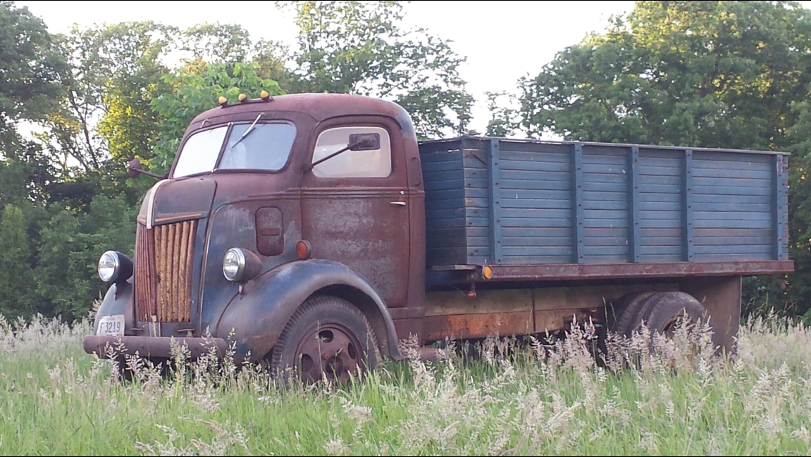

Originally Posted by EBEAR
Very cool COE . Tell us more .
It´s a´47, i bought in in 2016 in Cincinnati Ohio. That was how i got it :
It spend many years in a Barn and was in good condition. I considered to build a Hot Rod Hauler, but finally i did not want such a big Truck, i rather wanted a Pick Up for daily driving.
It has a M II IFS, a Ford 9 inch and a Che*vy 454 with Th400 now. In summer i drive it nearly every day (at least until my effy is ready,than i will sell the COE) drove it more than 6000 miles in the last 3 years.

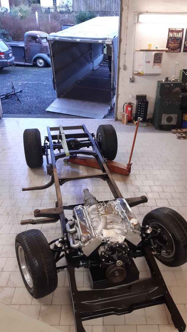

Originally Posted by ingo
This is how tight it is around headers, steeringshaft, oilpan, steeringrack, crossmember ...
Nice work there. Very tight clearances. Given how close they are if your engine mounts compress you could have a problem. I would recomend putting something solid between the engine and frame brackets that lets the mounts compress a bit but prevents them from compressing to the point of components hitting each other.

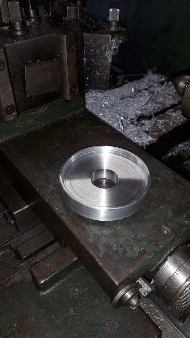

B
yes, thats why i made some thicker 'cups' for the Motormount cushions, to raise the Engine a 1/4" ... :
