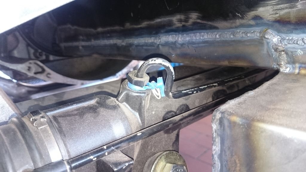

This is how tight it is around headers, steeringshaft, oilpan, steeringrack, crossmember ...

Looking good Ingo!
definitely a different take on that oil pan.
great job!

Hello Wayne,
good to hear from you.
What do you think about my "different take" on the oilpan ?
it´s moving along.

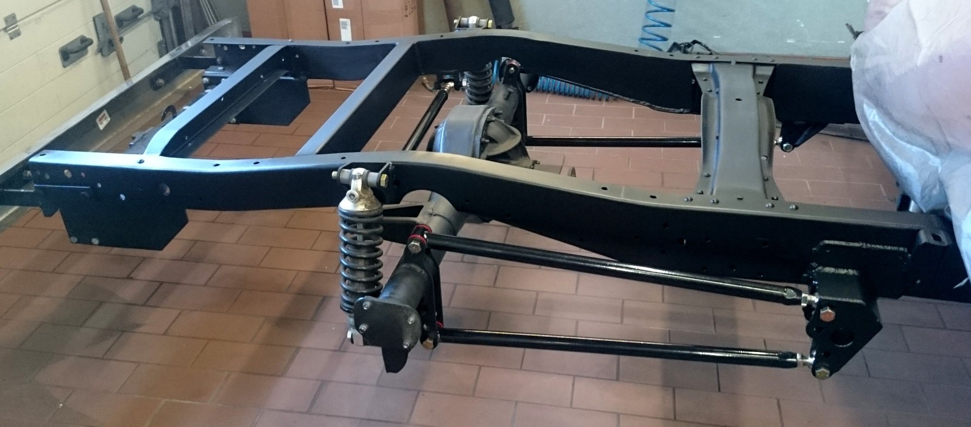

...painted the chassis, looks way more done now.

that looks soo good.

Originally Posted by ingo
Hello Wayne,
it´s moving along.
I have never seen it done before.
You have done an amazing job of fitting it all in there.
The others that I have seen, used an extension shaft for the oil pump, and a rear (mid) sump pan.
I think yours is very cool!
