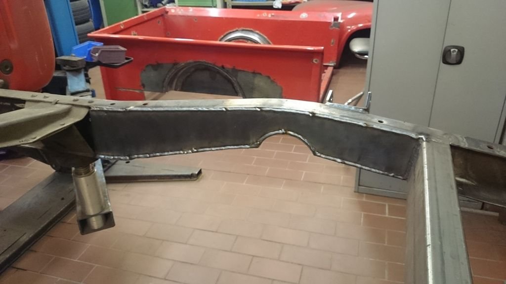

c-notched the frame. So i can go as low as i want and still have enough suspension travel.
Then i cut boxingplates...

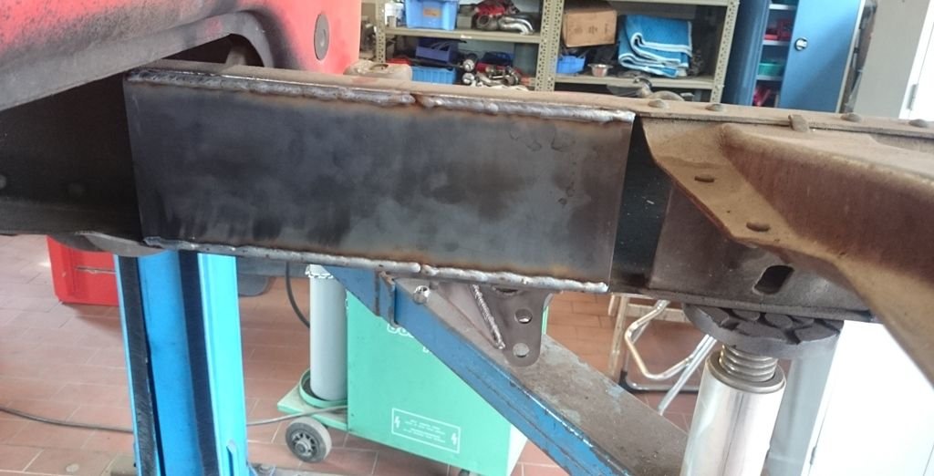

...first tacked, thaén welded them in
