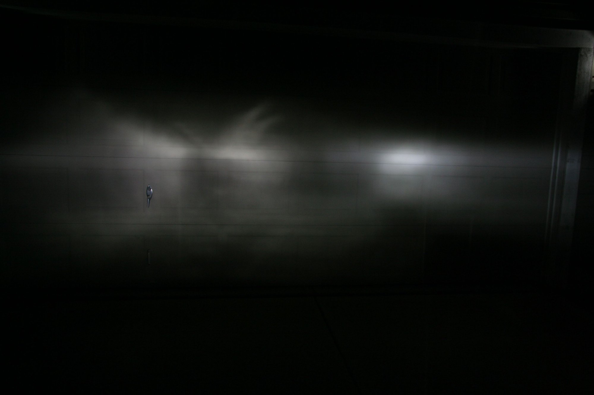

Alright, I just got back from taking a test drive and am satisfied with these new Amazon lights. The low beams on these compared to the Xenon Depot ones are pretty similar, but the high beams are much better on the amazon ones. Also, you can tell that the amazon bulbs are slightly whiter. The heat sinks do get fairly warm. I can hold them for about 5 seconds before I have to let go. As long as they aren't resting on anything, I don't think they will cause any issues. Time will tell if they hold out. Amazon has a good return policy if they don't. The build quality on the Xenon Depot bulbs does seem a little better, but the high beam quality just isn't there. I don't know why they design them to copy the filament positions of a H4 bulb and not a H13. I got the good camera out to take a few pics. In these the Xenon Depot bulb is in the drivers side and amazon bulb on the passenger. In the first pic, I adjusted the camera so you could get a better idea of the high beam pattern comparison.
High beam comparison w/ f stop camera adjustment:
High beams without camera adjustment:
Low beam comparison:

Those were the AutoFeel LEDs. They almost look identical to the Vplus ones but the AutoFeel use Cree LEDs while the Vplus use Seoul. Now I see they are $15 cheaper than when I purchased them. If they hold up, they will be hard to beat for $45.
Also, just like with the Xenon Depot lights, an extra hole needs to be drilled into the collar of these, so the drivers side light can sit perfectly in the 3-9 o'clock orientation. Passenger side doesn't need this modification.

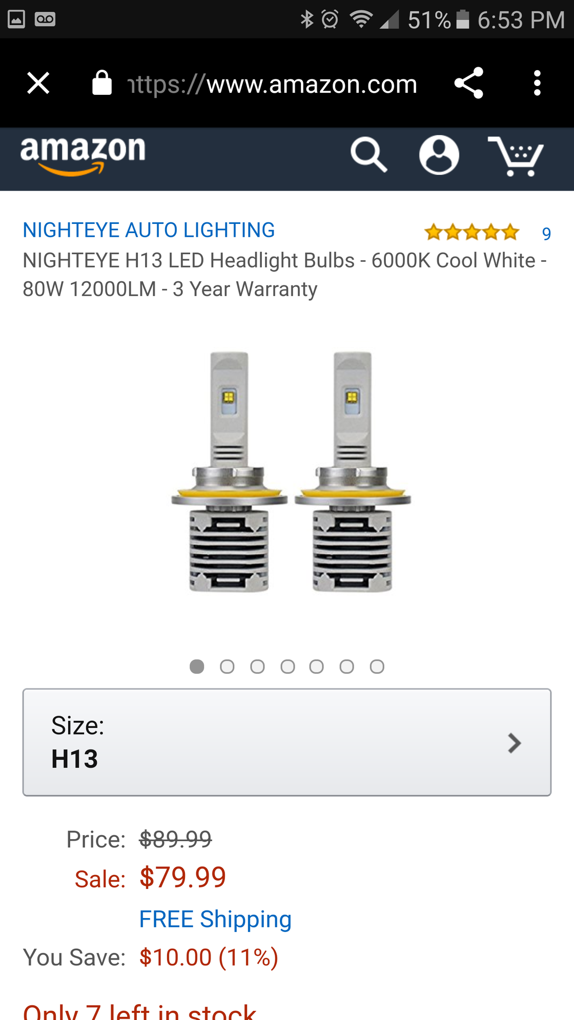

I just ordered these from ebay for $59.99 . My buddy got these and they're much better I'll send photos when I have mine installed
I don't see how much better they can be. Again, here is a light that doesn't match the filament location of an actual H13 bulb. Those ones don't even appear to have an adjustable base, which is really a must have. I'm sure they are bright. They all are bright. I had an early set of LED bulbs for my F-250 and they scattered light everywhere and didn't throw a beam worth a damn. I would compare them to turning on a LED flashlight without a reflector on it.
They need to have a good pattern coming out of the reflector housing, and the only way to do that is to replicate the actual filament location of a halogen H13 bulb, as that is what the housings were designed around. I'm just trying to save others some time and money from making the same mistakes I made.
If I were to buy a bulb from Nighteye from amazon, these would be the ones:
https://www.amazon.com/NIGHTEYE-Headlight-Conversion-Driving-8000LM/dp/B01H02L3VK/ref=sr_1_1?ie=UTF8&qid=1487457935&sr=8-1&keywords=nighteye%2Bled%2Bheadlight%2Bh13&tag=viglink20368-20&th=1 https://www.amazon.com/NIGHTEYE-Headlight-Conversion-Driving-8000LM/dp/B01H02L3VK/ref=sr_1_1?ie=UTF8&qid=1487457935&sr=8-1&keywords=nighteye%2Bled%2Bheadlight%2Bh13&tag=viglink20368-20&th=1

I'll keep you posted on how it turns out if they turn out really bad I have no issues with getting rid of them
