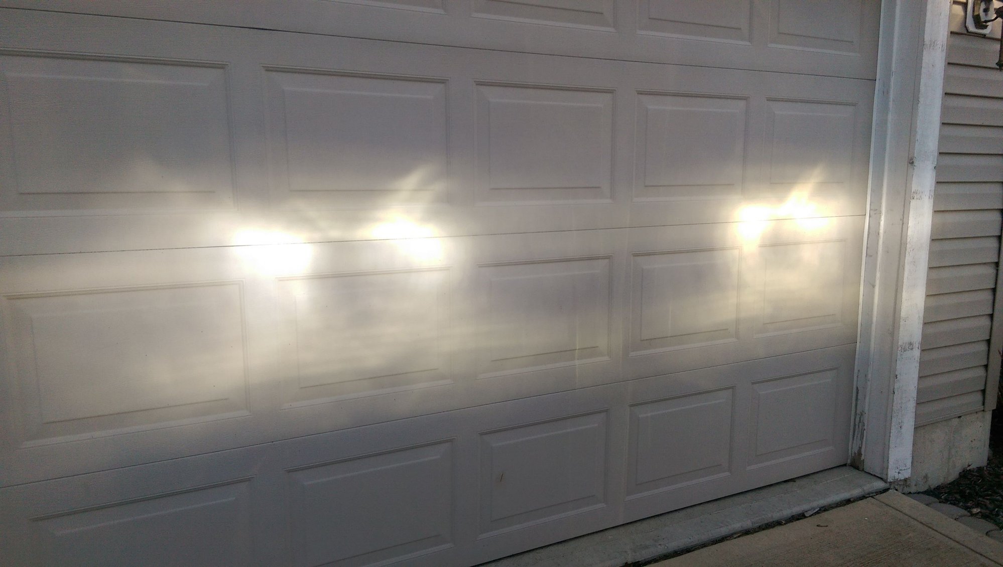

Here is what I am talking about
Dims:
High beams:
I also thought about heat being an issue with running highs/lows at the same time. Didn't know for sure how hot these things get and what they can tolerate.

Bleppek, I only took pics of high beams before I got the clocking right, and back then they were definitely a more diffused light on the garage door. I think I'm parked farther from the door than you, but I'll take a picture of high beams. Snow/rain mix right now. With that said, I feel the high beams do a good job of lighting up the road, and I carried a screwdriver handy to tweak the aiming until I was satisfied the low beams were just high enough without blinding people I was following and people coming at me in the other lane.

It was dark when I drove into work today and I got a chance to try the brights out. They don't seem terrible. I need to get my buddy who has a 6.7 with halogens side-by-side and do a comparison. I still have to believe the not great performance of the high beams is due to the LED configuration on the bulb itself. These bulbs seem to mimic the filament positions of an H4 bulb and not a H13 (even down to using the reflector for the low beams). I'm not sure why they did this. These ones seem to be "more correct" in terms of where the LEDs are located on the bulb itself compared to the filament of an actual H13 bulb:

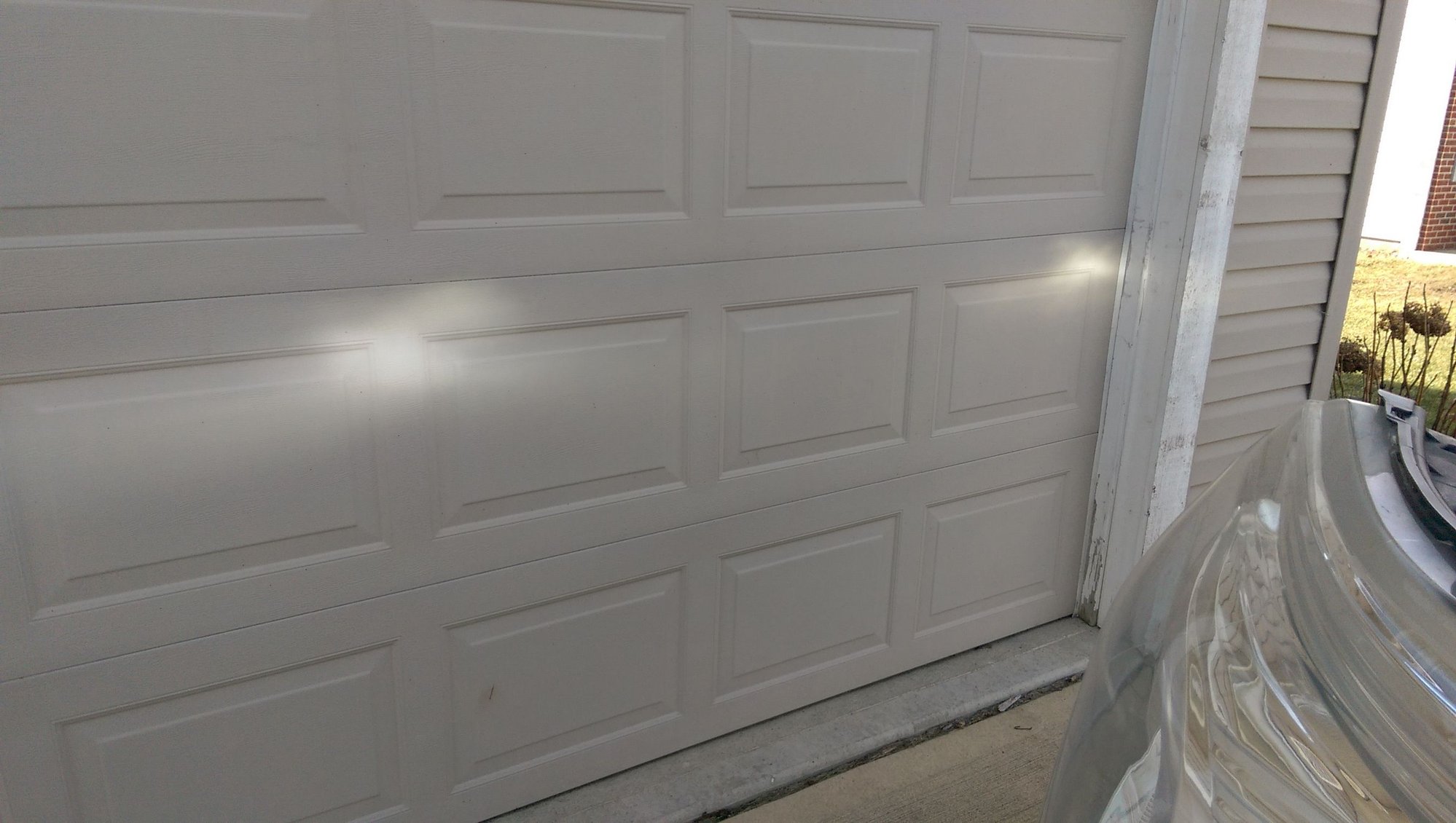

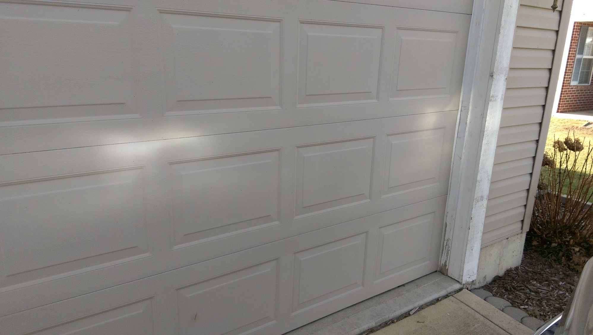

Got the bulbs today and have them installed now. I can see that they are a little more white than the xenon depot ones. The low beam may not have as sharp a cutoff at the top, but I think that was expected since they light up the entire housing with low beams on. It also looks like the high beams are a little more concentrated in the middle. All these are observations when it is very bright outside. Won't know how well the beam will work once it gets dark out, but I will post some more pictures then. Here are a couple of daytime pics with the new bulbs on the drivers side and the xenon depots on the passenger. They don't really show much, but thought I would post anyways.
Low beams:
High beams
