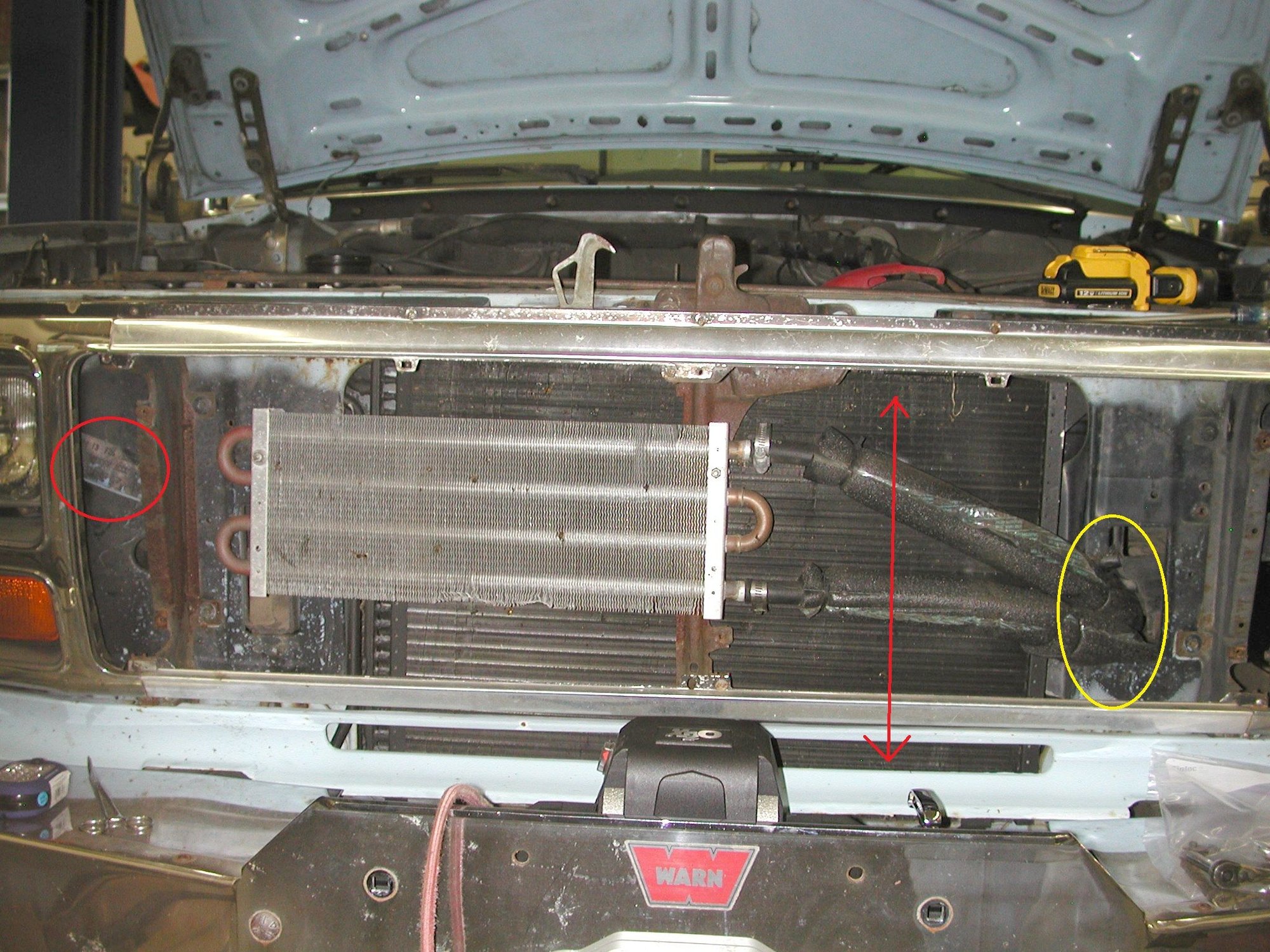

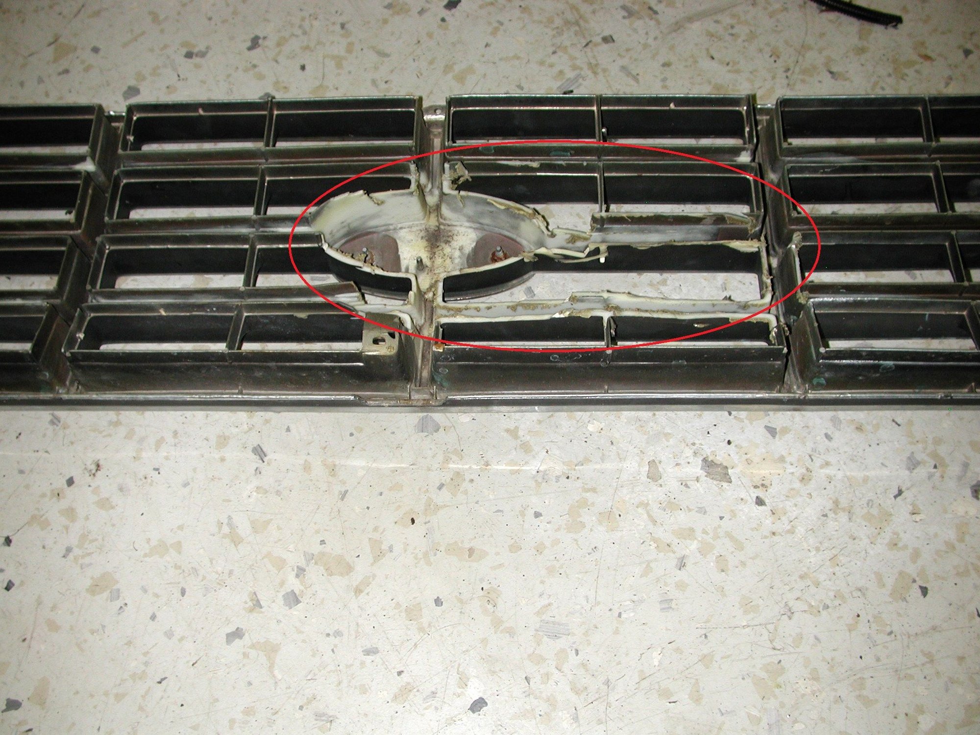

Then I decided I would check into the radiator support to see what differences there are to the earlier ones and what it will take to change it out. Since you can't see much from the back I pulled the grille to look at the front. Here's a shot of the back of the grille, and the red oval shows the hack job done on it to get the oil cooler to fit.
As shown here, the cooler is running horizontally across the brace, which is why it interfered with the grille. And, they hacked the radiator support to get the hoses through. Instead, I'll run the cooler vertically, like the red line shows, and that means it'll clear the back of the grille. Plus, the hoses will go under the radiator support, not through it, and that's the way the factory did it.

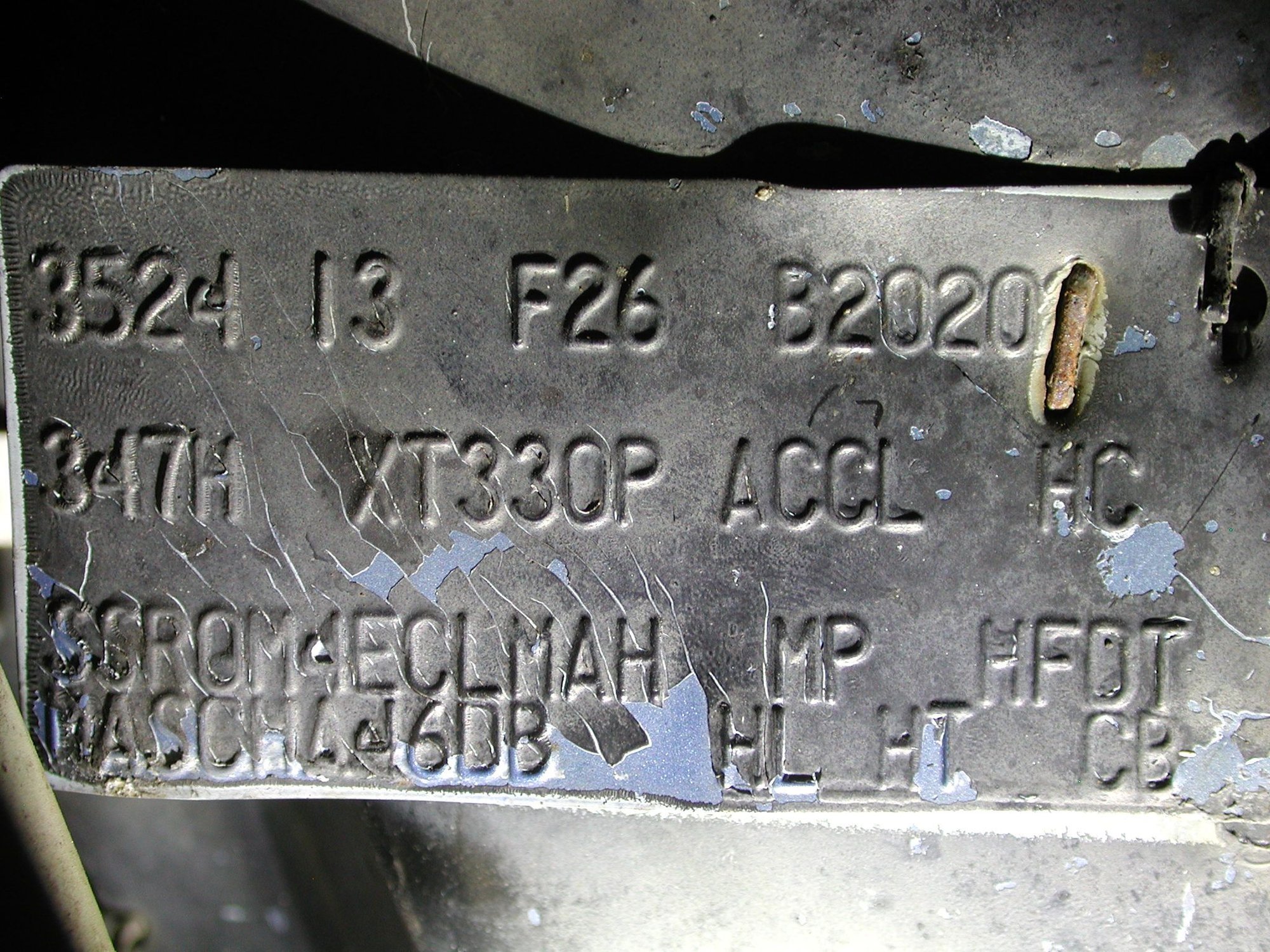

Also, note the red oval on the left of the picture. That's a tag/buck - see the next pic.
And, here's a closeup of the tag:

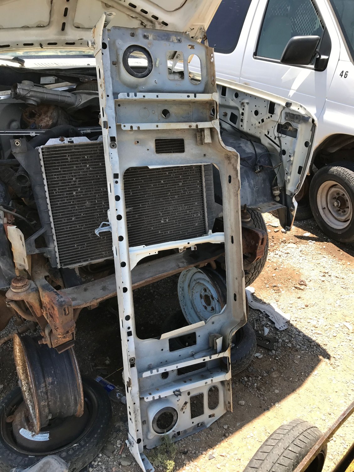

Thanks Gary, it's pretty much all in a day's work in July here. For the rest of you readers, I messaged Gary because I was at the junkyard and I pulled a 85/86 core support that I wanted to bring as a "garage warming gift" in September. I got it out and discovered a couple of small cracks near the passenger side frame mount. Gary says he does not mind welding these up, and the unit should then be serviceable. There are a few spots of surface rust, but overall it's pretty clean.

THANK YOU! I just can't thank you enough! Wow! As you can see in the previous pictures, Big Blue's support is both hacked and rusted, so this one will be such a help.

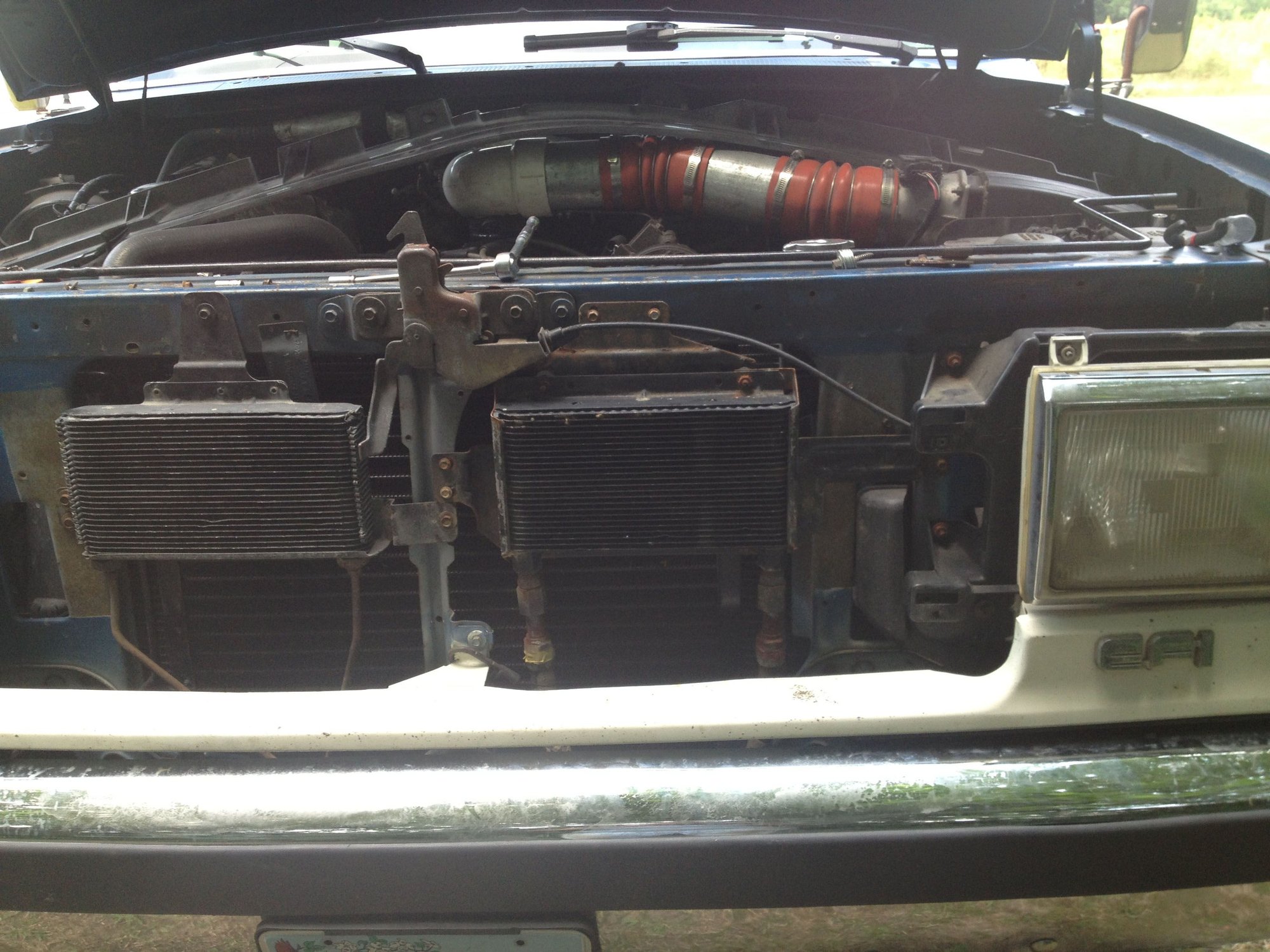

Gary, FWIW, here is what the factory cooler (and aux trans cooler) look like. You will probably want one of those on the truck you put the E4OD in.

I really thought I understood Vernon's frustration. Not with this truck, but with the "help" he was hiring. And I'm sure that it isn't nearly as frustrating for me as it was for him - it was his money, and his dream that was going down the drain. But, today I found yet another example.
I was scoping out the radiator area for the movement of the engine oil cooler, and in doing so I found that the oil cooler is 1 3/4" thick and the space between the A/C evaporator and the valance is 1 3/4". Hmmm, I don't want things rubbing, so maybe the evaporator could be moved back a bit?
Sure enough, there's plenty of room to move it back 1 1/4" at the bottom. But, when looking at it a bit closer I found a couple of problems. The maddening this is that there's room to get the evaporator into the correct spot in the radiator support if they'd just slipped it in. Start here and look at the yellow and red ovals:

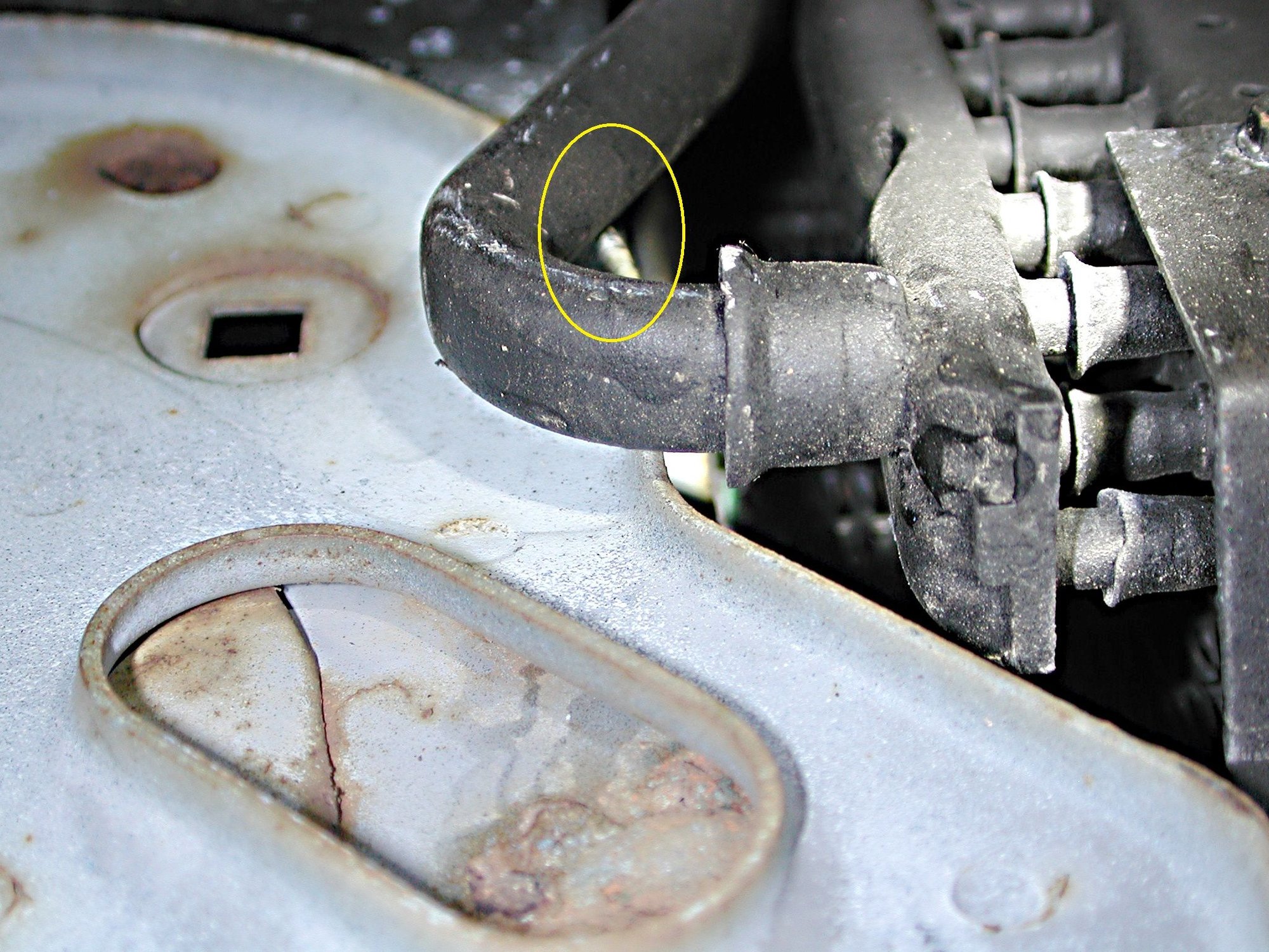

This is a shot from a different angle on the red oval area. Notice the crease in the tube. It not only has been partially flattened by hitting the radiator support, but the crease may well have caused a leak. I wouldn't be surprised if this brand-new-when-installed evaporator is ruined - which may well explain why the pressure in the system is down or nil.
And, on the other side the tube has been rubbing on the radiator support. You can't get a piece of paper between them, so it is likely that a leak is eminent there as well. (No, Jonathan, that isn't a crack. Just the edge of one piece of metal overlapping another.)

Gary, I will give you a suggestion if you have to replace it, get one for a 1994-97 model. That's what's on Darth, it required a little modification to the mounts and may have to get different lines made. It is a multi-pass and works a lot better than the older one for R134. BTW, that is the CONDENSOR you are showing, the EVAPORATOR is in the casing on the firewall. You might also check which orifice tube is in it, Matt can probably still tell you which one is recommended.

I took a shower after writing that and as I stepped out and cool air hit I realized my mistake. Duh!
But, I will consider the later model one if I have to replace it. Thanks for the tip.
