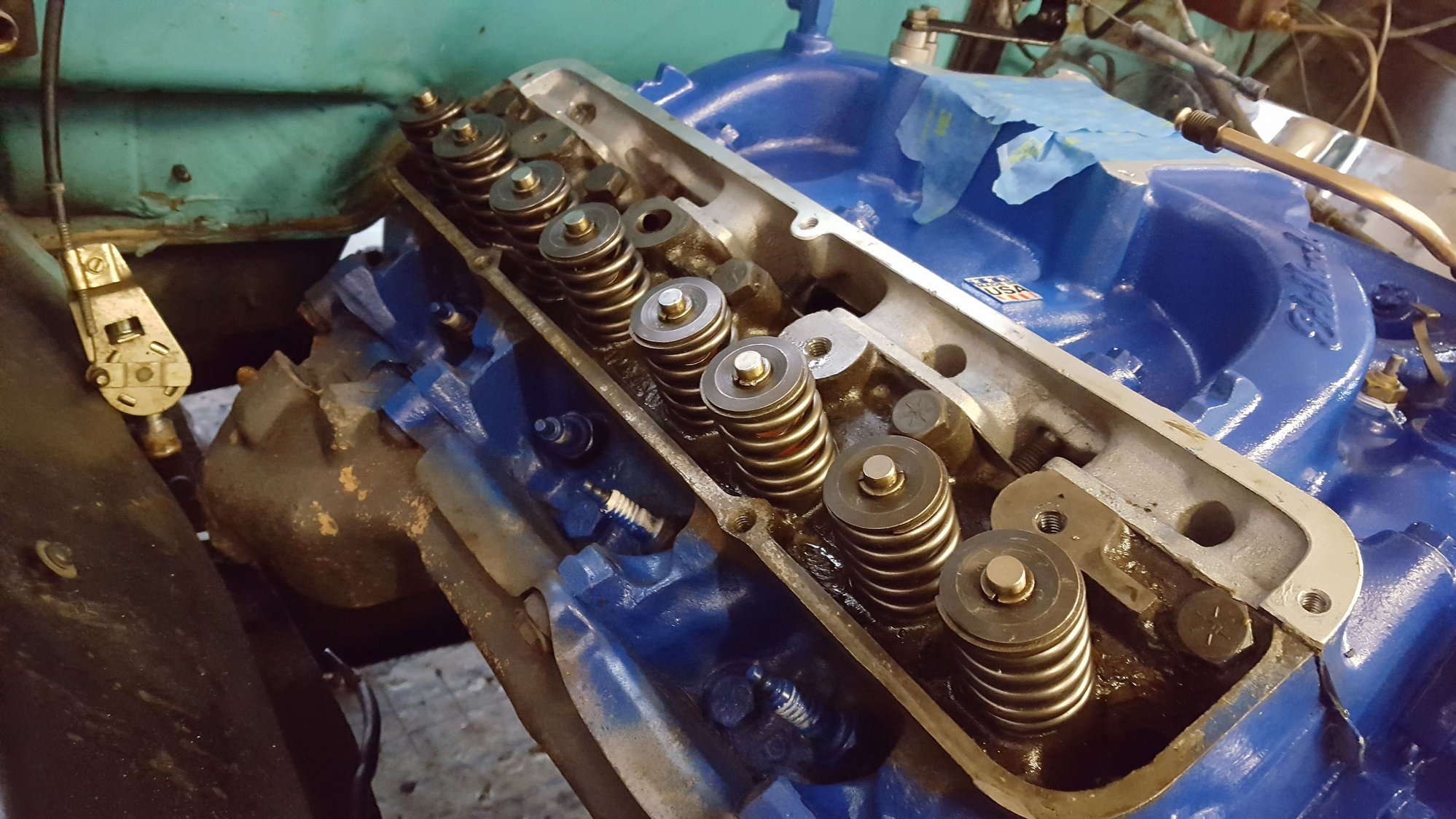

A lot has happened since my last post, and I've made significant progress getting back to driving, but still a ways to go.
I've replaced the cam and lifters, new cam specs as follows;
.484I/.510E lift
204I/214E duration
112 degree center line, ground 5 degrees advanced
This required new valve springs, so I'm also replacing the original 2 piece spring retainers and valve stem seals while I'm in there.
passenger side valve springs done.

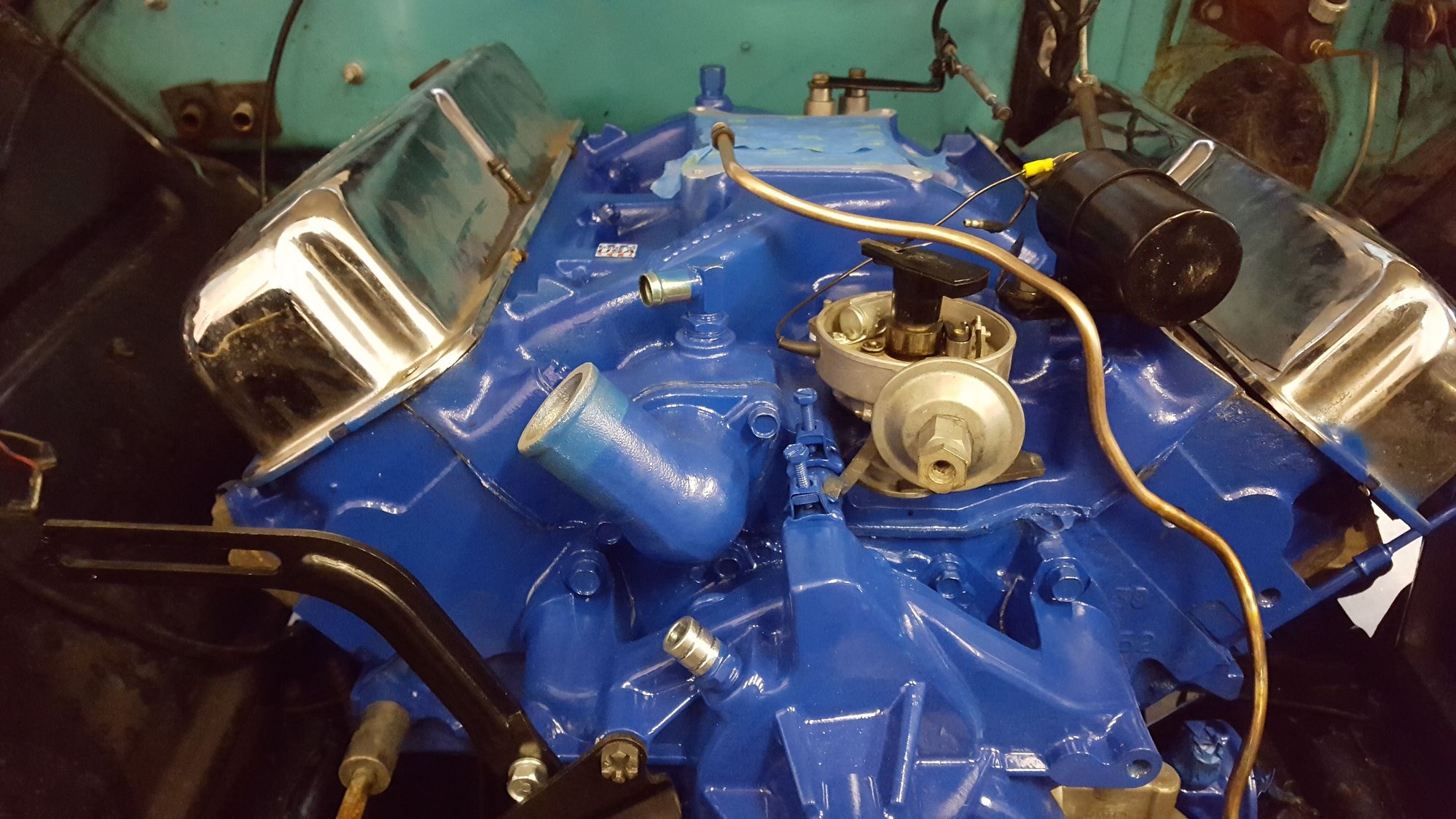

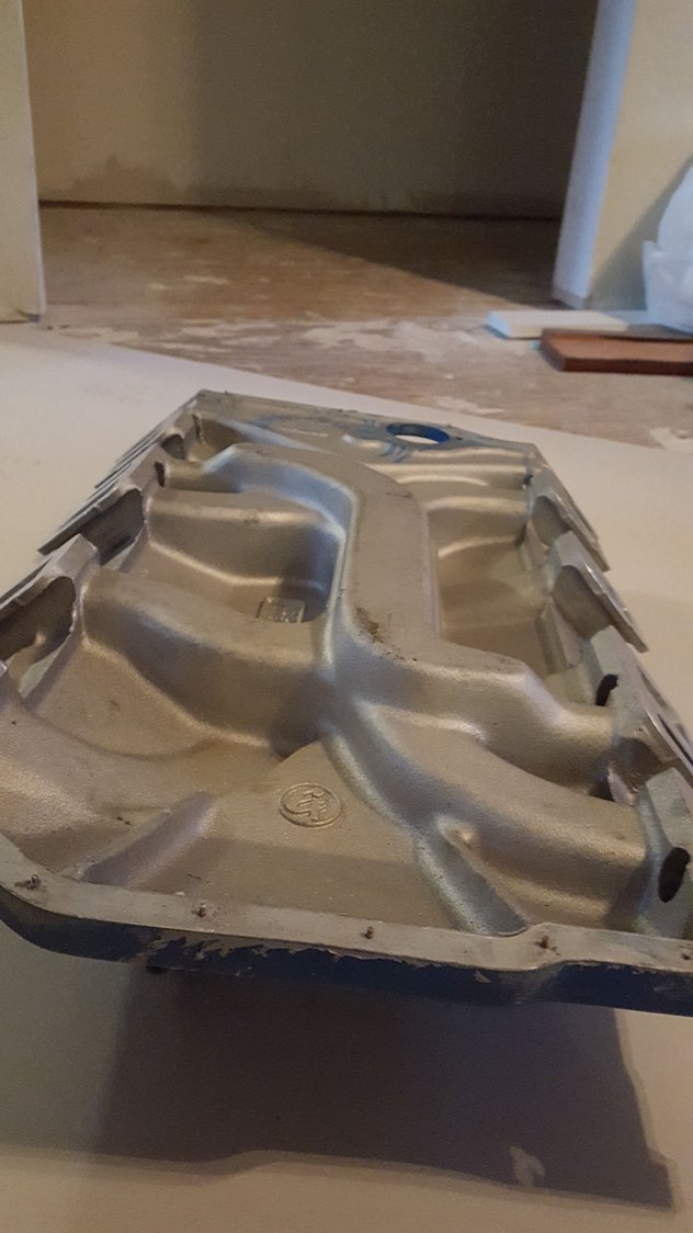

In order to prevent the rear intake gasket from squishing out again, I did a couple things 1) I let the cork end seals dry for several days using Right Stuff gasket adhesive. 2) Then I drilled several 1/16 holes on the underside of the intake and inserted welding wire into the holes leaving about an 1/8 inch sticking out to act as cleats that will stab into the cork holding it in place.
I had to make a couple modifications to the Edelbrock intake in order to work with the stock engine stuff, like the pin at the top of the front china wall. I had to drill and grind out a groove similar to the stock intake, and I also opened up the thermostat opening to allow the old style large thermostat.
Although there was nothing wrong with the old fuel pump, it was a replacement style AC unit, so I located a correct button top Carter remanufactured by AEM, Ford's licensed reman company in Farmer's Branch Texas. I painted the filter red just for contrast. I've seen an original in red with the same stamping as the white one available in reproduction but with white lettering against the red background.
The chrome valve covers are just temporary to keep dirt out. When everything else is done on the engine I'll put the repainted originals on.
Well that's it for now. It's 24F degrees outside and 4 inches of snow. My garage isn't heated, so I don't expect to make much progress until it warms up a bit.

Well I think I screwed up. While I was installing the valve springs on the driver's side, I noticed the lifter valley oil shield was curled up at the front and was right smack where the pushrods would need to be for cylinders 1, 2 5 and 6. Not good. I don't know if there's a way to correct it without removing the intake. That sucks.
I've built several 302s and 351Ws and even a Chevy I6. This is my first FE build. Most of the gotchas could be caught by careful observation, and perhaps this one should have been as well, but I missed it. Aaargh!
