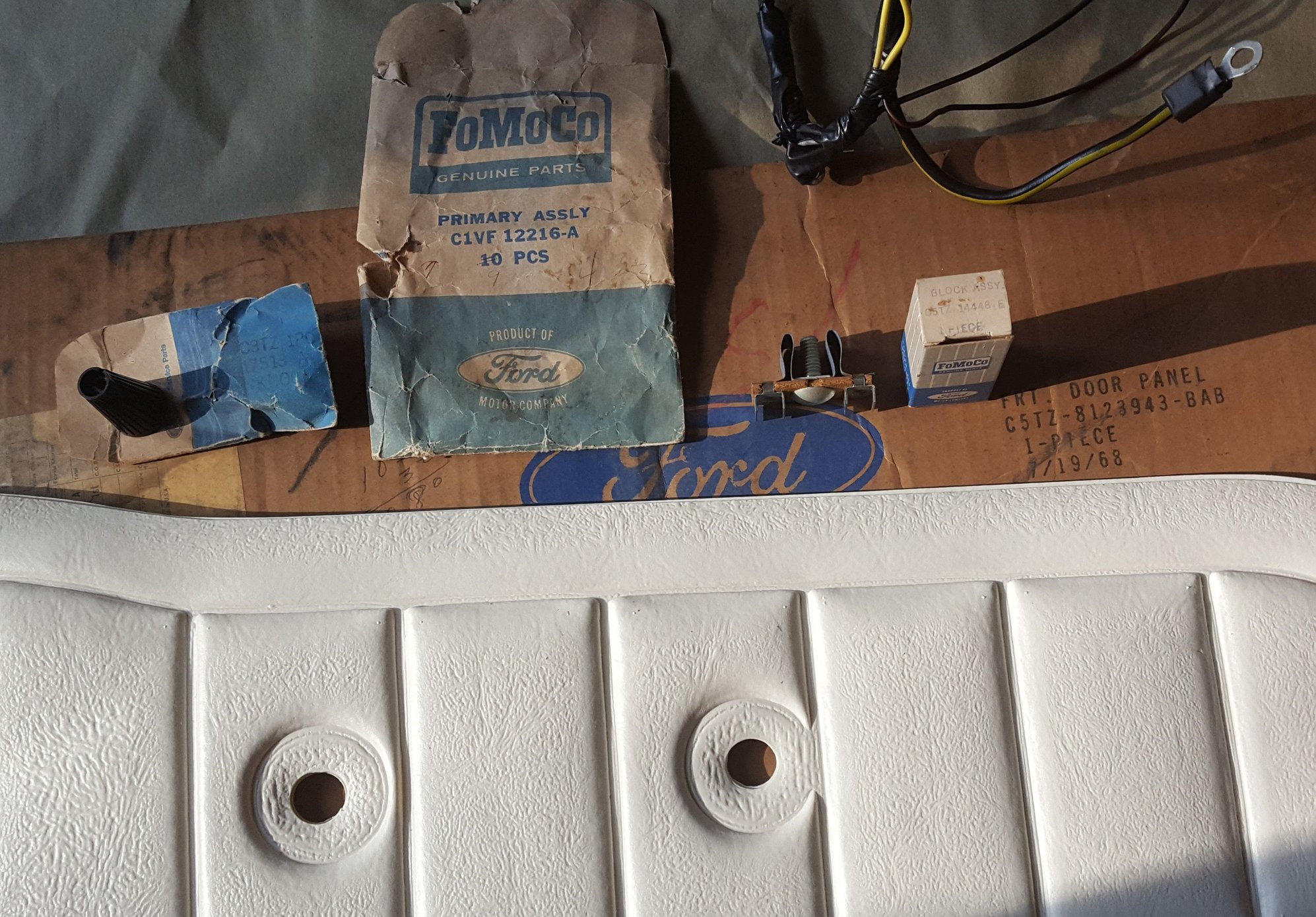

I picked up some more NOS parts and a couple of used parts that are small detail pieces that aren't available in reproduction.
I got 2 of the 'press to release' dash ***** for the w/w wipers and heater (only one pictured), a C1VF 12216-A primary wire, not pictured as it's already installed in the distributor, an NOS C5TZ 14448-E block assembly for the ammeter gauge junction, and a piece I had given up on finding NOS; the passenger side door panel. Still looking for an NOS driver's side. door panel. The B7AF 12216-A primary wire used on the 289 and available in reproduction is too short to reach the coil. I'm going to drive with points ignition for at least a year, probably 2, so I want the best parts I can get.
Not pictured are the used parts: the battery hold down tab (not delivered yet) and the coat hook. The coat hook could stand to be re-chromed, but I think I'll wait until I have a few more parts to be re-plated before sending it off. From what I can tell, it looks like there was only one coat hook that went on the lower passenger side headliner panel.
In the upper RH corner you can see a re-worked reproduction alternator harness. I found an NOS '66 big truck harness that wasn't a close enough match to use "as is", but I unwrapped it and took the ground and alternator output leads that are 8 gauge, and replaced the reproduction 10 gauge wires.

Larry, that looks like some truly great stuff. That junction block is too cool. I need one or two of those, too....Lol. Quite rare, there.
The door trim panel almost looks like it is missing a little of its grain texture, but that's not too uncommon or it might be the camera angle or flash, too.
I do have three of the LH drivers side, so one spare of those. I might even have the near perfect mate for that one. I think we'd talked about that before, though, and then I went into the hospital for that septic bursitis of the elbow thing that I had and I lost track of things a bit. Let me know if you want some pics of that.
