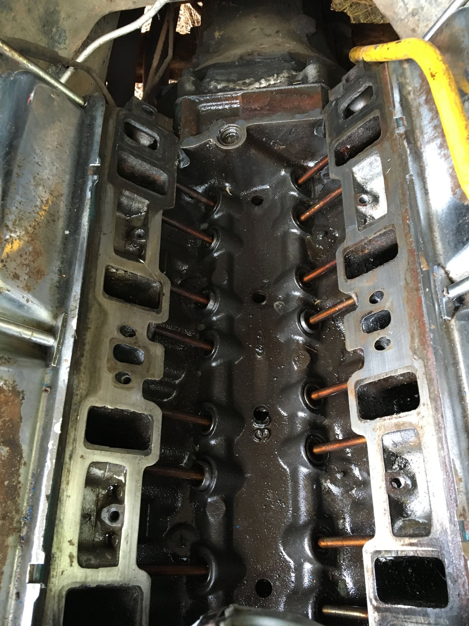

Since the PCV valve had so much grime, but the valley has very little sludge (besides the edges having a thin coat of black, there is none) could that SeaFoam I put in it and ran in it cleaned the pistons and put that into the PCV? Just a thought.
This would be another case where, if everything was operating properly, any residue displaced by the voodoo additive would be distributed throughout the engine and would show up on both sides. It showing up on one side only is the issue.
The intake stream contains vacuum, leading from the top of the opening (carburetor) to the valves in the heads. It is conceivably possible the intake valves on that side are leaking badly, and each compression stroke pushes stuff up and out of the combustion chamber and into the intake manifold. But the engine would run like crap so I don't think that's your problem.
In my mind, this involves the PCV system and/or the EGR supply channel (that delivers a small amount of exhaust gases back into the combustion chambers) on that one side.

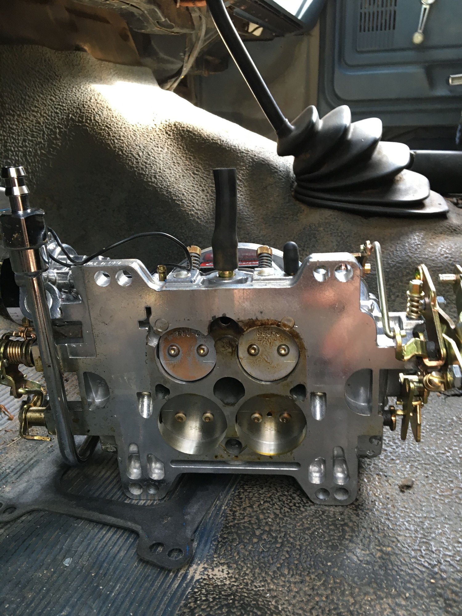

I also wonder about one plane and not the other, that has me curious!
Sure would like to see the bottom of the carb. from the rear forward and not real close, just back enough to see the WHOLE carb. hint hint hint ...

The valve covers did get turned upside down. I will take a pic of the carbs. I sure love my zoom!

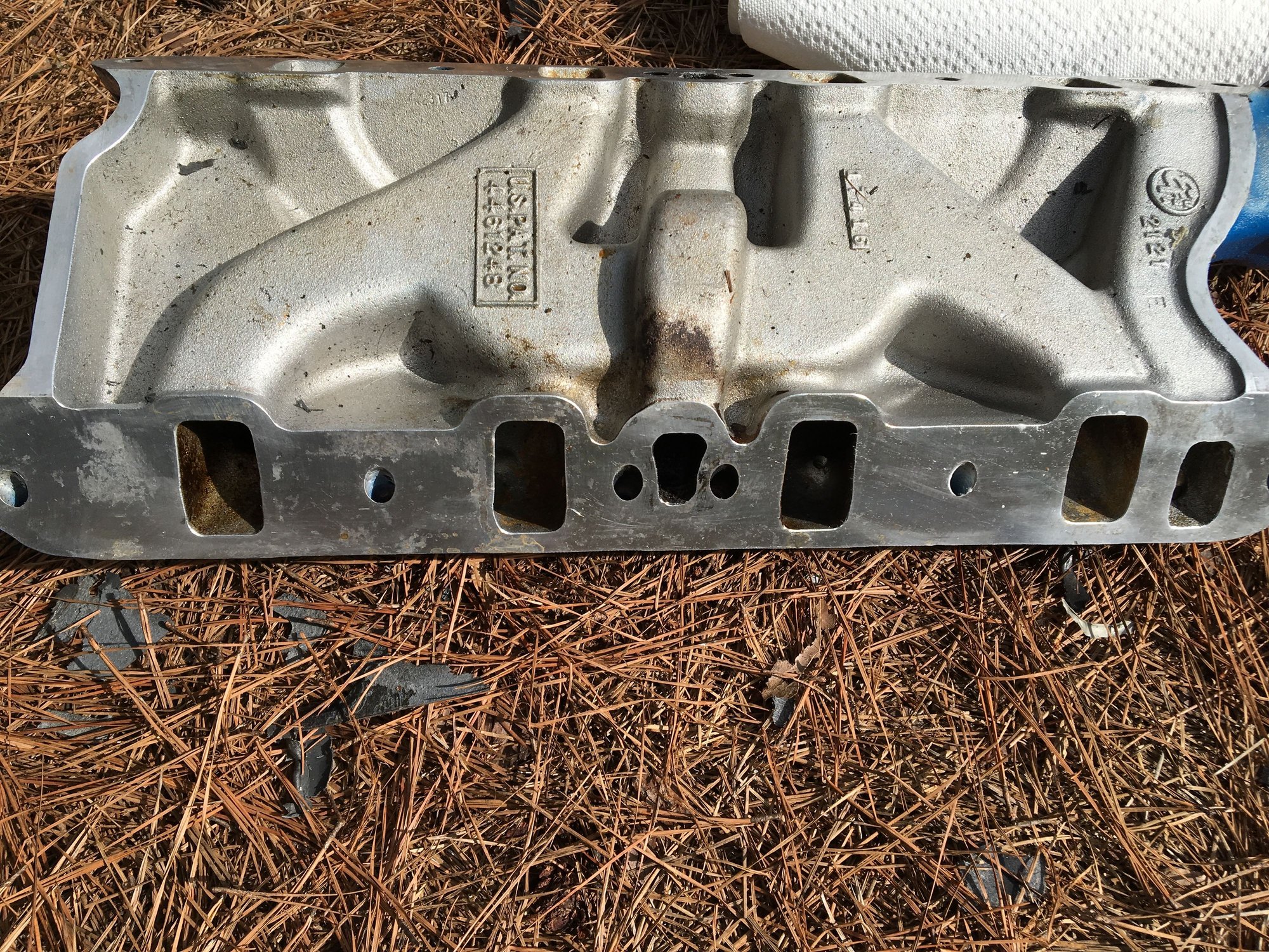

I cleaned with steel wool and brake cleaner and gasket remover. I guess what is left is some Gaskacinch or something. I cannot seem to get it off without scratching it.
Here is a close up for ya'.

Oh, and you can see in the pic of the valley that it is not gunned up. I rubber my finger in the center and it turned my finger black like used oil, but it was not thick or sticky.
