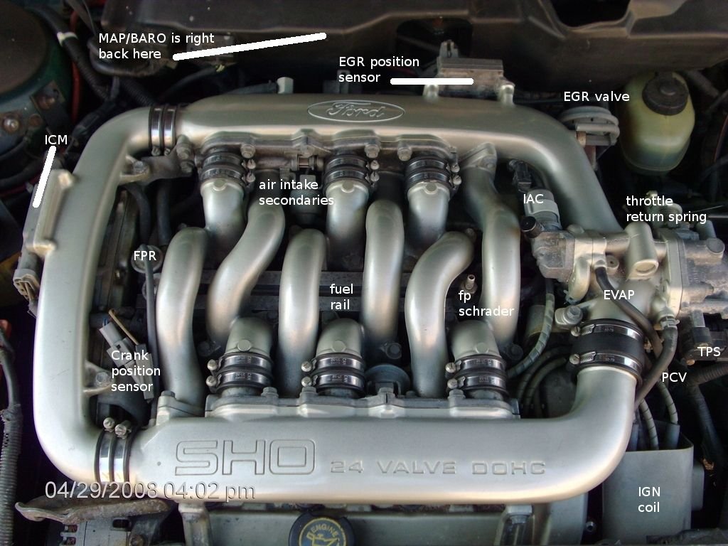

What's the error? Test pic uploaded here... I merely clicked the mountain & sun icon, chose some random image on the computer, and inserted it into this post... did this from a laptop running 'doze 10 & Firefox.
