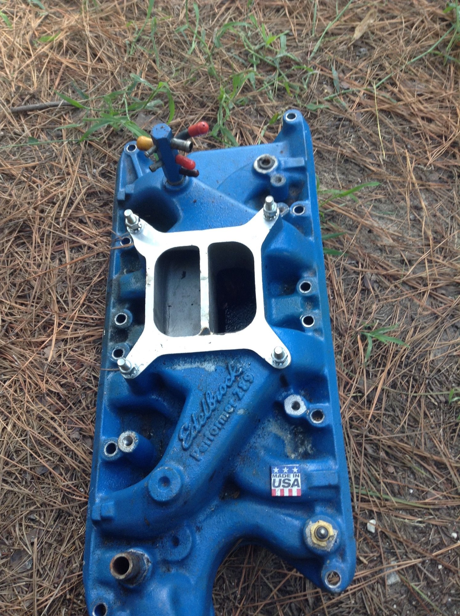

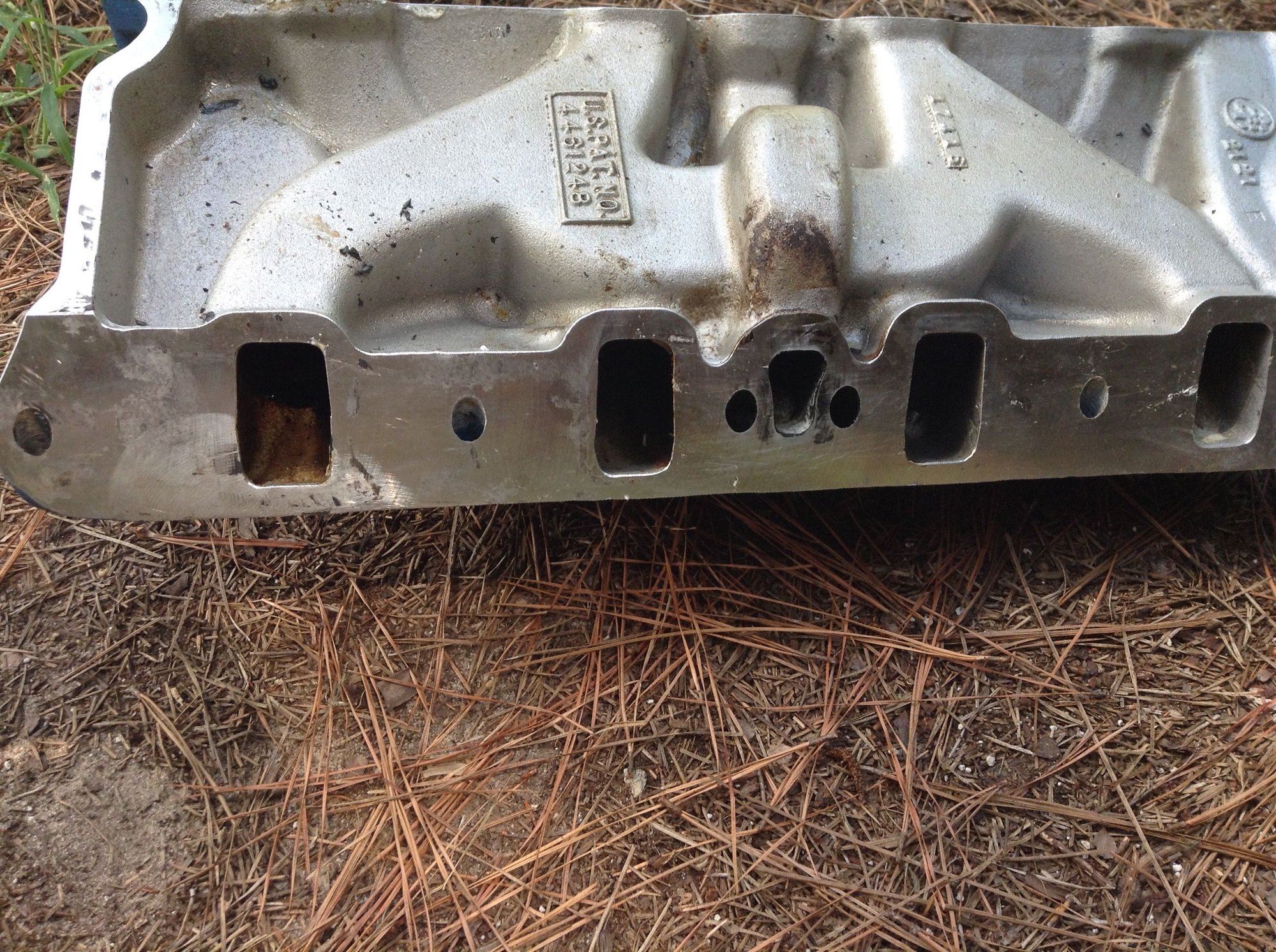

It doesn't look like the RTV in your 1st picture post #64 was near high enough to seal to the intake.
You need a TALL solid bead at each end.
I think all that sludge in one part of your intake is explanation enough for smokey exhaust (yes, I know it's a dual plane)
Looks very dirty.
Is that transmission fluid, rather than oil? (Maybe a blown modulator?)
It's very hard for me to visualize everything when all I have is a closeup on a phone screen.

I can take some more pics further out than you like. The PCV valve was plugged into the lower center of the front of the carb. It is the same one that has been on there for a long time (at least for 15-20 years) so it easily could have come from there. It could also be a blown modulator. How would I check for that? The #1, 4, 5, and 8 were clean (8 had some of the sludge, but was not as bad as the others).
Brand new carb so I think it should be working properly.

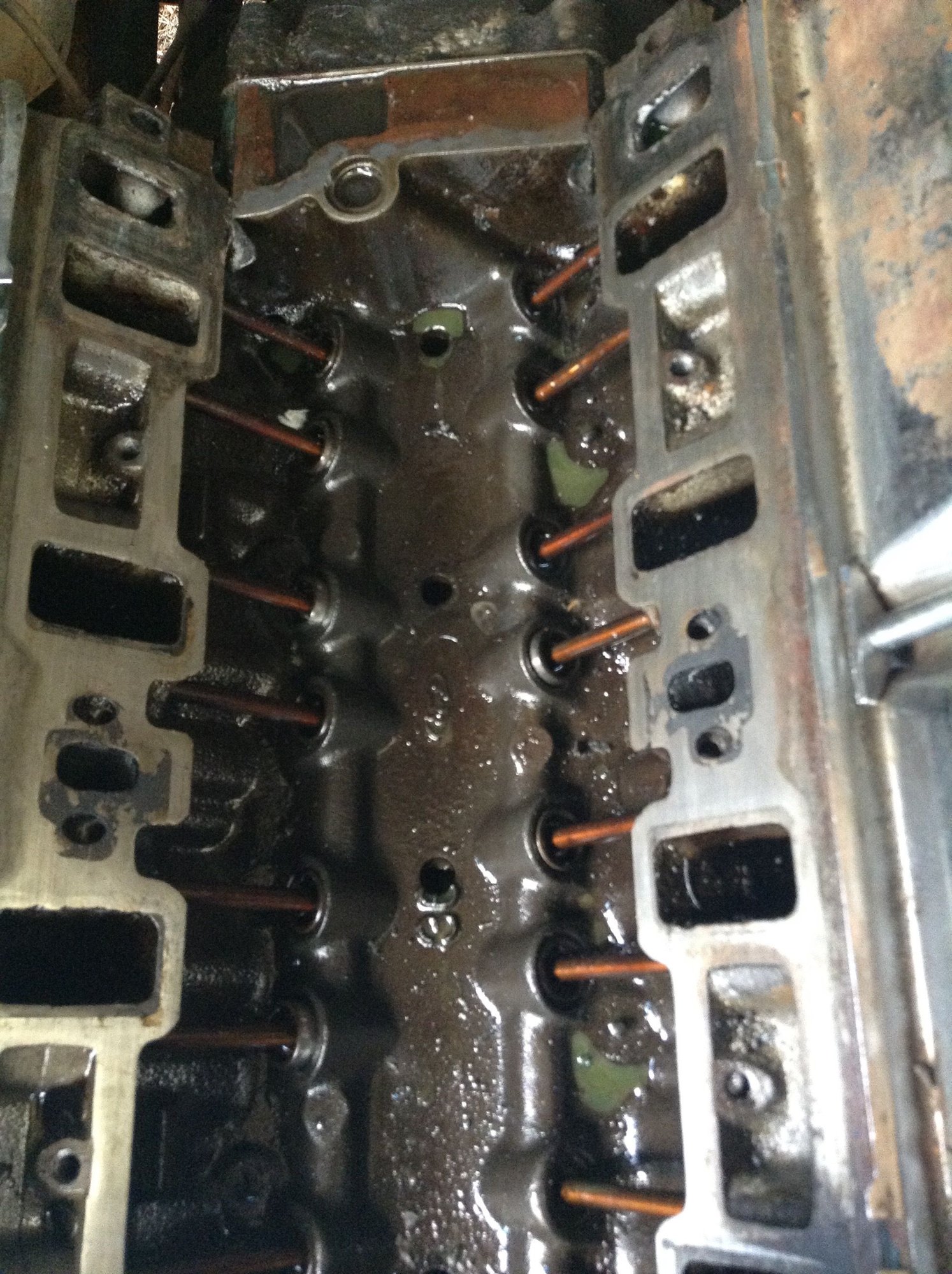

I cleaned both parts with a razor blade. May need a little more cleaning, but the razor blade slid over smoothly. I even used some gasket remover ( I have to repaint anyway. Fuel line sprayed when I disconnected it and the paint bubbled. Not sure why engine enamel paint is not gas resistant.) Here are some pics of it from a little more distance. The pic with the carb in it has a rubber tube where the PCV valve goes onto it. I have to get the shop vac in the valley to get out any gasket or coolant that fell in as well.

You really don't need the PCV or Transmission Modulator valve hooked up to just run the motor ...
So, maybe it would be a good idea to plug the vacuum ports they plug into and leave them unhooked until the motor is up and running.
Just a thought!
Of course they need to be hooked up to do the final tune up adjustments.
And at least the modulator hooked up for a test drive.

Use some steel wool to clean the heads and block, get all that RTV off to shiny metal.
You really should lay tissues (paper towels work) in the valley to catch debris.
Just don't forget to remove them!
Does any of the vacuum lines connected to the carburetor or intake have oil in them?
