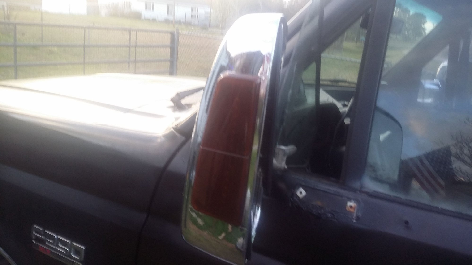

One mirror installed, about 1/2 way done with wiring harness build.
Once my Internet stops acting stupid I up load photo

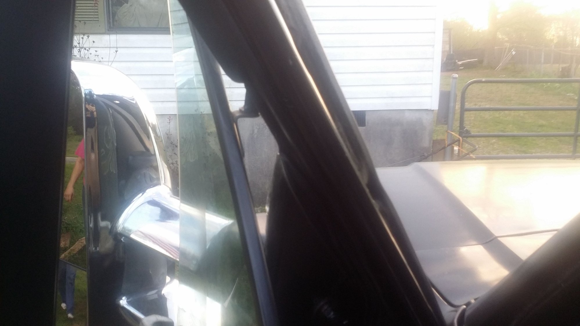

Show some more pics of the install of those GM mirrors...mounting location, etc.

Here is the orginal thread
https://www.ford-trucks.com/forums/1...-complete.html
My parts list remember had straight manual mirrors.
Mirrors
http://www.ebay.com/itm/391366875308?_trksid=p2057872.m2749.l2649&ssPageName=STRK%3AMEBIDX%3AIT
Defrost switch. A toggle switch will work. This switch
http://www.ebay.com/itm/131724167722?_trksid=p2057872.m2749.l2649&ssPageName=STRK%3AMEBIDX%3AIT
I used a mirror switch for an 07 SD because it had fold . I order it before mirrors came in.
7 different color 16 gauge wire 15 ft of each enough to build both lt and rt harnesses.
3/16 steel rivets
Tech info
http://i13.photobucket.com/albums/a2...ce/passen2.jpg
http://cimg2.ibsrv.net/gimg/www.ford...05a44f069f.jpg
http://www.wiringdiagrams21.com/wp-c...it-diagram.png
Notes
I only had a hammer and vise grips to bend metal. I should have made the tabs longer.
