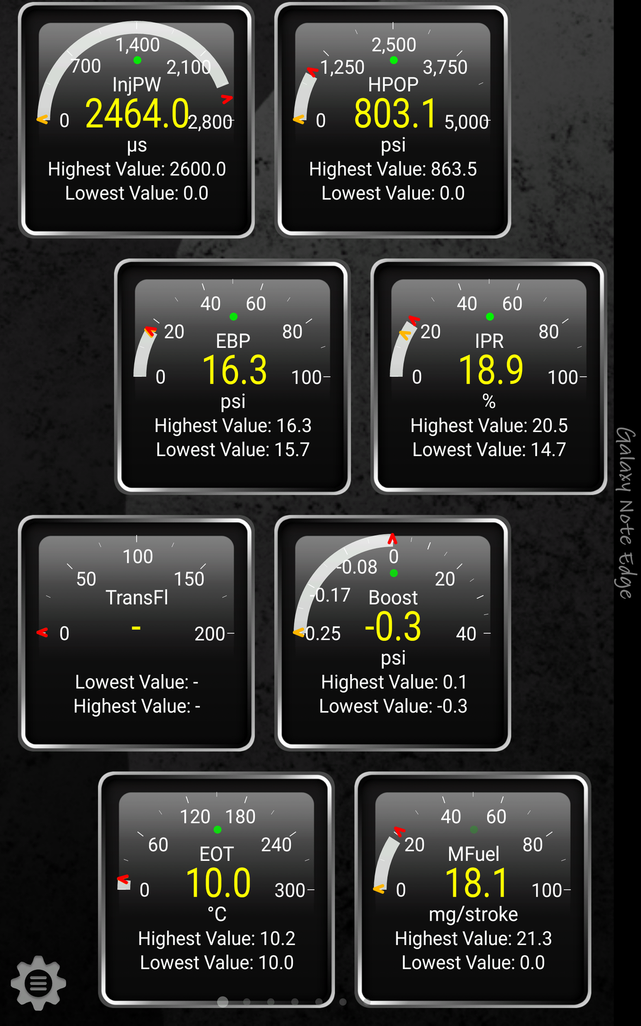

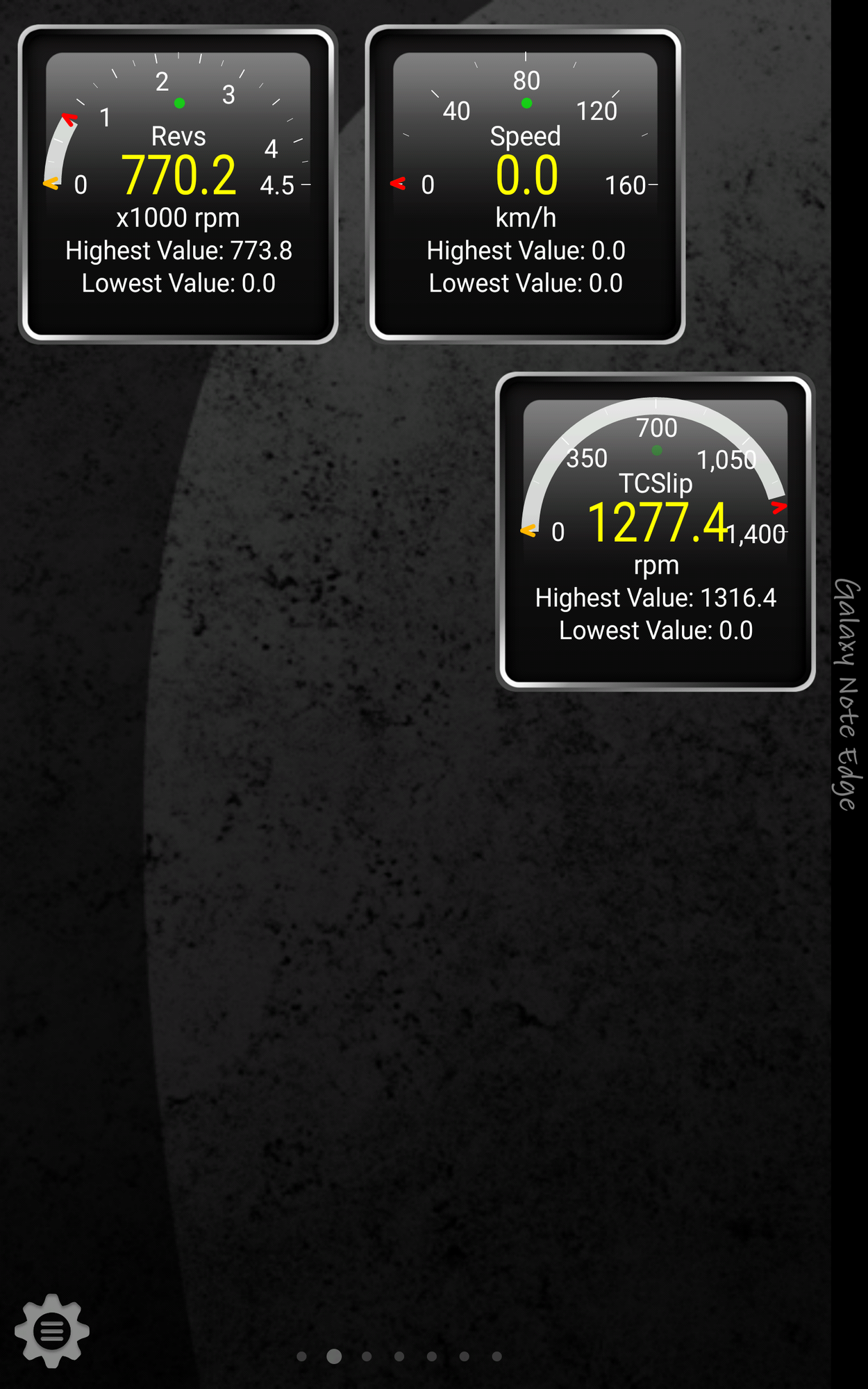

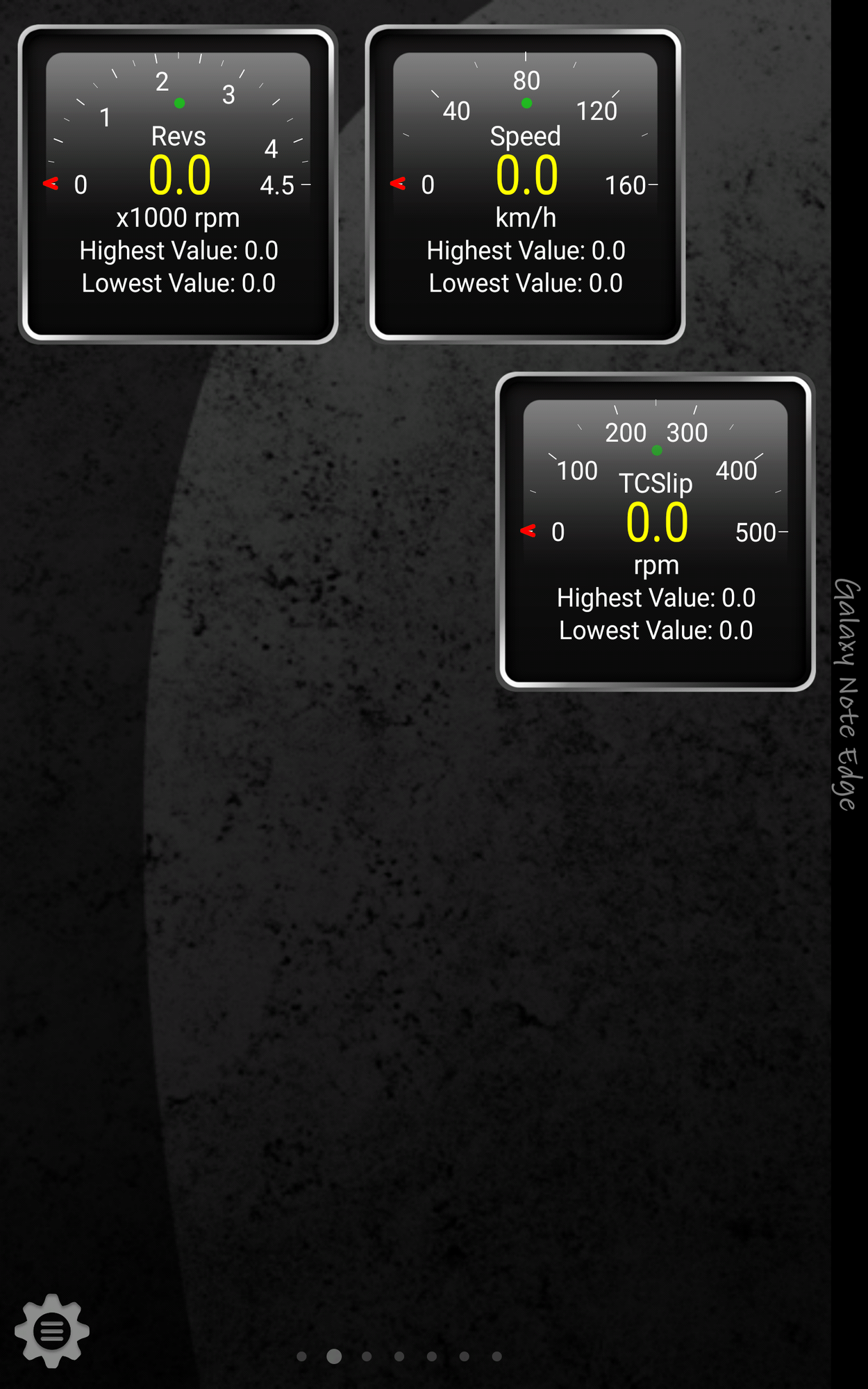

As requested. Interesting to see some gauges show values with KOEO.
KOEO1
KOEO2
KOER1
KOER2

Boost and back pressure look about right for altitude if you are in IL. Oil temp says engine is not up to operating temp yet at time of reading - EBPV (assuming e99 has one) may be slightly closed, should open fully when warmed up. Might want to check that.
Note that your mechanical boost gauge will read MAP, and Torque reads MAP - BAROMETER.
Others might comment on HPOP, IPR, and FIPW.
