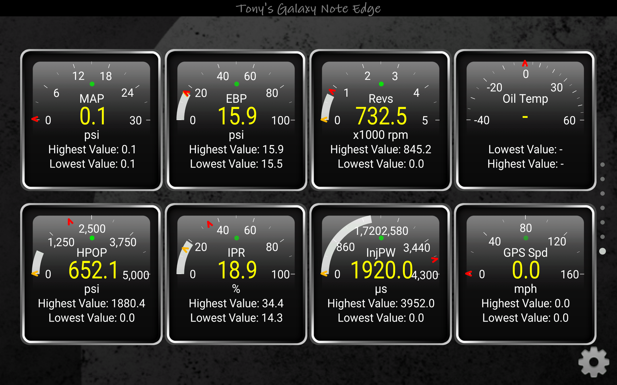

ok, time to get this thread rolling again. I've just completed R&R on engine including pedestal O-Rings, injector O-Rings, Injector cups, glow plugs, VC gaskets, 50 cent mod, UVCH, and a good general cleaning.
I logged with TP on my way to work today, but the output files don't look right to me. I can only open the .csv format in excel so I can't actually see whats in the .kml output.
I took a few screen shots too. First one is KOEO, second is cold idle, and third is warm idle.
I noticed oil temp isn't reading...should it be or do I need an aftermarket sensor for that?
Anything else I should add to the dashboard?
I noticed half way to work I was still on my hot tune, so should I redo this logging on the stock tune?

ok, tried logging again with the monitored items added and GPS info removed. Interesting the log shows engine oil temp but the gauge in TP doesn't. Some stuff still looks off too, like the MAP reading never showing any boost, though the gauge in TP and my pillar gauge both show the same within ~2 psi.
The engine oil temp settings and log are attached.

The MAP reads more like BARO with a few small hills. The ICP is absolutely dismal. FIPW looks right for a stock tune (assuming the formula is correct), IPR looks right, and the TCLU looks right, but your HPOP is either near dead, or you are losing oil internally. If there are no external oil leaks - you are a prime candidate for a Cody test before considering logging on to Riffraff Diesel for a T500.
This truck is anemic - you should get 2800 PSI max at 40% IPR at those RPMs.
