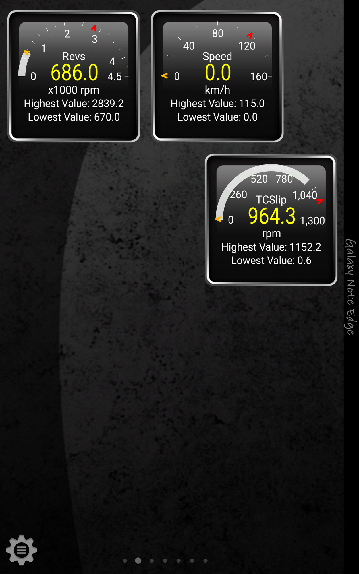

For some reason I had to create the BARO PID from scratch, I think it's working correctly. So far these are the best results I've gotten. I need to try the other trans temp PIDs to see if any of them work, but at least I'm getting realistic values on the rest of the gauges. I noticed the TP Boost gauge and my analog gauge are within 1-2psi so that's good.

KOEO readings please - the max and min engine running give no clue as to whether we have calibrated output.
KOEO and then KOER at idle will be a start.

12 lbs boost between 1000 and 3100 RPM with 18 to 39 PSI EBP seems very strange!
Your TPD is varying from 6 to 28 PSI.
Check EBP and Boost by Ford manual.
