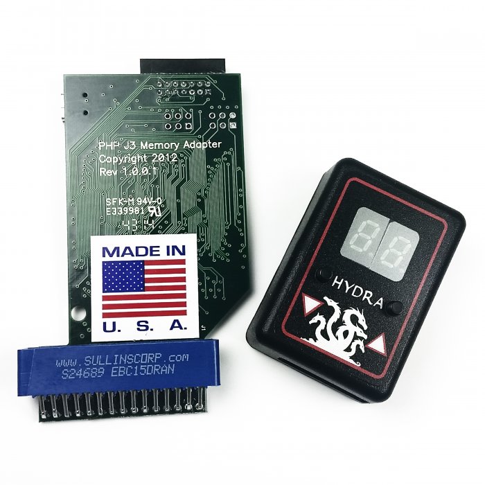

Yes, with good tunes, you will use every bit of fuel potential you have in AB injectors with a stock 15* HPOP.
Could you pick up 5hp... Sure... Maybe. Same thing you would get with just a simple 17* swap from a L99+... If your not going over 50% duty cycle, your pump is providing all the HPO your injectors need.
The Hydra is the best hardware on the market for the 7.3... Period. If you look around at sigs on this page, better then half run the Hydra now. Lots and lots of former users of the other brands have switched to the Hydra.
As I said before, Hydra comes with a built in No Start. It comes with a Built in Stock. It has 15 programmable shift on the fly spots left for you to fill. It comes with unlimited, free, all you can eat access to all of Power Hungry Performances Library of tunes... Free, forever.
Most vendors provide a free extension cable, so when you want to change or load a tune, you don't even have to pull the chip. Just plug it in to your computer, and install a new tune.
Want to try a Gearhead tune... Go for it, call up Gearhead, ask Matt to send you a tune, few minutes later its in your email, you load it up and enjoy.
What about Tony Wildman you say... Well, call him up, have him email you a tune.
Now there is that pesky Powerstruck guy, want to try his tunes, go for it... Same process...
Now...
Call up any one of those, or any other tuner... Ask if they can (or want to) put there tunes on a DP chip...
Aww man, your stuck.
Remember... Most of the guys that will tell you to run product X... have only run product X. There going to tell you its the best, bestest, suooper cool... Because they dont know any better.
Lets not forget about the Cyclops app for the Hydra...
Now you have no dash switch, but change tunes via your phone...
(also compatible with TS chips... and the "other" brand)
