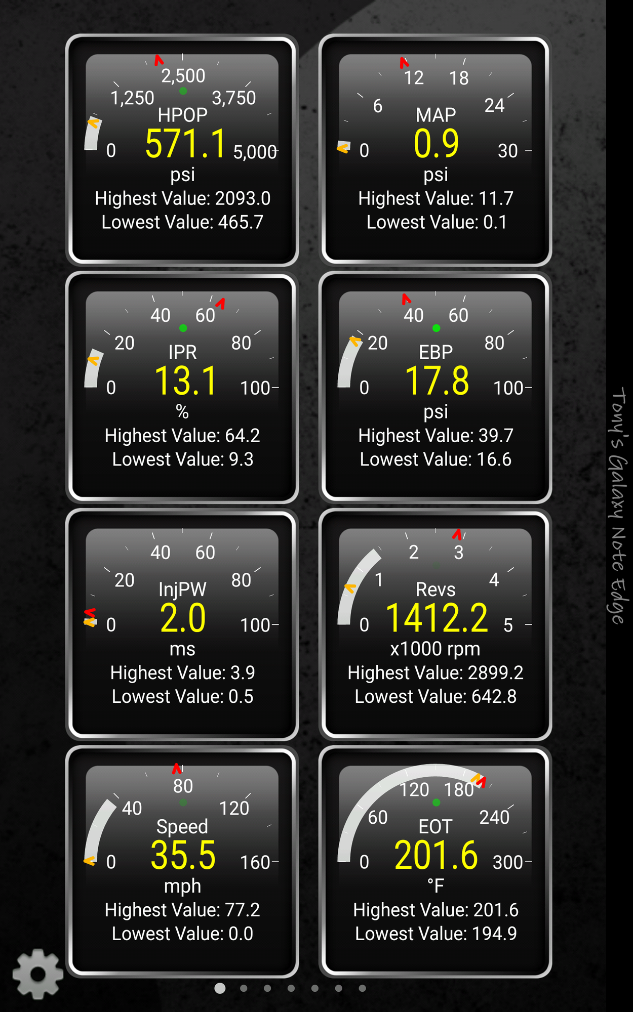

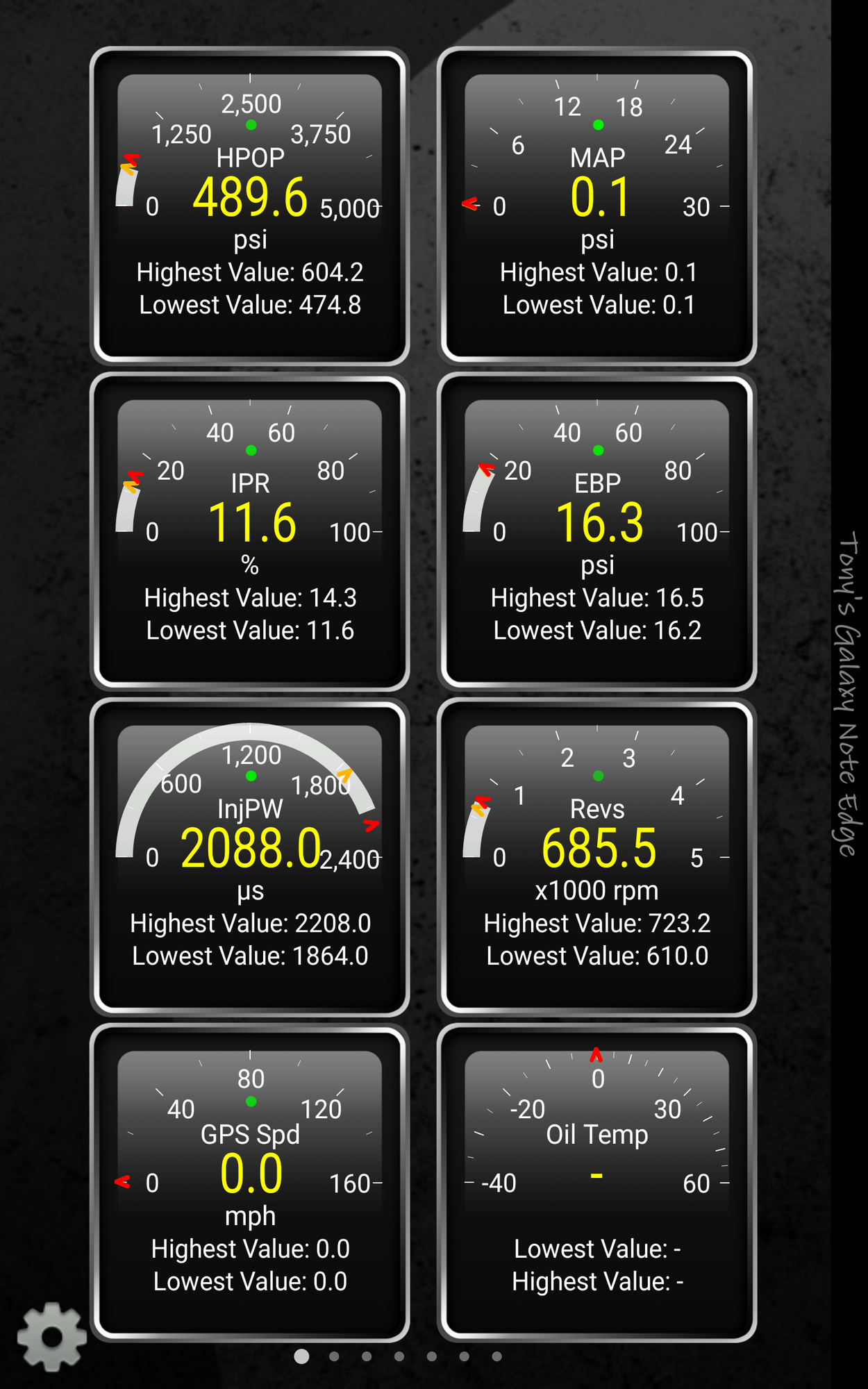

Had to run into town so I put it on stock tune and grabbed a quick log. Got in a WOT pull to 50ish, and something is definitely wrong. Struggled to make 10psi and was a DOG. HPOP maxed out at under 700...
This was AFTER the WOT pull...

If I'm reading that CSV log correctly the max IPR is a yawn inspiring 30%. Did you log some WOT in there? Getting a solid 2200 PSI out of that, but duty cycle on the IPR should be greater. Have you checked the usual ICP sensor and IPR issues? Wet with oil, tin nut snug, etc? Engine looks cold, EOT starts at 103* ends at 166* 7 minutes later. PCM might be limiting the DC due to that.

yes, there was WOT in there. It felt about as yawn inspiring as it looks in the log. I haven't checked any sensors. Even after the truck fully warmed up it behaved the same. Whats odd to me is when I put it back on the hot tune it feels like it runs so much better.

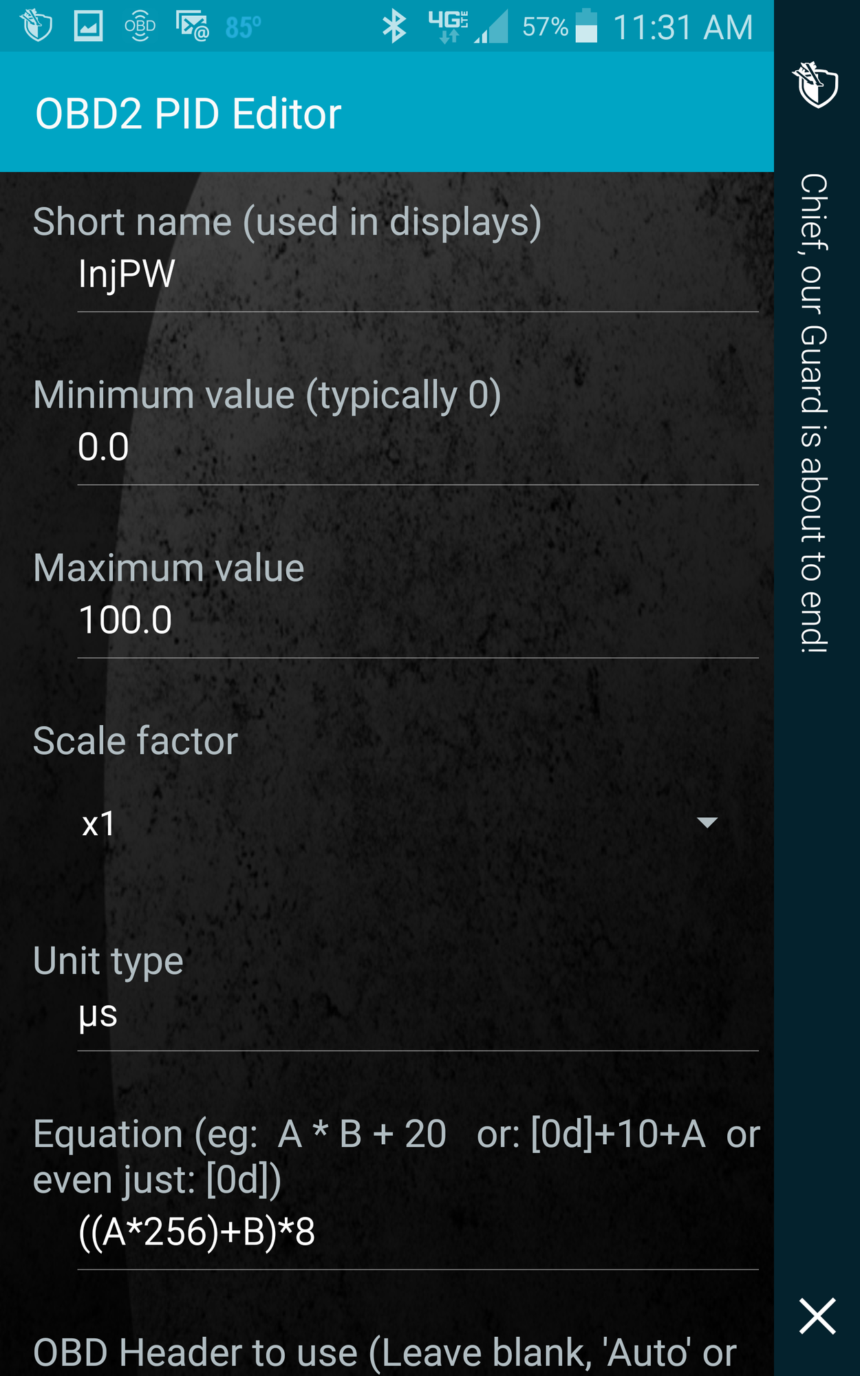

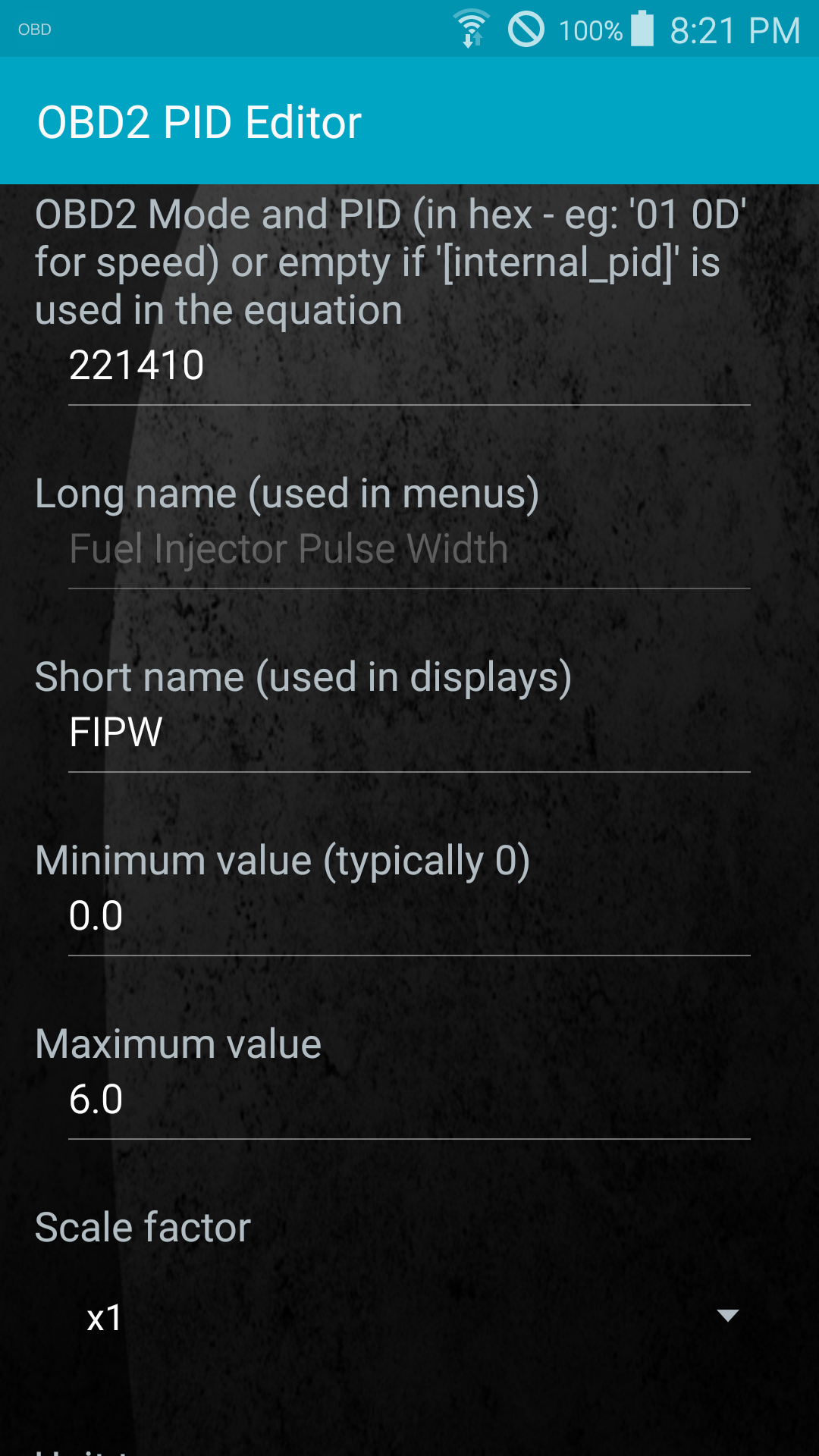

Originally Posted by akorcovelos
Here it is. I haven't messed with the formulas so these are as delivered in the Powerstroke PID pack.
I think your equation is wrong for FIPW. I found this problem a couple of weeks ago troubleshooting my problem. Below is the PID I used for FIPW.
It should be *.008.
I had some funky readings until I found several errors in the PIDS.
Mike

Thanks, I edited the PID to match yours. I'll pull a better log tomorrow on my way to work in stock tune.
What other errors did you find? I'd like to be using known good formulas.

Either of those FIPW formulas work fine - they just change the scales between milliseconds and microseconds. 2400 microseconds equals 2.4 milliseconds.
You want this [LINK]
Now I want to see the throttle position sensor, knowing that the IPR and FIPW were so low on a tune. Unless the chip does a bunch of trickery on the sensor inputs, those numbers should be more like 3000 microseconds for the FIPW and the IPR should reach for 3000 PSI ICP. It won't make it, but it should reach for it.
