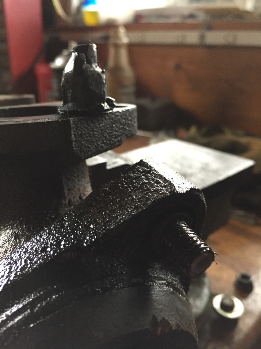

Went out to the shop this morning with great intentions or removing a broken exhaust stud. After attempting three different things, I broke it shorter. Any good ideas?

All I can think of is letting it soak in good penetrating oil overnight, and then heat.

I don't envy you, if you have a torch that is able to make it cherry red would be best I think, I ended up breaking the ear off one of my manifolds and had to make a trip to the wreckers..

Soaked in "Fluid Film" or "PB Blaster" for at least 24 hours and if that doesn't work, heat to red hot. If that and easy outs fail to work, you may have to drill it out and then use a HeliCoil Thread Repair Kits.
Howdy Luke
Lots of good advice on here for you.
The only other thing you might do is weld a nut to that broken stud. That will give you a better grip than pliers or vice grips. Doing that will also expand the stud a little. That might be enough to brake things loose, but be sure to wait until the nut/weld cools down before trying it. If that doesn't do it, then heat the manifold and it should screw right out. Worse case and you ruin the threads it looks like there might be room to use a bolt and nut to get you going.
