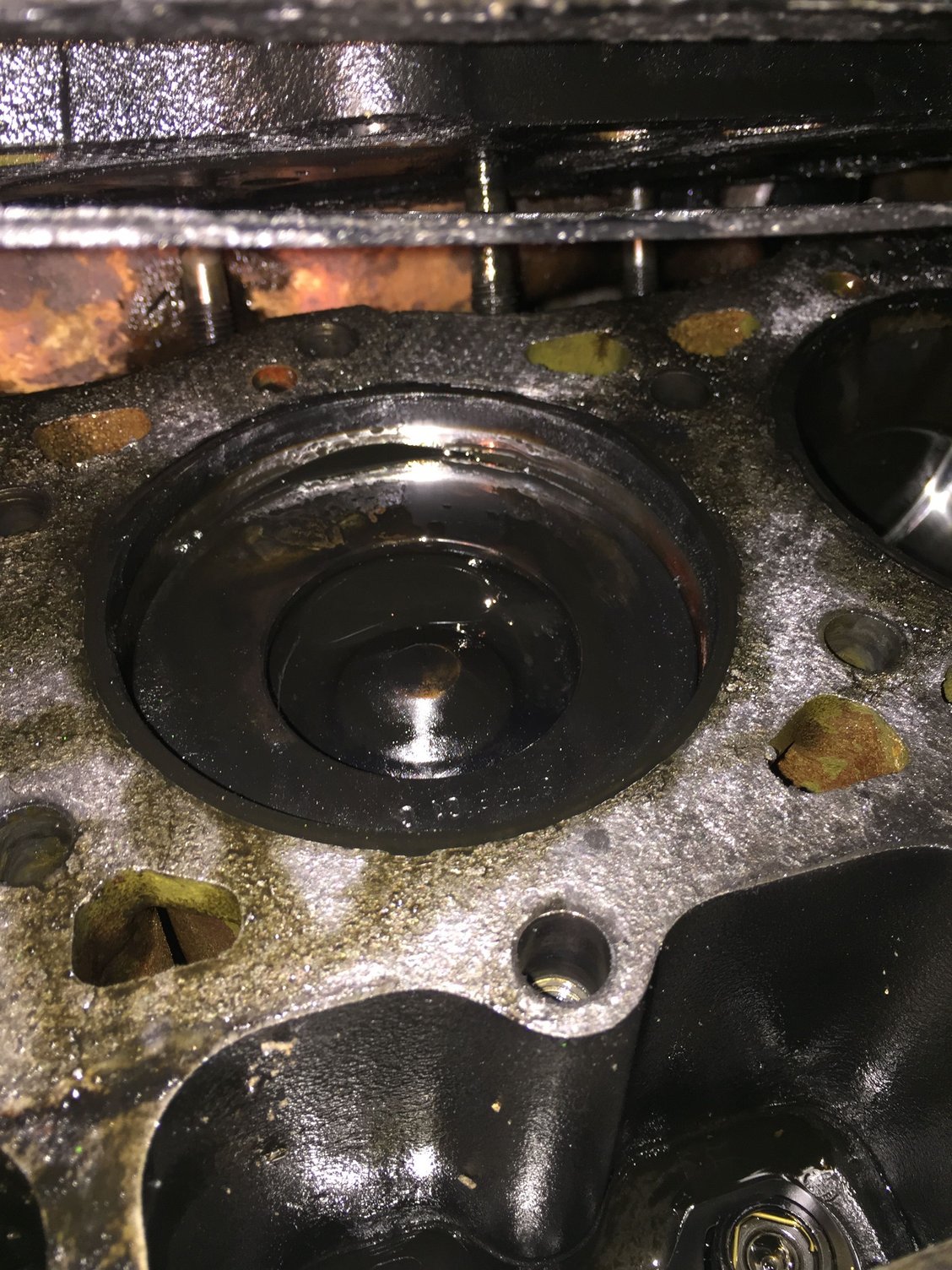

I have a late 99 7.3 that developed a knocking noise. I pulled the passenger head and cylinder 5&7 have a spot where it looks like it came in contact with the valve. I'm not some master mechanic but am learning. What would be my next step to find why it hit the valve and to fix the problem? Thanks

Sorry but with the oil/carbon on the crown of the piston it is hard to tell. If you wipe off the stuff it will be very visible. A physical contact of any sort will be seen on the valve and in the piston weather you clean them or not. A kiss/mashing will be present. Wipe and look, if you then cant find post a pic.

Well another thing to look for is a hole that has rally bad scuffing on the side. Prolly a good sign that has a broken skirt and or rings.

What are we looking at? The area of the piston next to the cylinder wall at the 12 o'clock position?

Just my luck. The truck only has 148k miles. Yeah it's about 11-12oclock. I will clean tonight and take more pictures it got too late last night.
Is that uphill? or to the exhaust manifold?

Posts: 148
That's exhaust manifold side

If the picture of the piston is showing the top of the piston, it does not line up with the valves. Look at your head, the valves are on the sides (front and rear) of the piston.

Oh alright thanks! What the hell could that be then..?

As for valve to piston contact, the most likely culprit is coking on the valves or valve stems. We see this on engines that have seen lots of idle time. These engines often eat pushrods and that is what leads to teardown.
